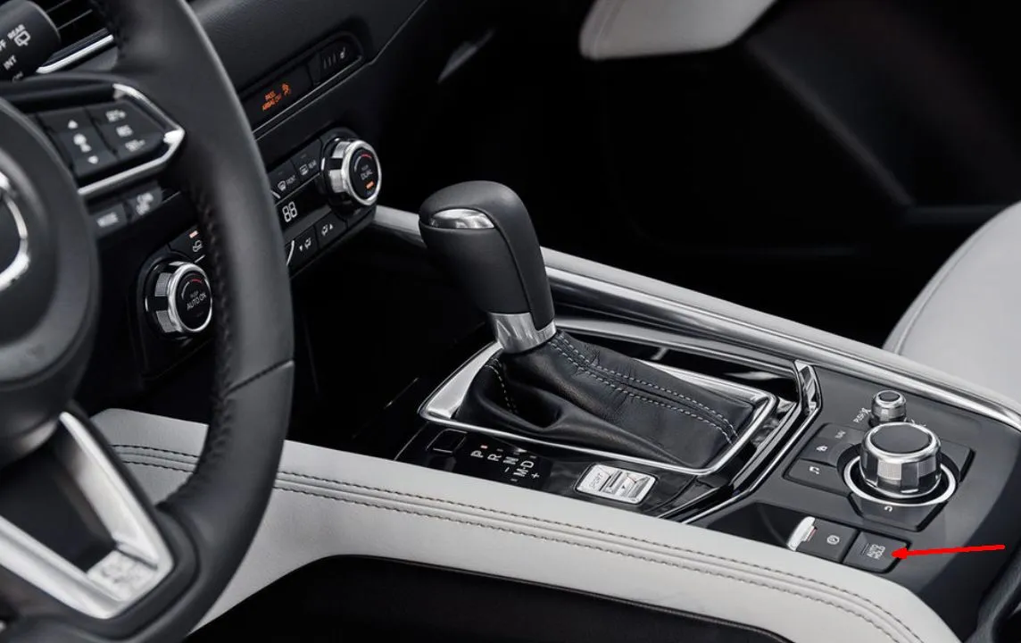

yrwei52 called it, that space right below the e-brake will be for auto hold, 2017 CX-5 will have auto-hold feature for stop and go traffic,
2017 CX-9 should follow suit also as an available option
