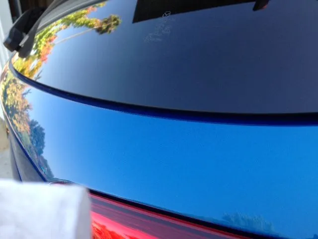

I don't have a 2017, but from what you're describing it sounds like the "weatherstrip" has been added as an aero aid in order to smooth airflow over that part of the hatch. The gen I cars have an open gap at the bottom of the rear window which, when I wash mine, I blow the water out of with a can of compressed air. Otherwise, the remaining water drips down the hatch when I move the car. In either case, water cannot migrate to the inside of the hatch because the glass is bonded to the perimeter of the window frame with sealant. So your only concern might be water that collects behind the non-bonded rubber strip and remaining there for a time after you wash the car. BTW, a picture helps in this type of discussion.
Picture coming when my wife gets back with the car....
The way they were...
Here is the location of the weatherstrip that allows moisture beneath itself.
Like I said, they either did it for aero (same reason they now have outer (3rd) door seals) or to give the rear a more finished "premium" look. The old design (see my pic above) could be perceived as having a bit of an unfinished look. I wouldn't worry about it.
Thanks for posting, paris. Although he didn't point out the area of concern in particular I can see that this does/will cover a seam that may have one time caused some wind noise. I just wish moisture wouldn't seep beneath it.
