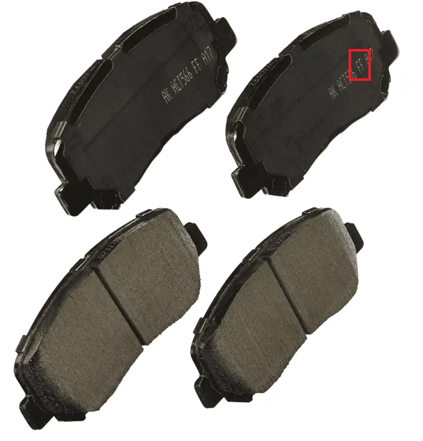

https://www.amazon.com (commissions earned): Appear to be "FF" rated.

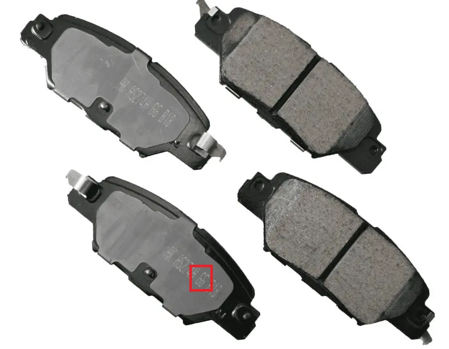

Akebono ACT 1846 (Rear): Appear to be "GG" rated
