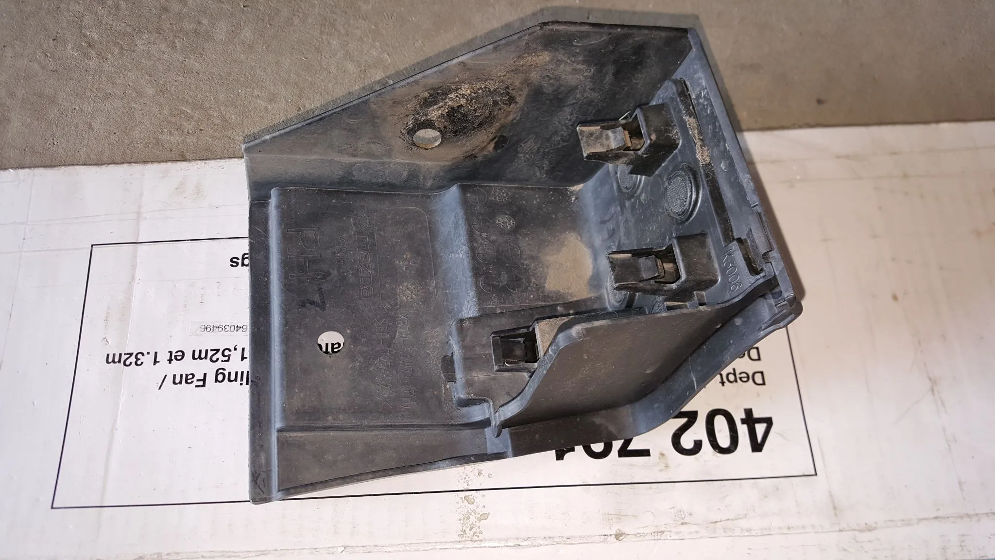

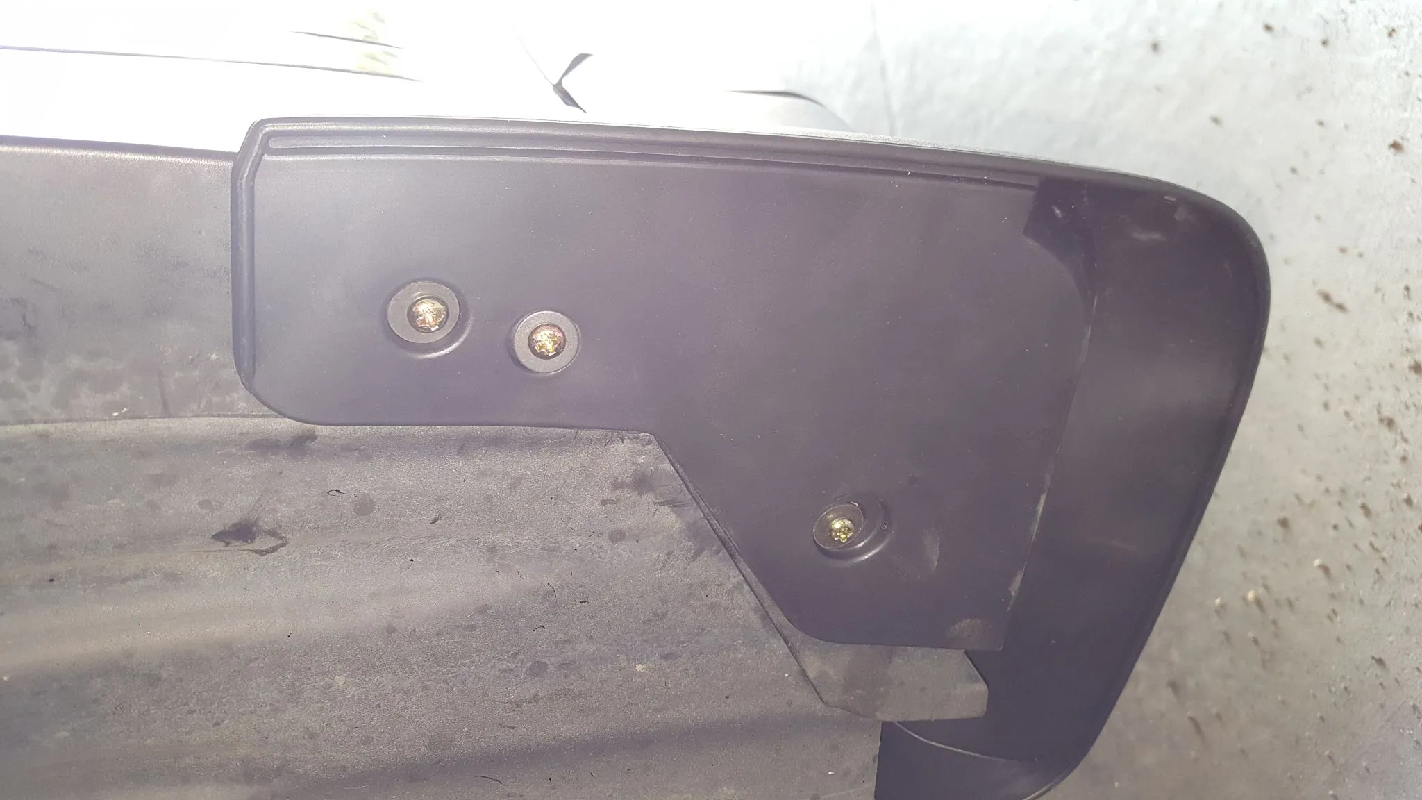

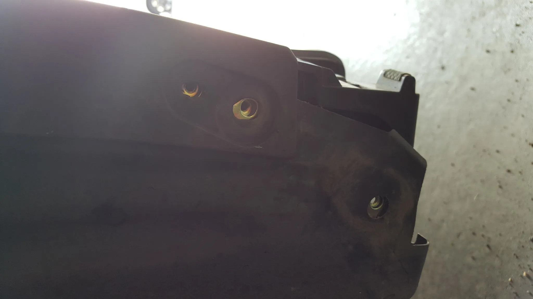

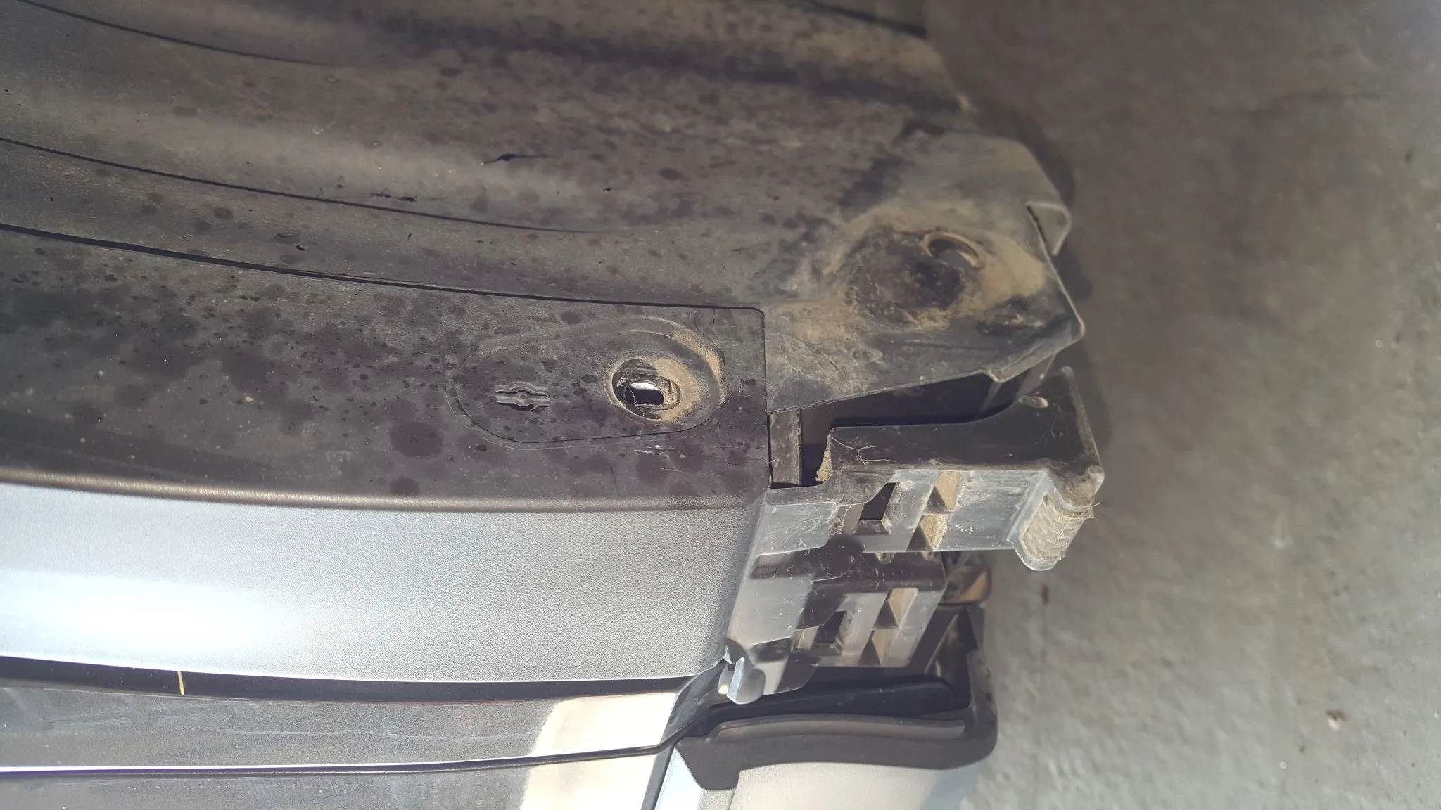

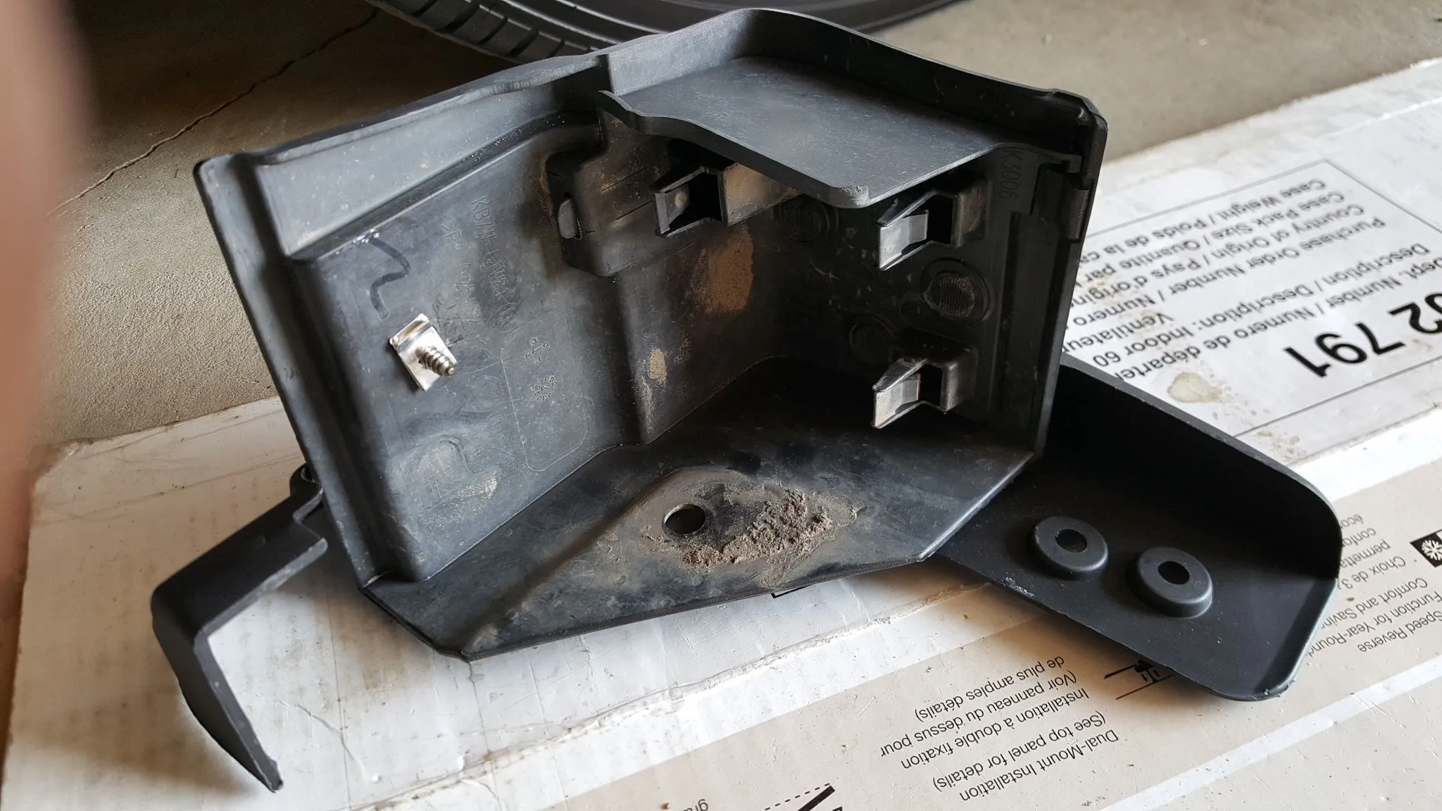

Some additional photos of my install yesterday
I installed a set of guards that I purchased from AliExpress, $33 each.
I had to order two because first set one guard was damaged.
I attached the guard to the lower corner piece first and that is shown in the first photo with the insert on the back side, if I didn't install it first there was no way to hold the insert as I tightened screw from the underside.
