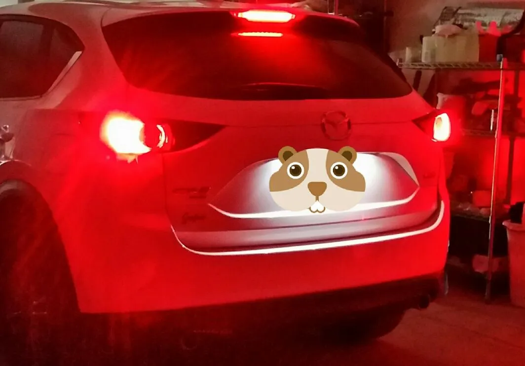

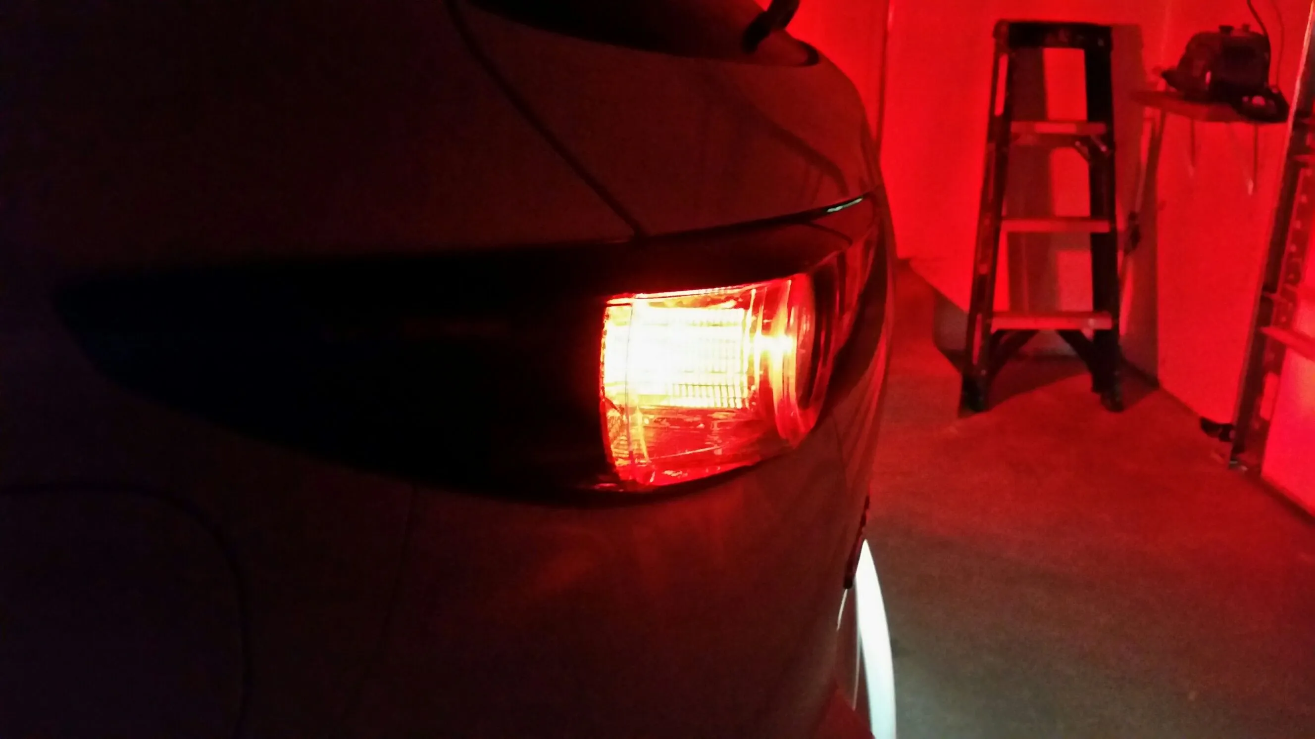

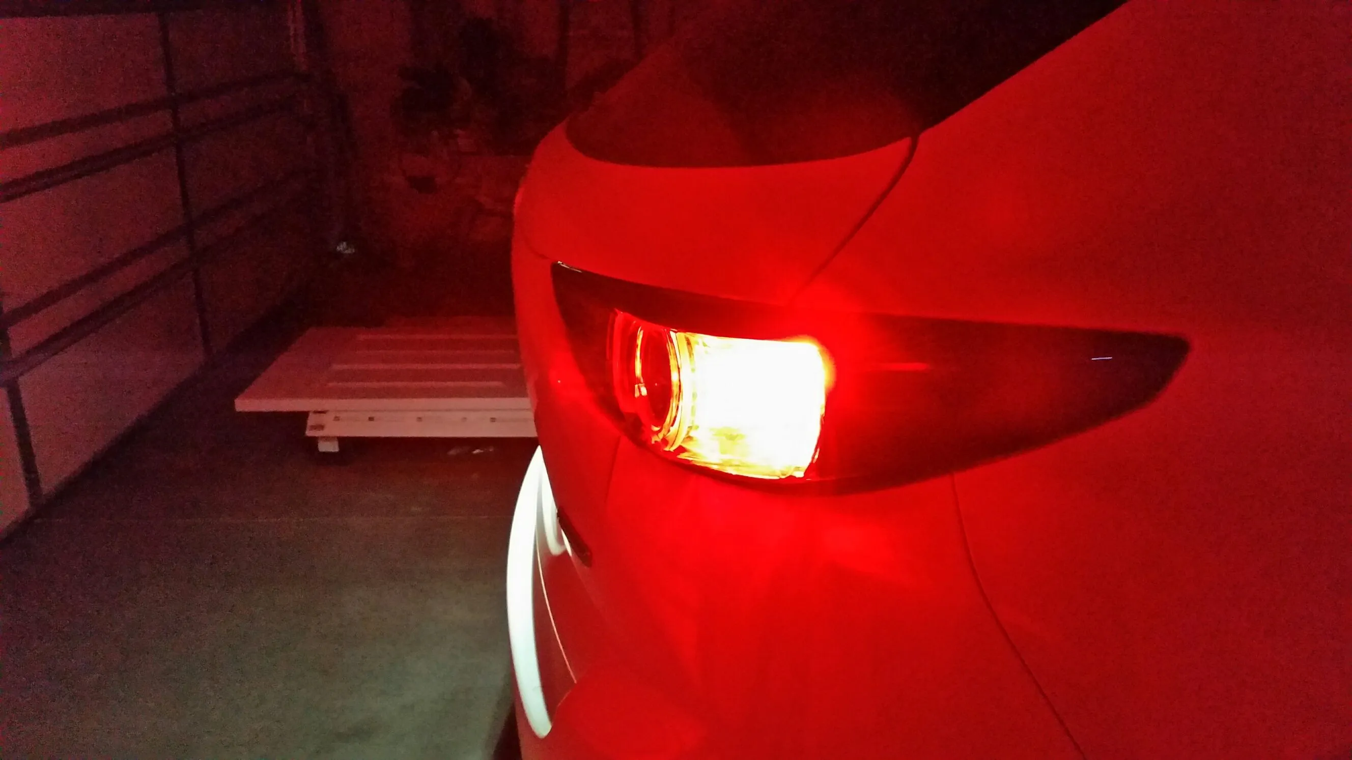

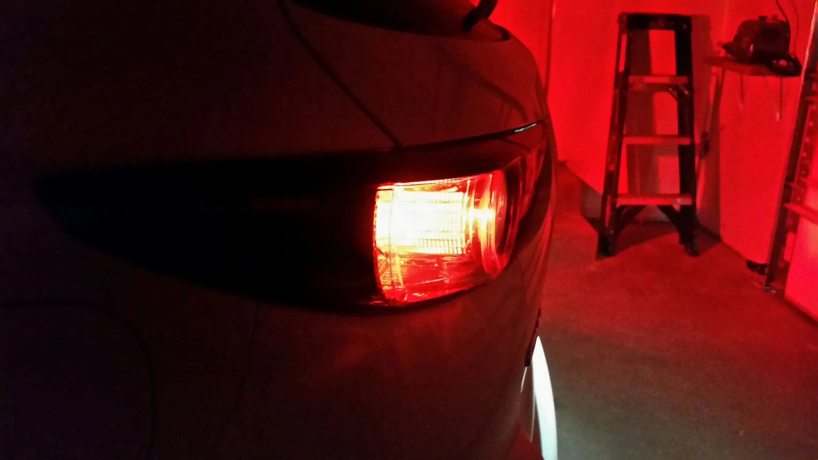

1 - The Diode Dynamics ARE DUAL FILAMENT LED's so they will light up at 1/2 power (255 Lumens) when the headlights are on and then go full power (510 Lumens) when you apply the brakes. With Diode Dynamics, those are high-quality LED's. A lot of the other LED's out there are actually LESS BRIGHT than the OEM bulbs, which defeats the purpose of swapping them out. As the saying goes, Lumens matter and you get what you pay for.
2 - One doesn't need the diode since these are not turn signal LEDs but just brake light LEDs.
Look at the before & after pics I posted below. Big difference in brightness and redness. OEM bulbs are clear white and they use the red lens to get the red color. These LED's are RED to begin with so they really pop on the red spectrum when turned on.

Just installed the Diode Dynamic 510 lumen red led taillights on my 2018 Touring and its much brighter now, thanks for your help!
No problem.
Makes a big difference, plug & play, plus a quality LED
Installed one of these in one taillight - was no brighter than the stock filament bulb. Looks like ~500lumen bulbs are the way to go.
OEM bulbs are around 300 lumens. Diode Dynamics 500 lumen RED LEDs is the way to go.
