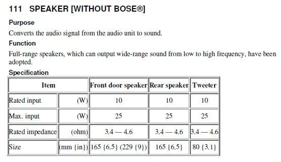

c. A low RMS spec was desired since the speaker was going to run off of radio power. NOTE: The Kicker 46CSC35 wasn*t available at that time of purchase, but at the time of this post, it is...go figure.
The Kicker 43DSC35 specs are as follows (from the Kicker brochure):
- Power handling: 20W RMS (80W peak) -- [Crutchfield listed RMS as 6-15W...hmmmm, strange]
- Sensitivity: 88dB (yes, I know there are other speakers with higher sensitivity)

- the information I used to make my determination on the RMS value (why I chose the Kicker DSC line)

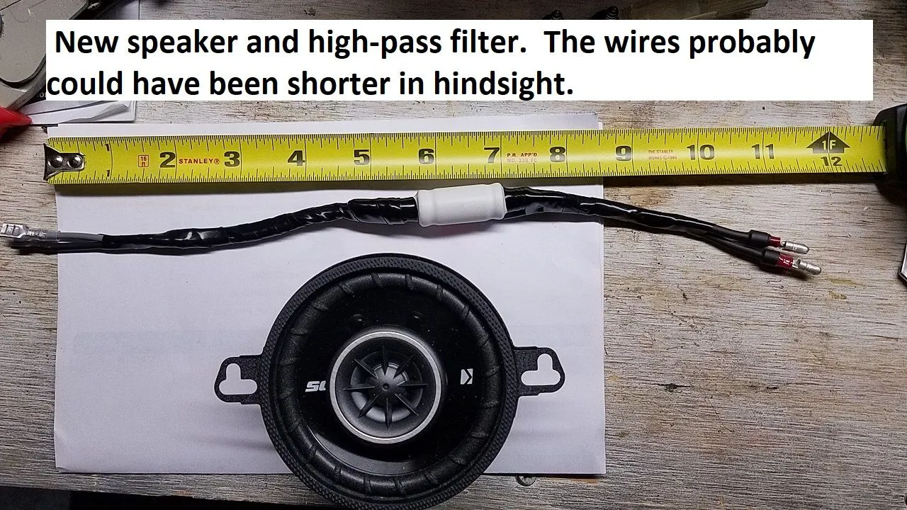

- new speaker and associated wire with high-pass filter (12)

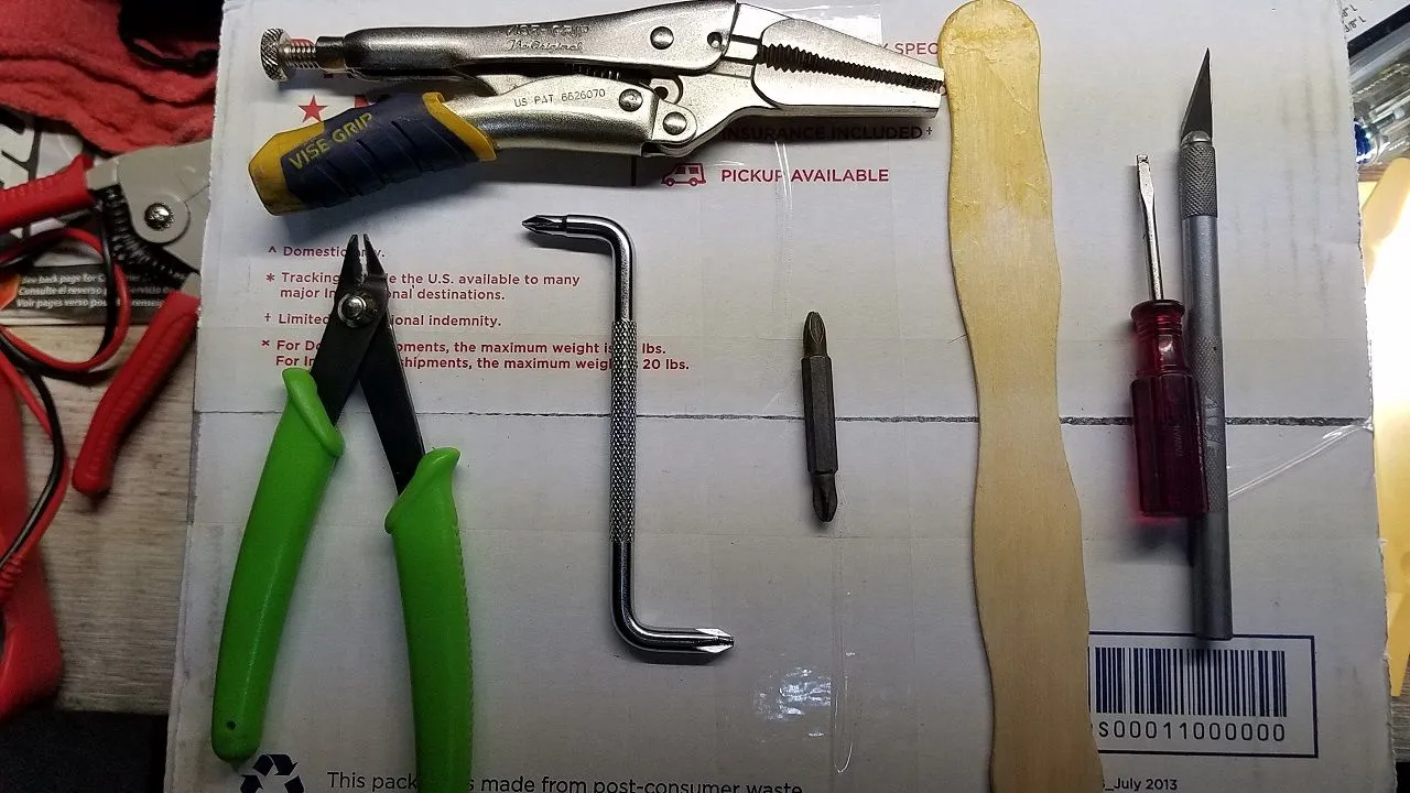

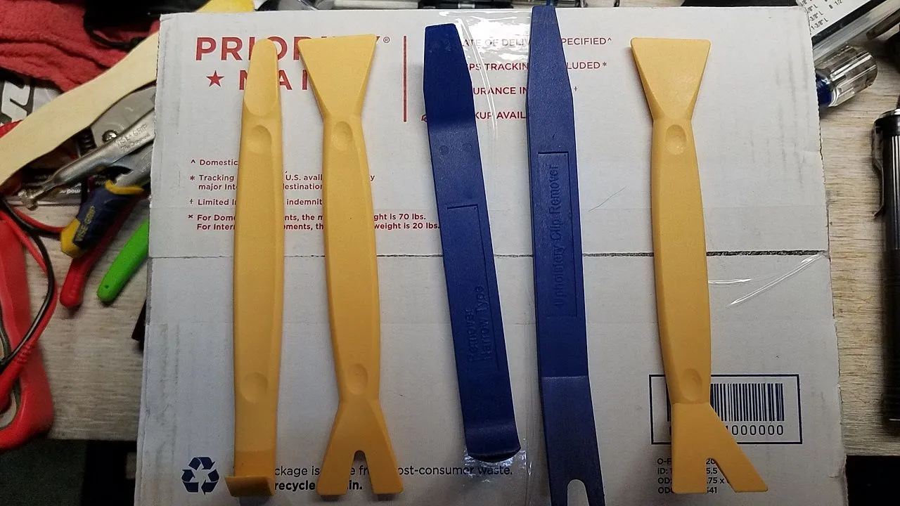

Tools used during my installation:
- 90* Philips screwdriver (slow going but doable)
- Various trim panel removal tools
- Small wooden hand-fan handle (Popsicle sticks could work too)
- Painter's tape
- Locking needle nose pliers (to hold wires while splicing/crimping)
- 1"* Philips " bit (to spin the screws faster than the 90" screwdriver)
- Wire cutters
- X-acto knife
- Crimping tool
- Electrical tape
- Bullet and spade crimps (I used bullet on the p-side, but changed to spade on the d-side.)
In addition to the 3.5" speakers, I picked up some passive, 1st order, 6dB slope high-pass filters (aka bass blockers) from Parts Express. I ordered a set of the 600Hz at 4ohm (p/n 266-205) and a set of the 800Hz at 4ohm (p/n 266-210) in case the 600s weren't to my liking. NOTE: I picked up two sets from PE for about the same price as one set from Crutchfield.
I left the capacitor on the wire as I did not know how much room I had to play with in the speaker mounting area under the dash. Having a giant capacitor sticking off the side limits mounting possibilities and I knew the driver's side would be difficult and non-accommodating.
The added wire gave me a bit more flexibility during installation since I decided to cut off the factory 2-pin harness. Maybe with more room, where the speaker goes, I would have separated the capacitor from the wires and reattached it directly to the speaker.

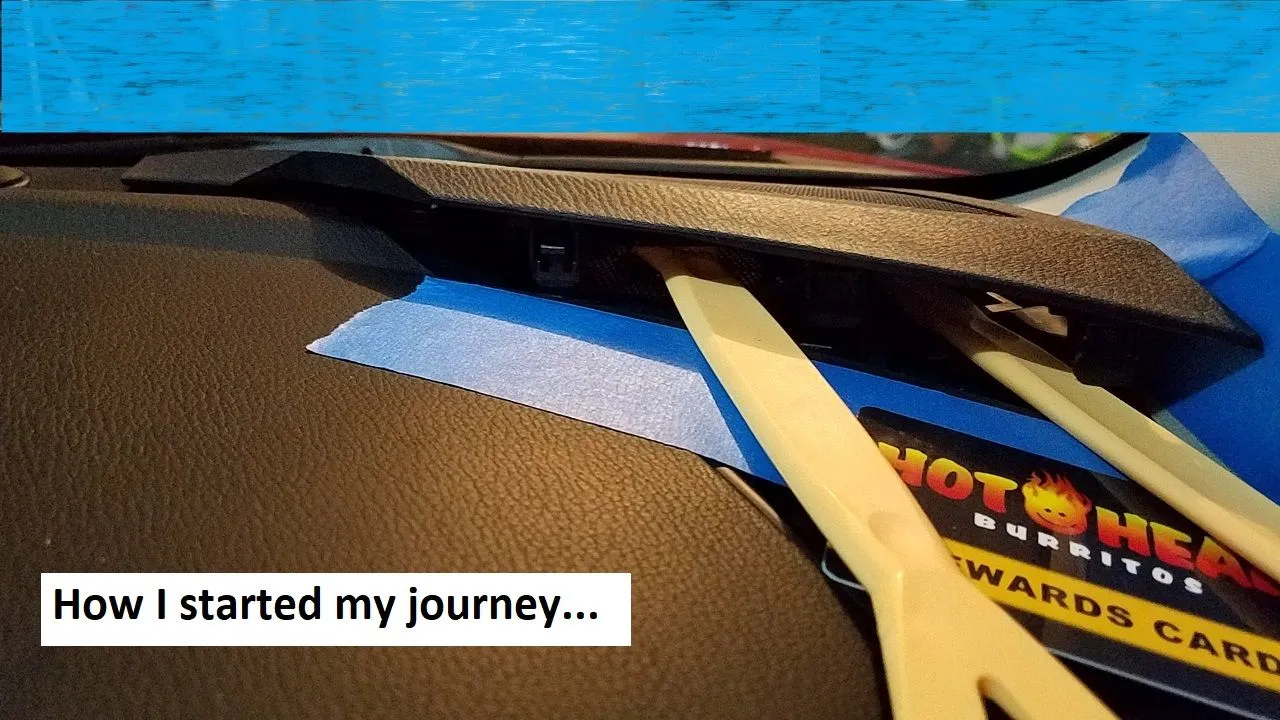

I covered the dash area around the speaker grill, the windshield, and the A-pillar trim with painter's tape.
I worked my trim panel tools from the outer edge closest to the A-pillar until the grill popped up. I also used a plastic card I had lying around to provide support and to mitigate marring of the dash. Then I worked in other trim tools to pop the tabs moving toward the inside.

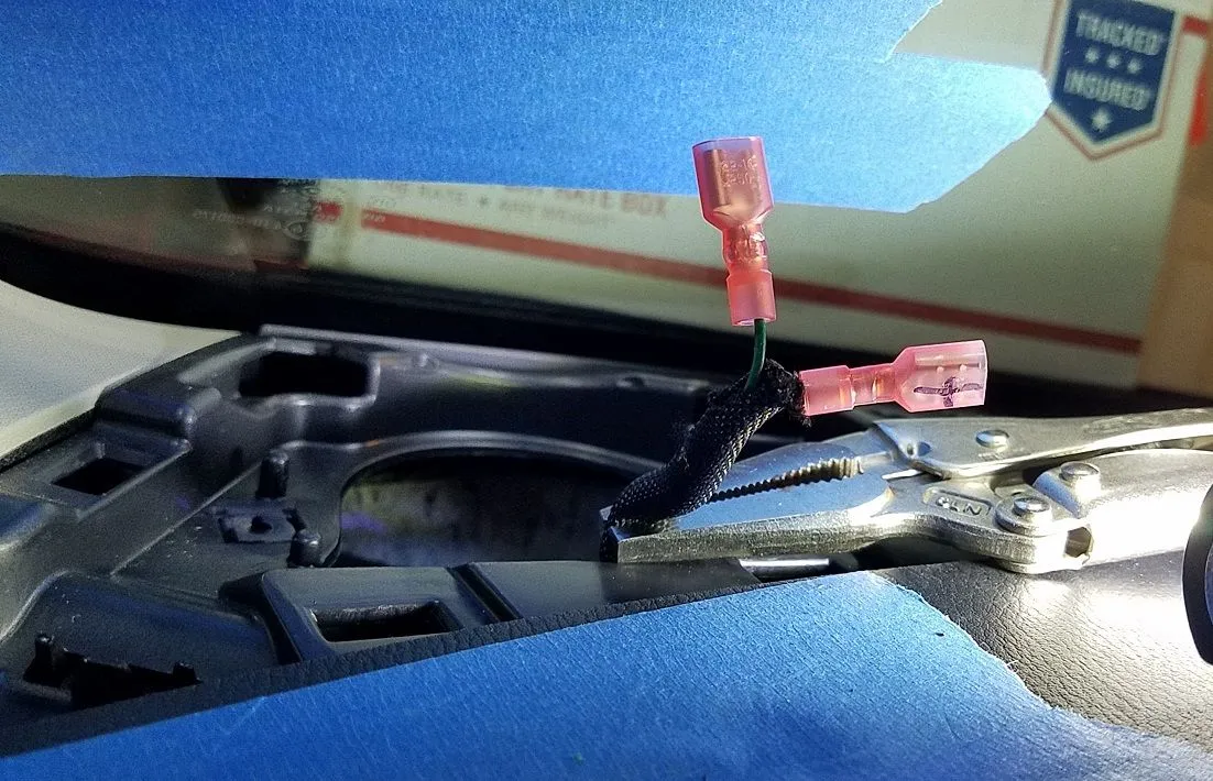

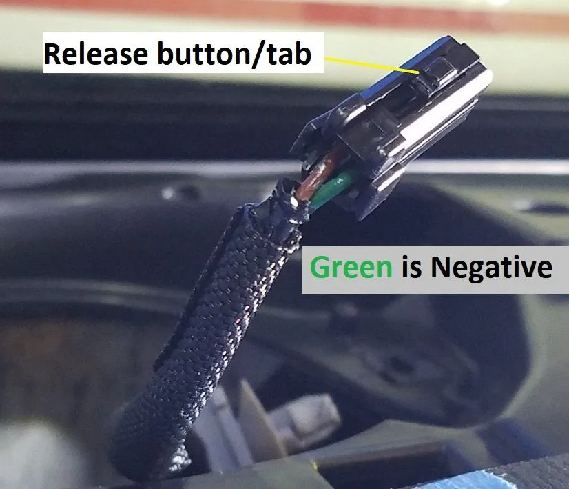

Next, I removed the factory tweeter from the area and the factory harness by pushing the little button on the side. Again, this is the 6-speaker, non-Bose stereo in a 2016 Touring w/o NAV.
It was tight in there for splicing and crimping since the factory wires are short. I did not disconnect the wire holder (a light gray plastic piece), but I should have.
GREEN wire is negative on the factory tweeter wiring.
I cut and crimped the factory wire to attach my speaker and associated bass blocker. I used bullet crimps on the passenger side. I used insulated spade crimps on the driver's side because they were easier to manipulate.

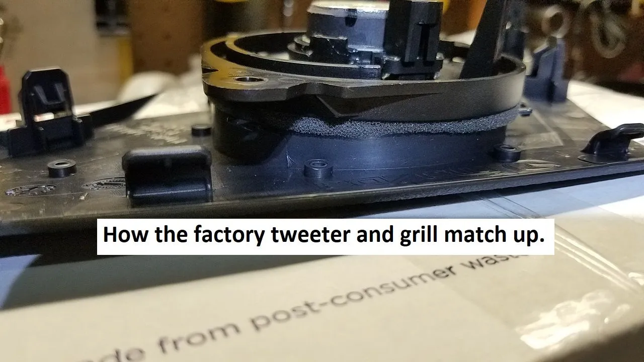

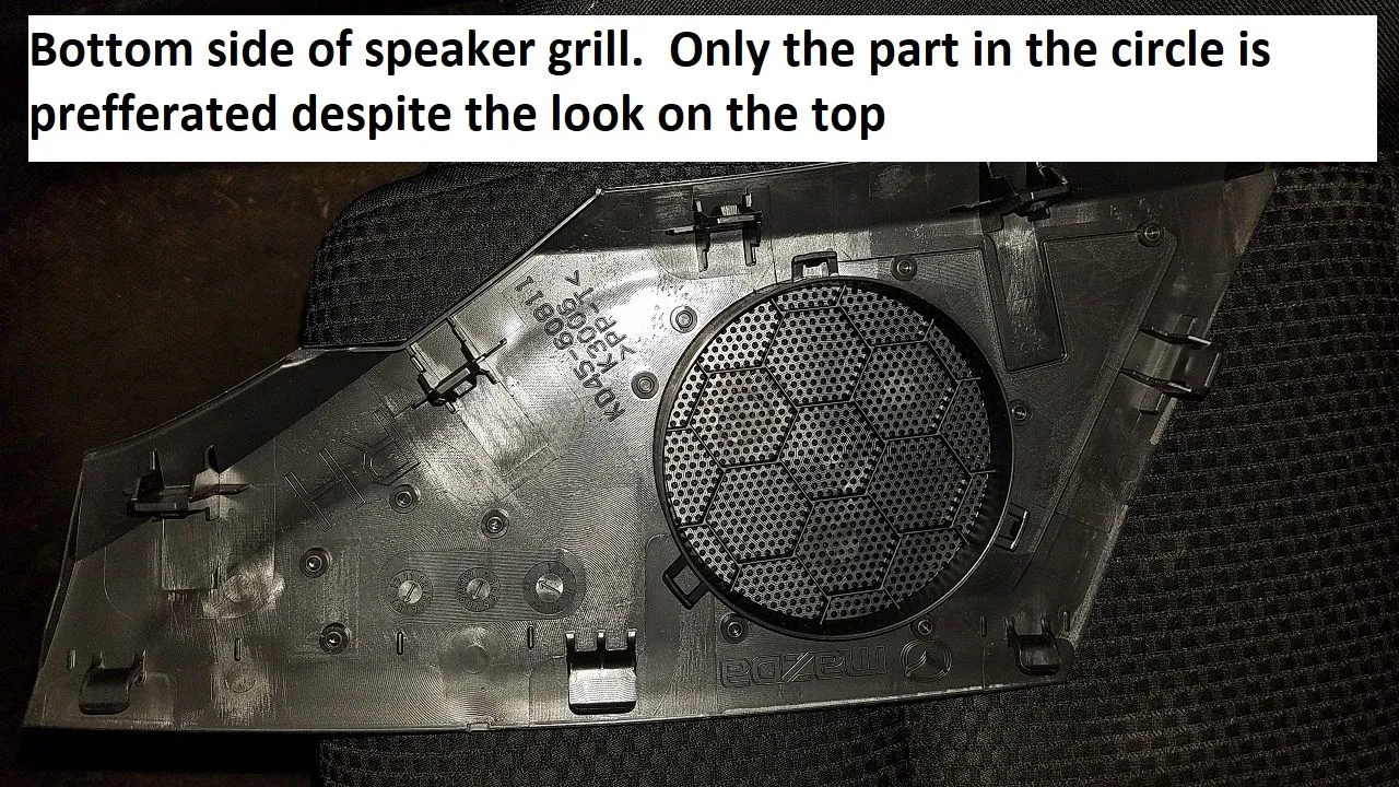

- trim tools positioned under the grill (23)
- underside of the speaker grill (19)
- factory 2-pin connector (36) --- I can see why some people use the 3-pin computer fan wires

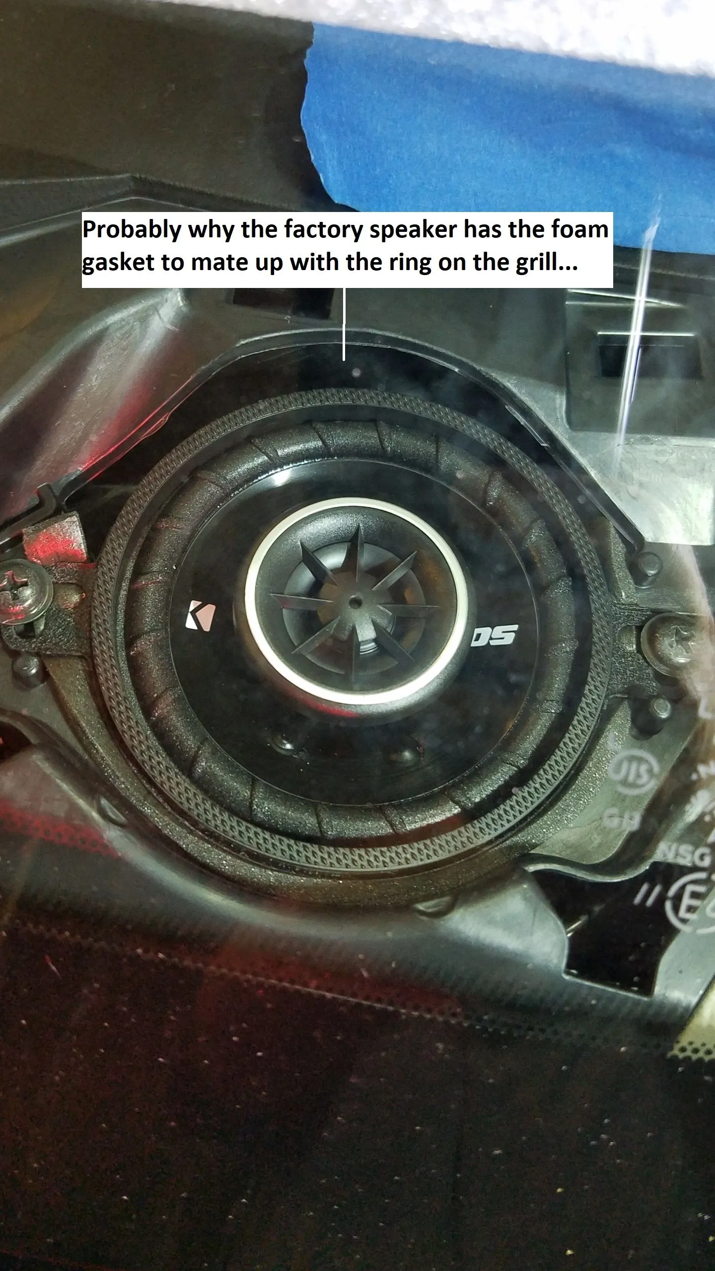

- how the factory tweeter with foam gasket mates to the grill (05) --- more on this later

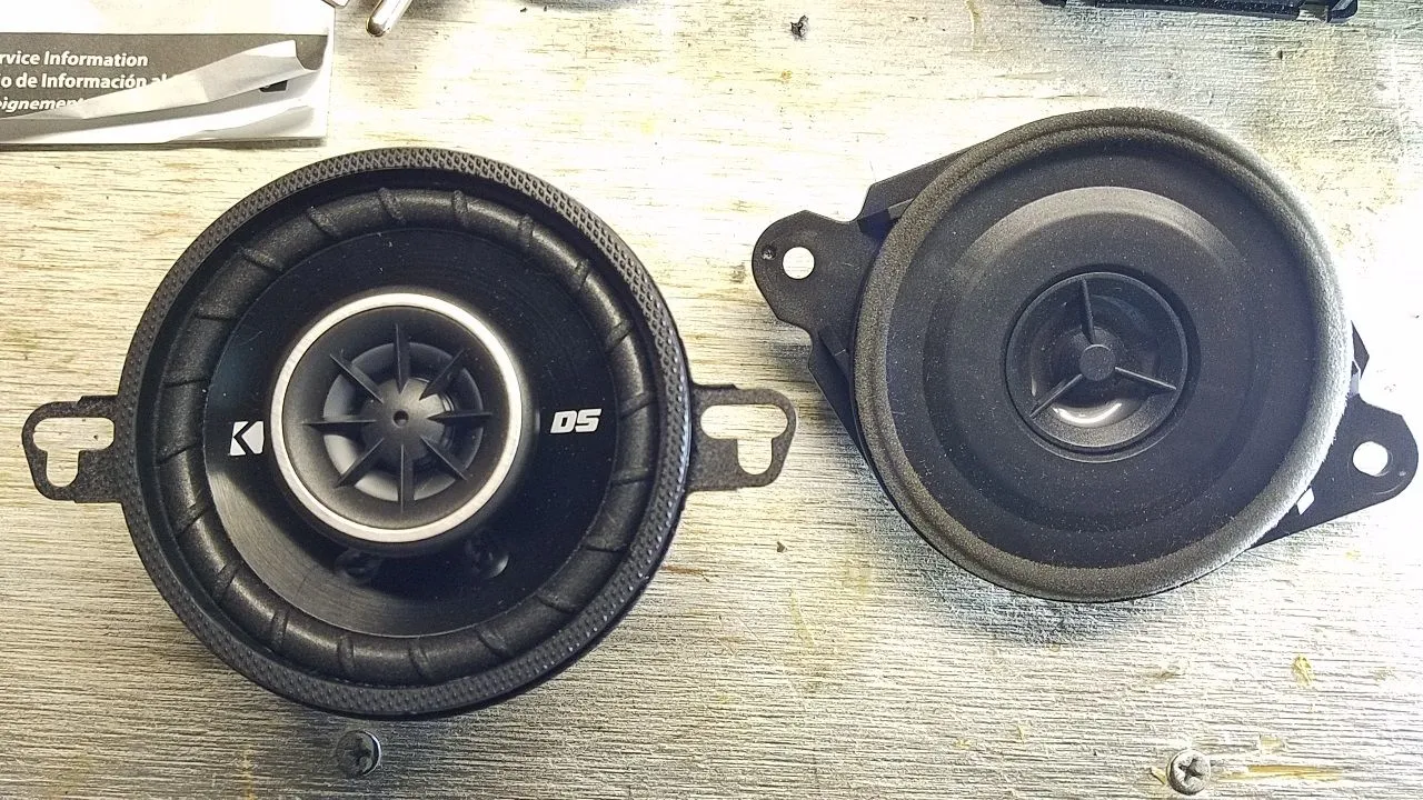

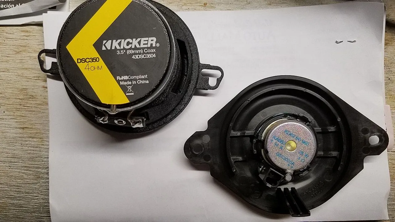

Hopefully the new speaker will add/improve mid-range/vocals in the front soundstage. The difference between the new Kicker speaker and the factory tweeter are attached. Any speaker with more than 1-1/4" mounting depth is going to contact something.

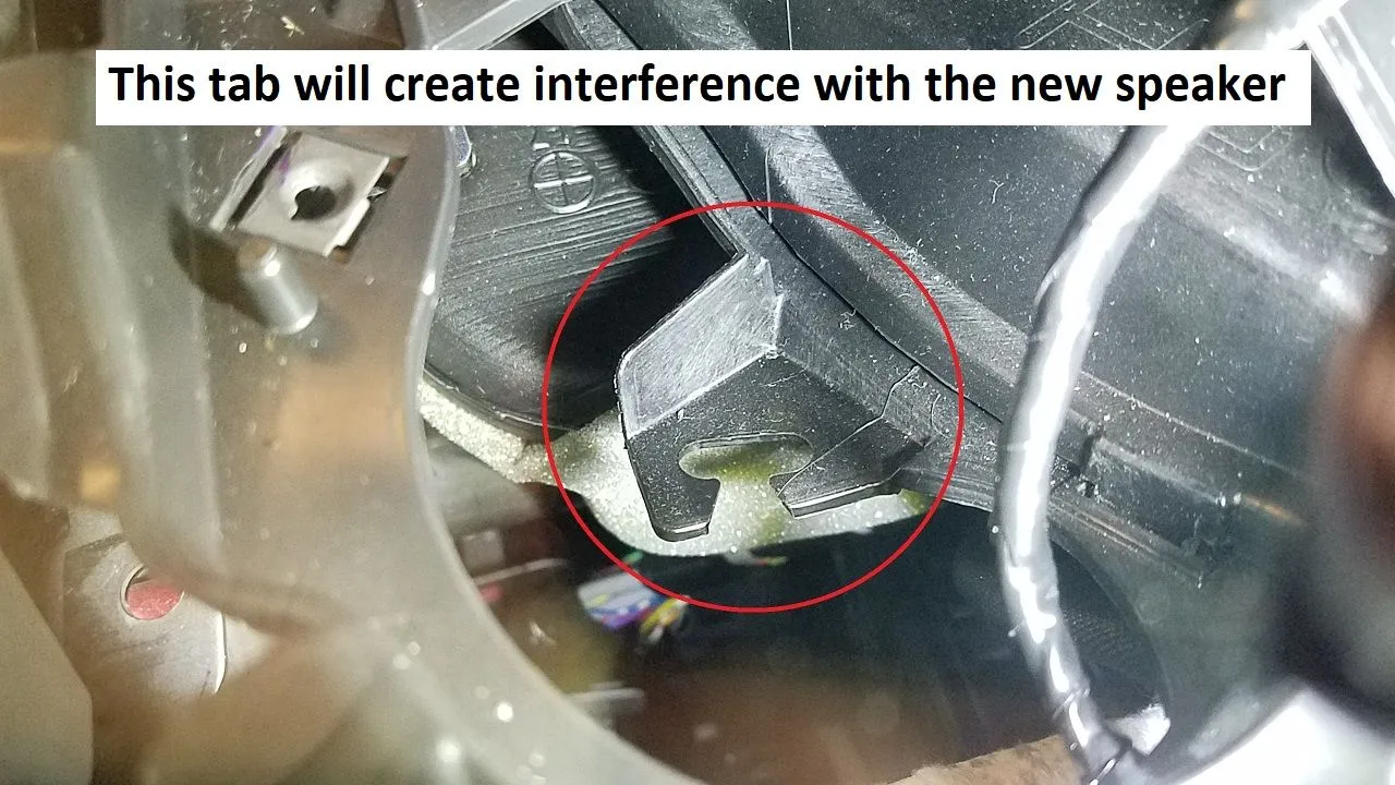

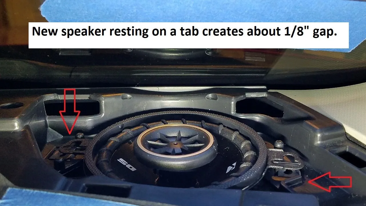

I did make a note that there is a tab/bracket in the way, on the passenger side, that prevents the speaker from sitting flush on the mounting plates. The tab pushes down easy enough, but it does leave a gap of 1/8" to overcome when screwing down the new speaker. I suppose it can be cut, but I did not have what I needed to make it an easy job, so I left it in and "forced" the speaker down.
A shallower speaker or possibly one with a smaller magnet will not have this issue. The Kicker 43DSC35 has a 1-5/8" bottom mounting depth, which is part of the issue. There are other 3.5s with less, but it all depends on personal choice. This depth issue is why Crutchfield claims installing 3.5" 2-ways as a custom install and why 3.5s are NOT recommended when you use their vehicle selector tool.
Pictures attached are as follows:

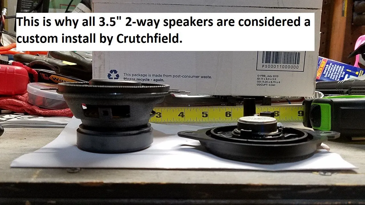

- side by side comparison of the old and new speaker (15)
- comparison picture of bottom/magnet (16)
- comparison picture of top (17)
- plastic tab that interferes with easy drop-in (11)
- new speaker sitting on said plastic tab (07)

Good: You purchased from crutchfield as they have a good returns policy I heard. Kicker speakers are good quality for the price.
The potential bad: That appears to be a 4 Ohms speaker. The OEM is something like 1.5 -1.8 I think? in other words the speaker may not sound as loud as stock paper ones although quality may improve a bit. Let us know though!
Suggestion: Look at JBL offerings like the Club-3020 for $59 right now at Crutchfield. On retailer front I've got good experience ordering from Sonic Electronix whom has competitive pricing and no tax outside of California if I can recall.
you caught me mid post...since i can only attach 5 pictures at a time, I'm doing this the hard way.
Yes, Crutchfield does have a decent return policy.

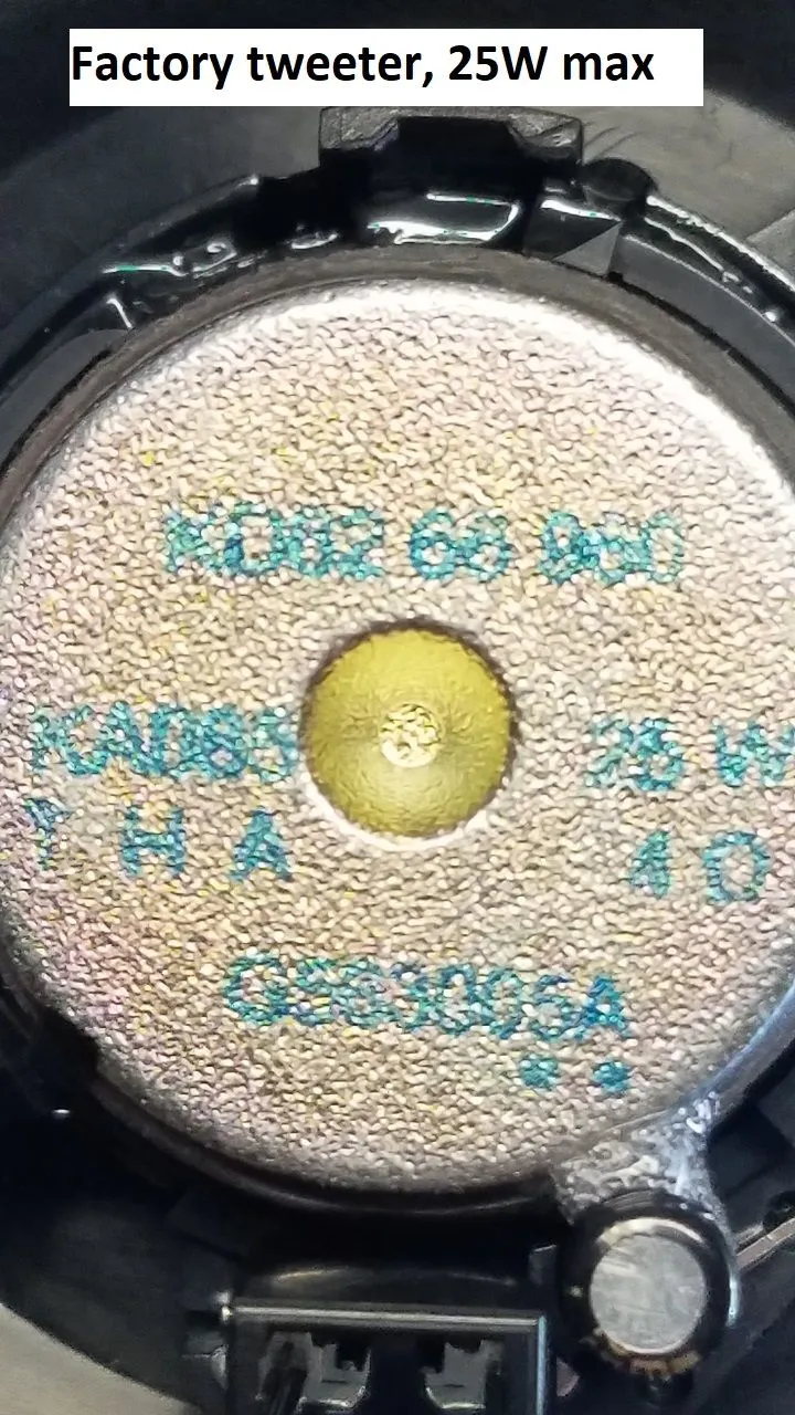

Also, I have the NON-BOSE system. My speakers are 4 ohm. The OE tweeter says 4 ohm, 25W on the back Pic attached (hard to see, but it's there...)

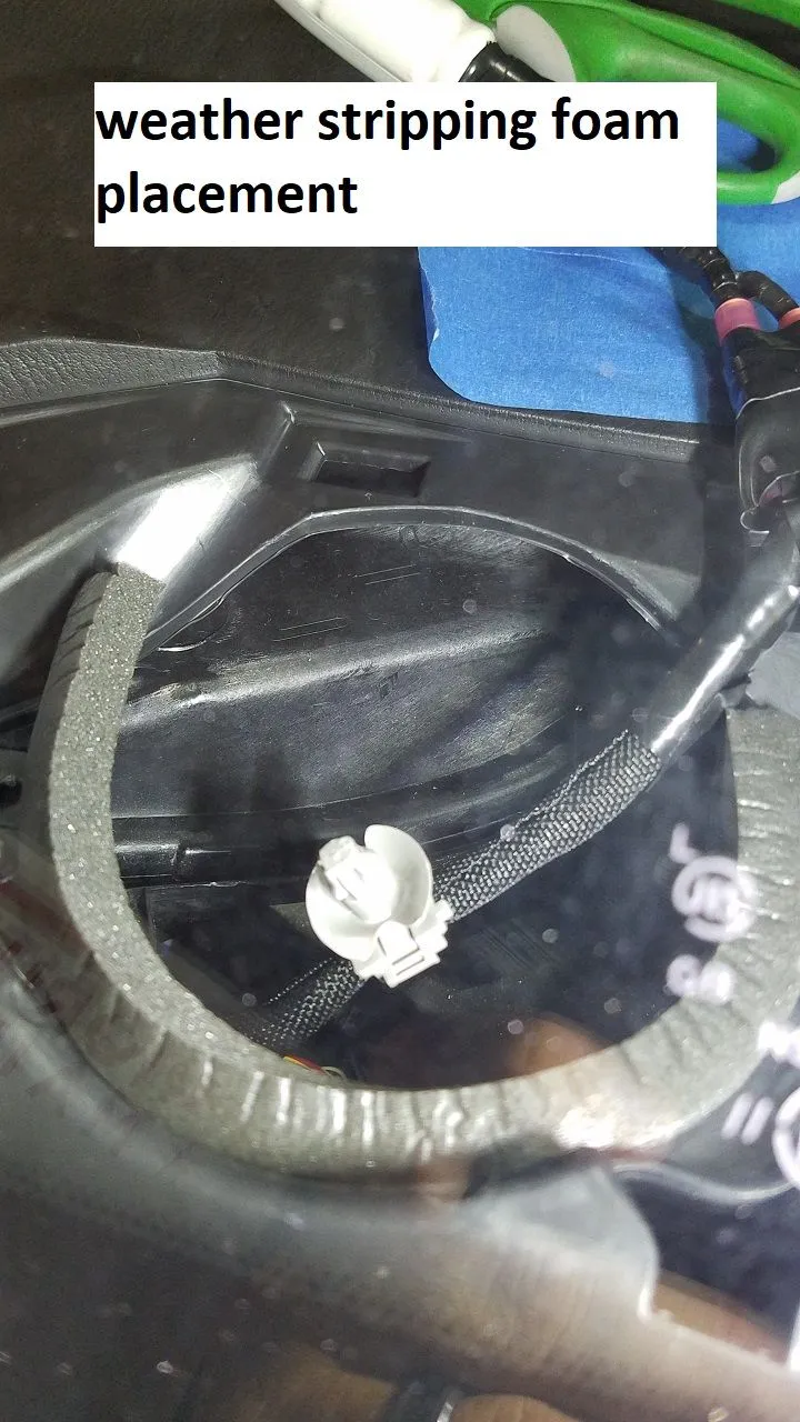

continued...

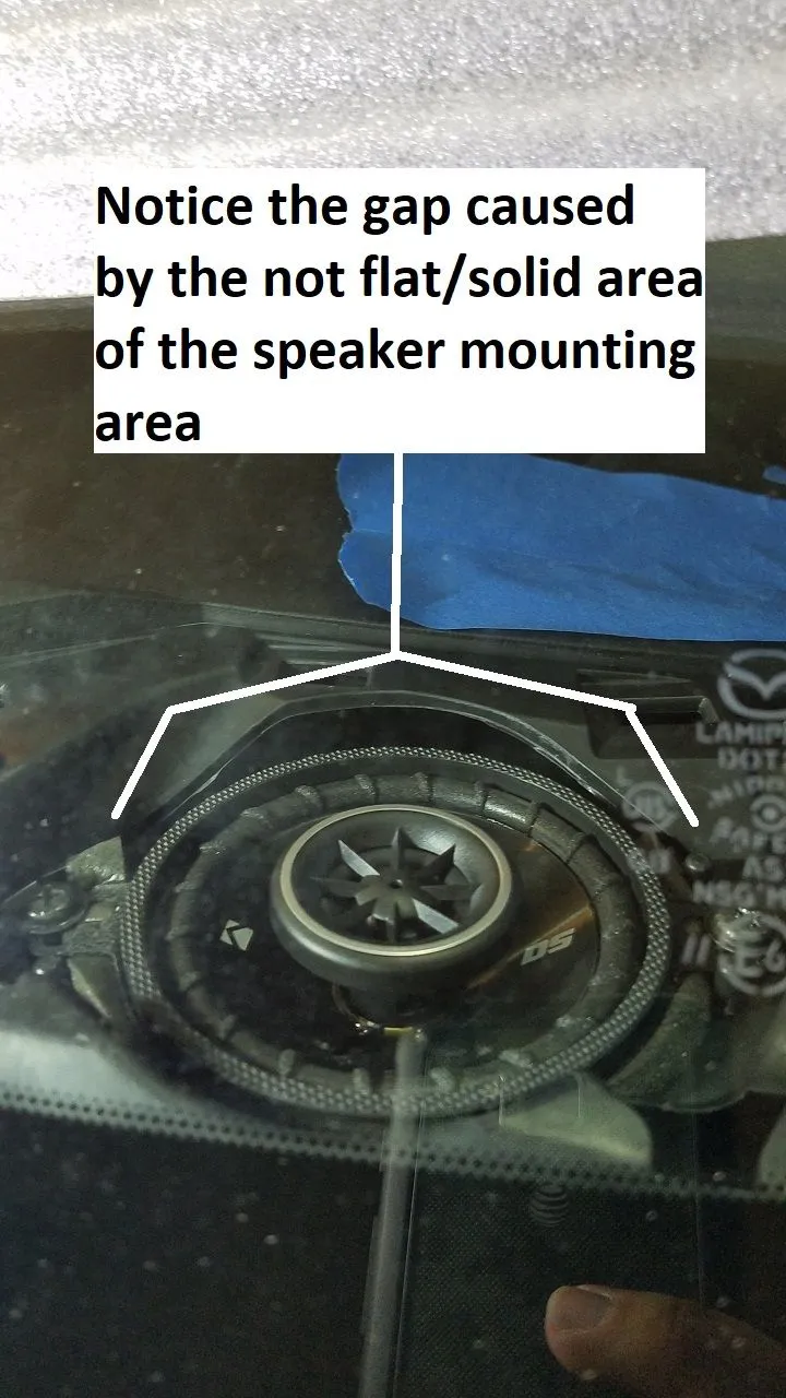

With the speaker secured on the passenger side, there is ~ 2mm clearance between the speaker gasket and the circle ring on the underside of the grill. No clearance issues here and no need to add a foam gasket like on the factory tweeter, which I am sure is there for another reason unrelated to sound.
I suppose I could add a gasket, but I dont believe Ill gain any (extra) midrange. If I get any vibration/rattling from the speaker grill, Ill rethink the gasket idea.

Unscrewed the factory tweeter, removed the harness, cut the wires, and added my spade crimps. GREEN wire is negative.
To aid in crimping the factory wires, I removed the cable stay this time to give me some extra length. The cable stay is the gray piece attached to the wire(s) in some of these pictures.

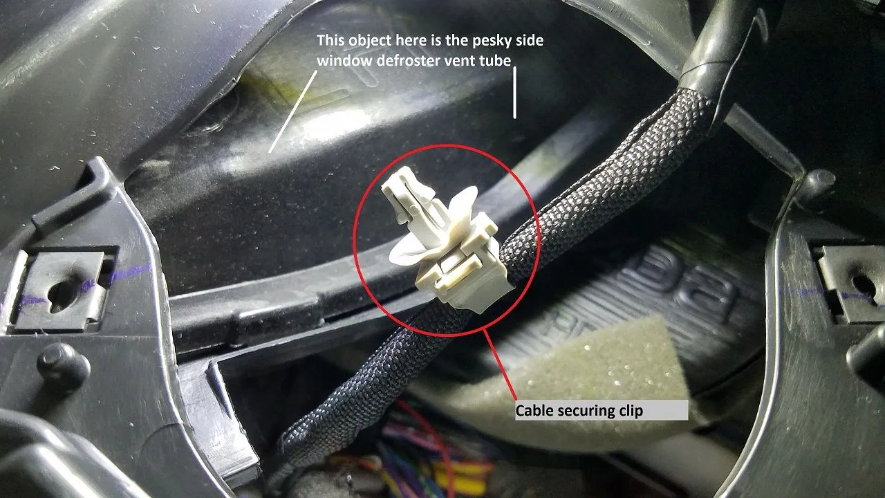

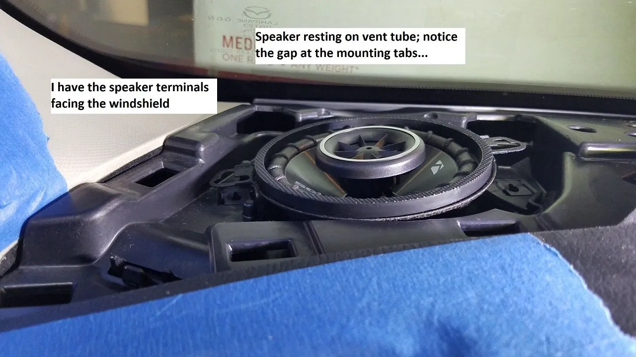

Now, here is why the drivers side is tougher than the passenger side.

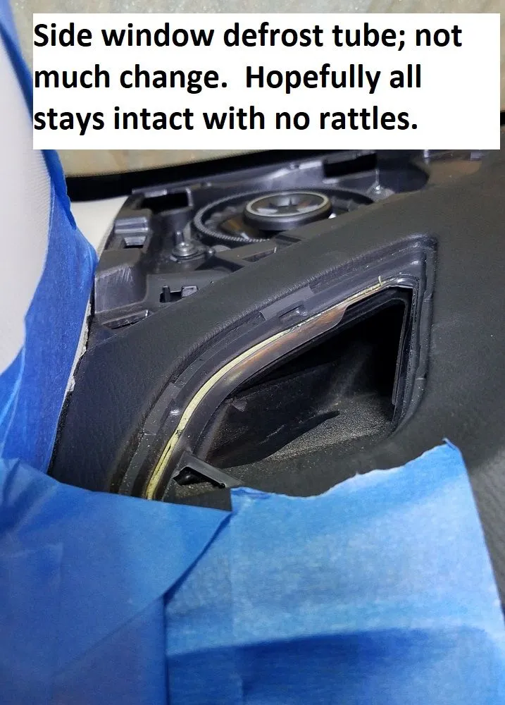

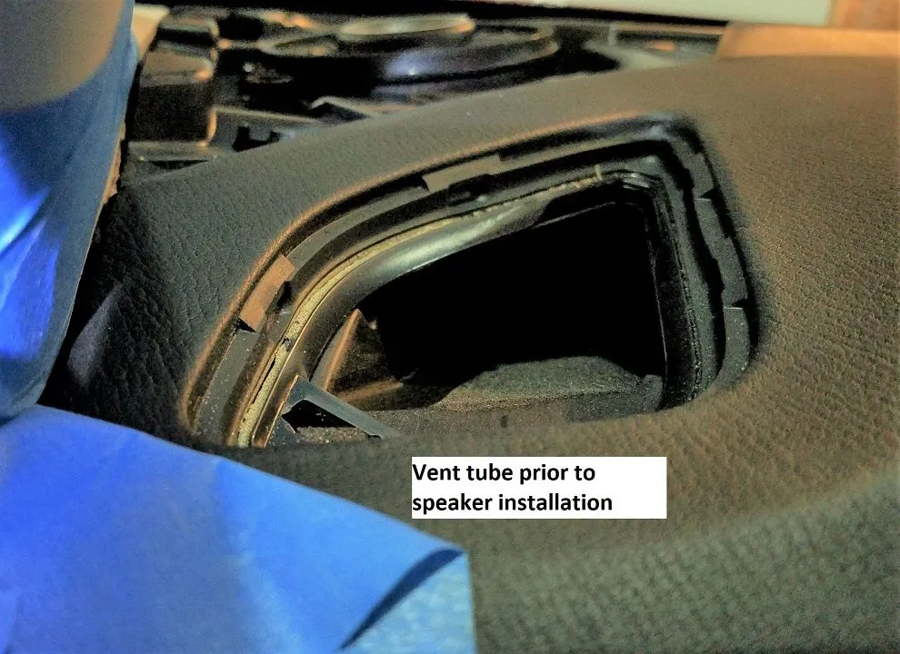

As others before me have noted, the side window defroster vent tube cuts right through the area the magnet of the new speaker will go.
This tube will cause the new speaker to sit up rather high. The only good news is the tube seems to flex just enough to enable you to anchor the new speaker down to a point to clear the speaker grill.
Because of the tube, I faced the speaker terminals toward the windshield to minimize interference with the terminals/wires.
The speaker mounting area is not at the same level all the way around. I added some 3/8W x 5/16 Thick weather stripping around the back half of the speaker 'hole' to help eliminate the air gap caused by the higher position the speaker was going to be in. Did it do anything? Not sure, but I put it there anyway.
- spade crimps (38)
- shot of the side window defroster tube that is in the way (44)
- shot of foam I added to back of speaker mounting area (56)
- how much the new speakers sticks up when resting on the defroster tube (46)

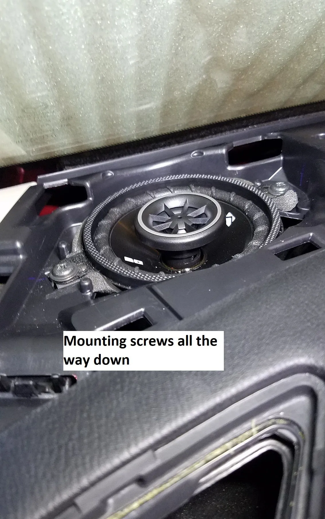

I slowly tightened the screws on the driver side speaker a few turns on each side, and little by little, the speaker slowly got closer to the mounting surface. I did not see any deformation of the side window defroster tube at the vent exit. Hopefully there will be no noise or rattling.
On the driver side, the speaker grill did seem to contact the new speaker's gasket, so I trimmed a couple of mm from the ring on the speaker grill. I used my green handled cutters. The plastic ring is still there; however, there is just less of it now. (sorry, no picture)
I put the speaker grill on and defroster vent deflector in place. Job is a wrap. (alright)
- defrost tube with vent cover removed (50)
- new speaker installed; screws all the way down (60)
- gap around speaker (62)
- another view of open area around speaker (64)
- vent tube after speaker tightened, not much change (68)
