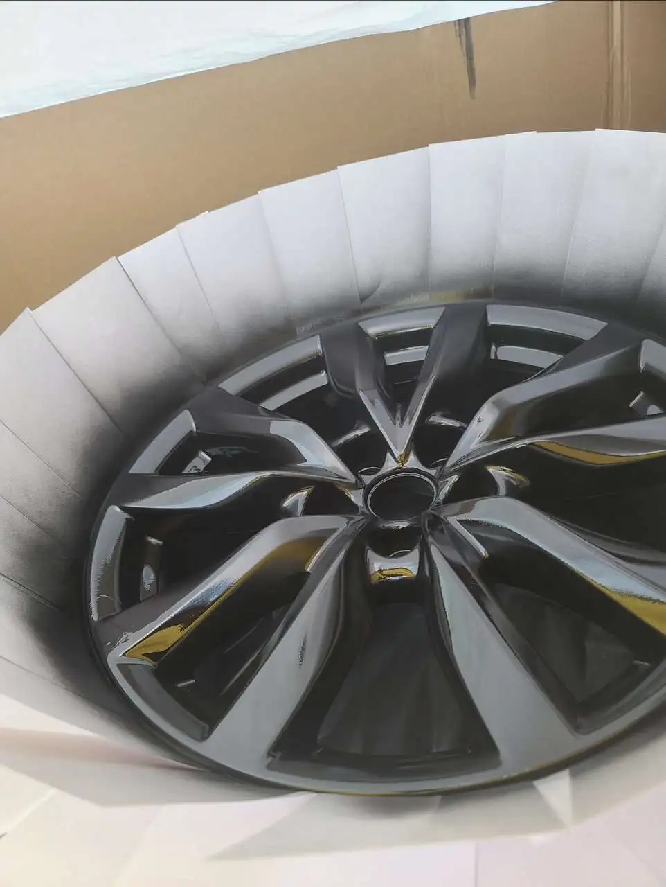

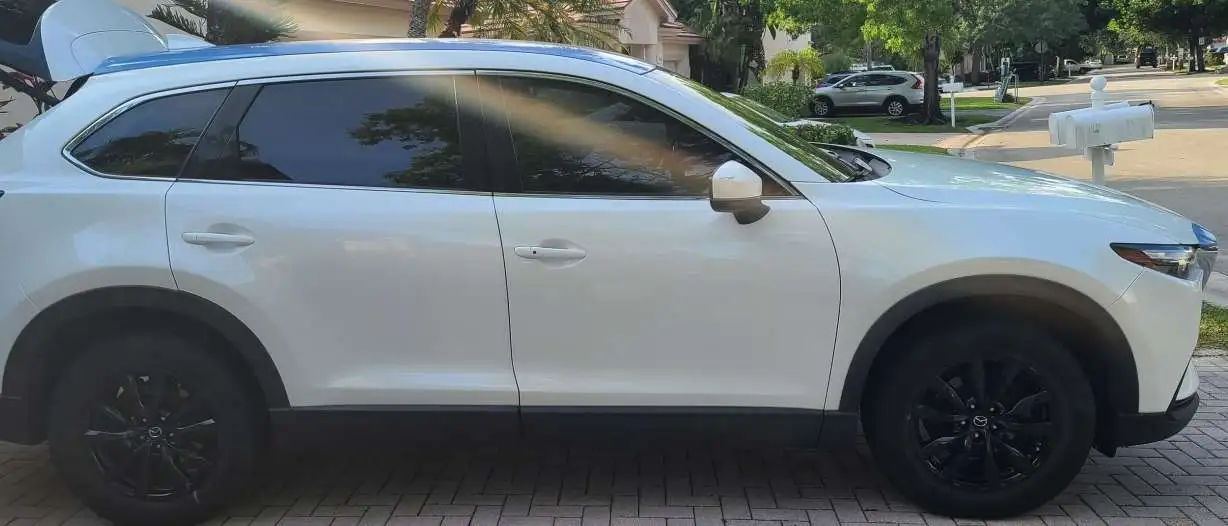

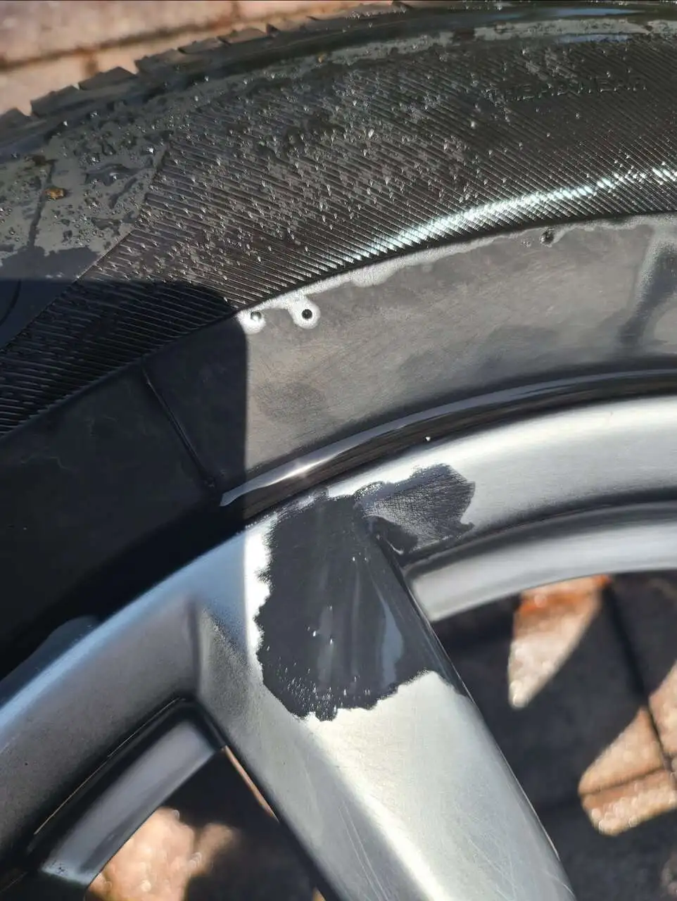

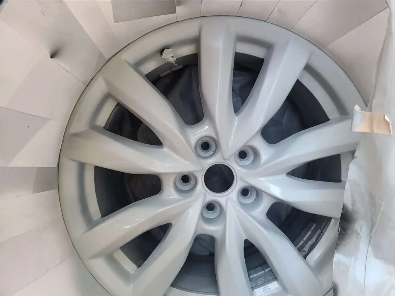

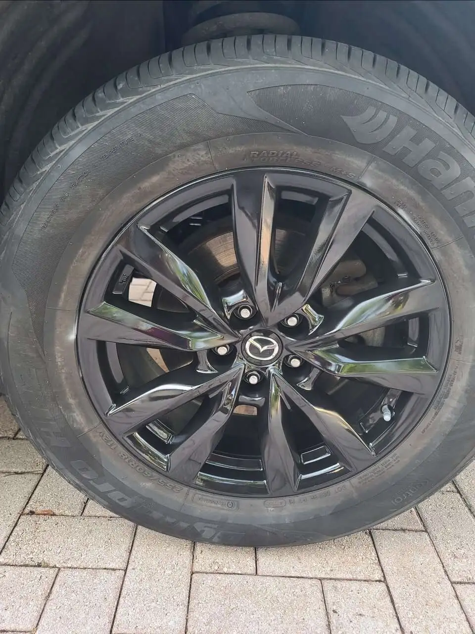

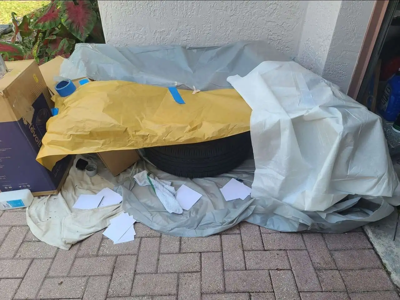

Hi guys. I also got the first cx-9 batch with same issue. It wasn't bad at first, just dark spots. But since the peeling happen, I decided to paint it. Only one big peel happened. So I decided to seal everything in. One area due to the peel can be found if you really look. But idc
Time spent 8 hours. Prep takes a while. I made sure it was going to be a sunny day.
3 base primer, 3 black, and 3 clear coat. Going back, I think doing 5 clear is best. This would added better protection. Rust-Oleum Automotive Gloss Acrylic Enamel as clear. Black was cheaper Krylon Fusion. Idk if paying for the black enamel would be better. 3 cans each.
It does hold up well, but you need to baby it. No more going to a car wash. Don't use too much water pressure. And get a plastic cover lug wheel nut remover.
Be very careful when placing it back onto the car when you swap next ones to paint. Paint is still very soft. It won't fully cure for a month to maximum hardness and sticky to metal. That night the water sprinkler turn on and was enough to leave some spots... Oh well
