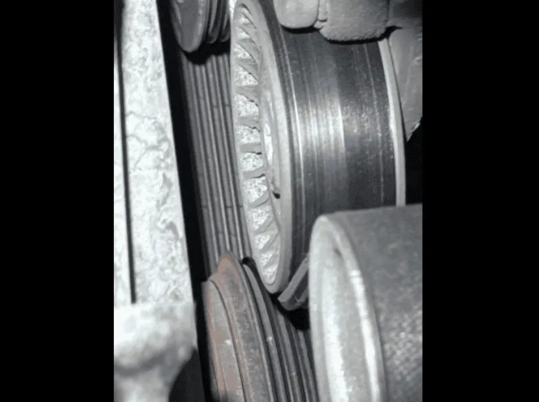

Any thoughts on the drive belt-serpentine. Apparently, it is also due. Please see below

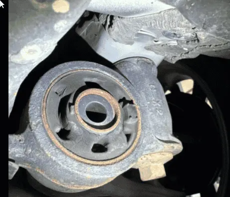

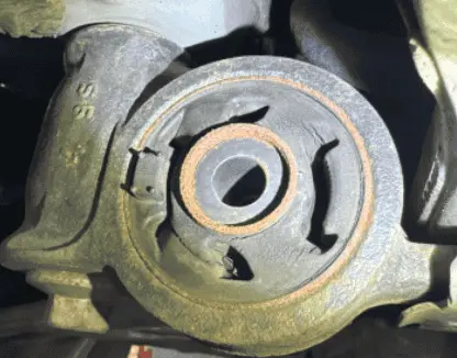

Also adding both LCAs - do both look bad equally bad (rubber and ball joint)
If the ball joints on the LCAs are still in good shape without play, the worn bushings won’t cause immediate danger other than some clunking noise. But if the rubber seal on ball joints is cracked or broken with play, it definitely is time to replace the LCAs. I went to Brakes Plus to replace a LCA on passenger side with my own OEM LCA, the labor is $258 and the 4-wheel alignment is $87.
Yes your serpentine belt has cracks and should be replaced. There’s a water pump stretch belt inside of serpentine belt which should be replaced at the same time and save the labor charge. If you’re going to DIY on this task using the OEM water pump stretch belt is recommended as the aftermarket belt such as Gates is a bit shorter and it’s very difficult to put on. And don’t forget to replace the belt tensioner as the factory tensioner is prone to leak. Use only OEM or INA tensioner.
And don’t forget to replace the coolant with fresh FL-22 coolant, it’s due in 10 years, and 5 years thereafter.
Early worn can just make for sloppy handling without clunks and squeaks … at least that was the case on a few of my older vehicles in the past.
These cars' LCA bushings seem to clunk first and fail second. Very little movement (if any) detectable until they fail.
I would definitely replace that serpentine belt as precautionary measure. At 220,000km, mine was in rough shape.
If your ball joints have play in them, find a better quote and replace them. Otherwise, you could leave those for now (if you wish.)

Gates will give you a gauge to check wear with. If you see sections of the micro ribs missing it needs replacement. Cracks in the ribs mean it will need it soon.

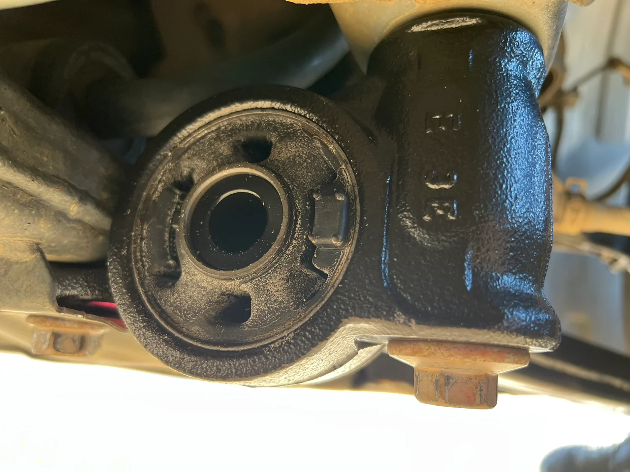

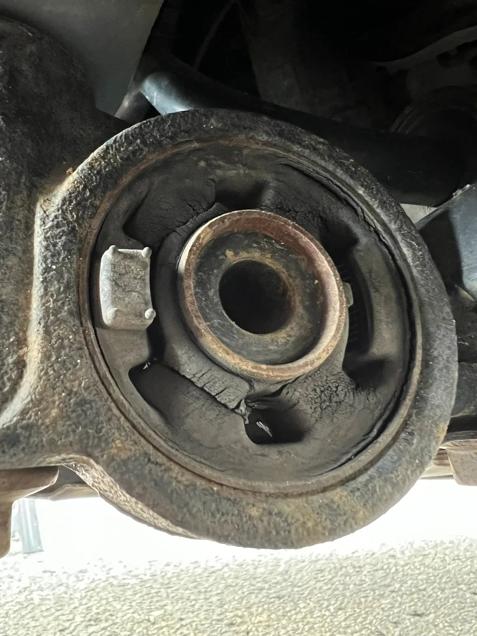

8) Lower Control Arms. This issue is my primary reason for this reply. As my car ages, I've gotten used to how it feels over time and it's hard to remember what it was like when it was new. But I would drive on city roads at 5-40 miles per hour and when hitting bumps like asphalt patch work, the car would rumble and then the car would shift to the left or right a little bit. It didn't feel stable, yet not bad enough to feel unsafe. It really started to sound and feel like "an old car" and many people would just sell it and buy another.
I took it to the dealer whose been doing my work and they replaced the Lower Control arms, Sway bar links, and tie rod ends (so much of the front suspension) for about $2,000. Initially this felt like an expensive repair where you spend money and things just aren't broken anymore but your money is gone. But immediately upon driving with a new front suspension I re-discovered the initial love I had for driving my Mazda on curvy roads. And not just curvy roads but anytime I needed to do more than straight driving. No more rumble sound, steering and handling is precise and nimble and I feel confident and in-control.
This one "repair" felt like an improvement and has changed my attitude about having maintenance done. With the cost of new cars being so high, I'm choosing to explore spending a good amount of money on "investment" work: both proactive and reactive "repairs" in hopes that I can get another 90,000 miles out of this.
Shown below are the before and after of the Lower Control Arm bushings. Anyone should be able to use a phone camera under their car to self inspect to compare what they have now vs brand new. Doing so helps you know your mechanic isn't just making something up and that this may actually improve or restore your driving comfort.
