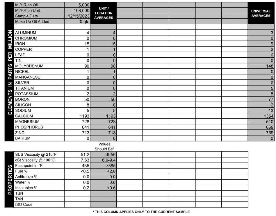

Here is the oil analysis - what do u guys make out of it:

Who performed the analysis? Did they provide any comments on the results?
Based solely on the number, I see higher than average iron and magnesium values, which could indicate some wear on the bearings and crank.
That's a Blackstone analysis package (unless someone else is plagiarizing their package and format!).
Yeah, iron looks higher than normal to me as well, but it's not so high that we can tell what it means without context. If it were like 2x that value or more, then yeah, I'd start to suspect something.
Magnesium is an additive. More common these days because apparently Mg-based detergent/dispersant additives are better than Ca-based ones at controlling low-speed preignition. LSPI isn't really an issue for our engines, but it is for the legions of high-strung DI turbo engines out there, so most widely available engine oils are formulated to address it to some extent. Either way, this amount of Mg is pretty common in modern mass-market engine oils, and the margin of error on the number is wide enough that I'd imagine it'd be tough to discern wear from it.

I was thinking it looked like Blackstone, but didn't want to put my assumption out there. Blackstone will provide comments to the sample and results, too. But, since the comments were cut off, figured I would ask.
