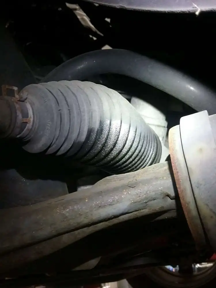

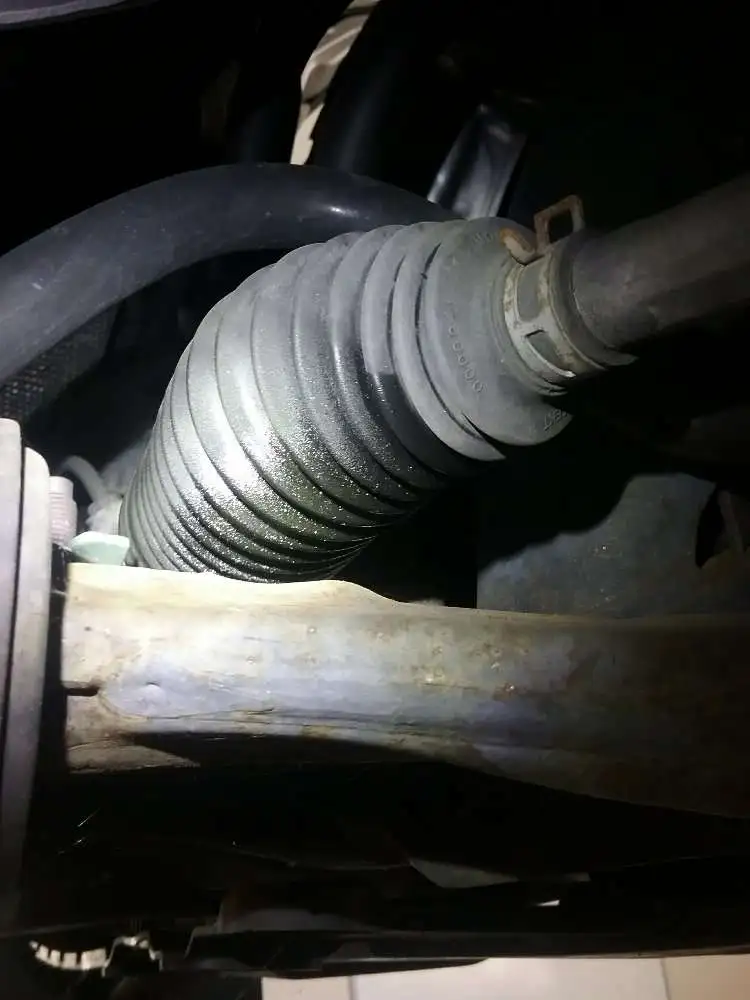

They also sent me two pics with my inspection report.
What do you think?

I'm not a mechanic. Those two pictures do indicate a leak, but again, I would get a second opinion, if only to get a quote. There is nothing wrong with expanding your options. If both of those shops can provide quotes with price breakdowns, it will help you to understand what the $1600 bill consists of. You can also inquire about bringing in your own parts if it will help save money, or you can talk to the shop to see if there are more inexpensive parts that can be used in order to bring the price down.
The leak should be dealt with though. Like engine oil, it can leak and you can still drive the car just fine, but when it leaks enough oil you'll notice that there is something wrong, and by then it might be too late.

I sent the pics to another service place to see what they say, I'll bring it in if they want me to.
