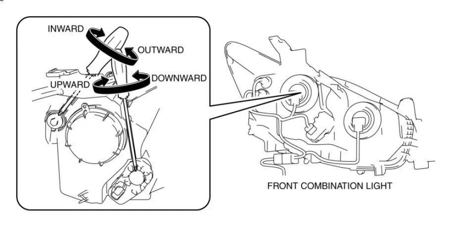

I had the same issue with mine. I raised mine manually, all it took was a level surface, a solid gray wall, and a quarter. Now I have excellent visibility and I've never been flashed by oncoming traffic for annoying them.
Tips:
- Mark your adjuster with a sharpie so you have a reference of where it was adjusted to stock.
- Make small adjustments and test drive to see the changes.
- I settled on 1/2 turn (180 degrees) up on both lights. Visibility is great, and it's not to high for oncoming traffic.
- 1 full turn brought them up way too high, it was like driving with the high beams on all the time.
- A fat phillips screwdriver works great.

Great write-up. What does the inward/outward adjustment do?
Moves the beam left and right?
I didn't mess with it. Our CX-5 has the auto-focus auto-follow thing which seems to work fine when it comes to horizontal aim. Vertical just needed a tweak up so you can actually see where you're going. The low adjustment from the factory defeats the purpose of buying the upgraded HID lights.
Personally, I prefer the manual dial for height adjustment on my 3 (which also needed to be tweaked up a bit even on it's highest setting from the factory).
I'd go take a picture, but the CX-5 is the wife's car. The service manual diagram is actually kinda lousy. Maybe tonight if I remember.
Thanks for clarifying, I adjusted the height on mine as well. I previously had a 3 too, and did the same thing. Marking the stock position is a good idea, I wish I thought of that when I adjusted mine.

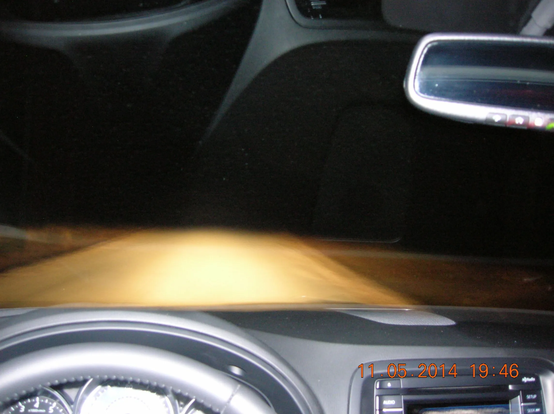

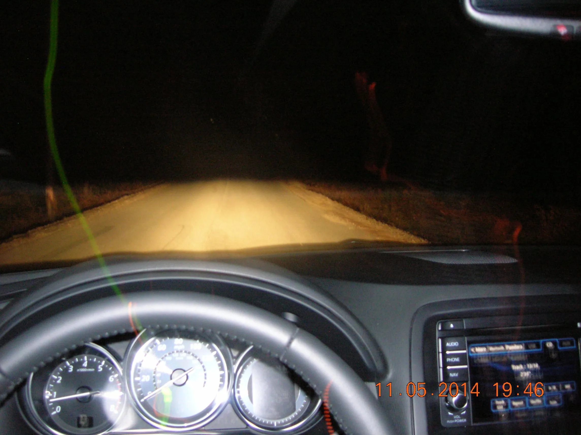

I just purchased a CX-5 GT without the technology package and was shocked to see how poor the low beams are. The cut-off is so extreme that it does seem like a black shade is covering the windshield from the top, downward leaving clarity with just the lower 1/4 of the windshield. When I'm on a road with no street lights, I have to keep my high beams on, regardless of on-coming cars or cars in front of me.
I've attached a couple of pics showing the tint.

Guys I have a new GT with tech package, is this manual adjustment option that "deuce_WI" posted possible on our car ?
Tips:
attachment.php
I glanced in at the back of my headlights today, (GT with Tech).
I could see the two adjusters in your example.
It looked like the "inward/outward" adjusted was more towards the outside of the car and up higher, it also had a white plastic cap on it.
The "upward/downward" adjuster was more towards the center of the car and sitting lower, one could more easily see the metal gear on the adjuster when looking down at it.
Does this make sense with my description ?
I may have to adjust our headlights as they are exceptionally low (and yes I have owned several cars with HID, and sharp "Euro" cutoff beams".
Yep, the up/down adjuster with the metal teeth should be easy to turn with a phillips screwdriver.
If you're making adjustments against a wall or garage door or something, a small change will make a big difference down the road.
