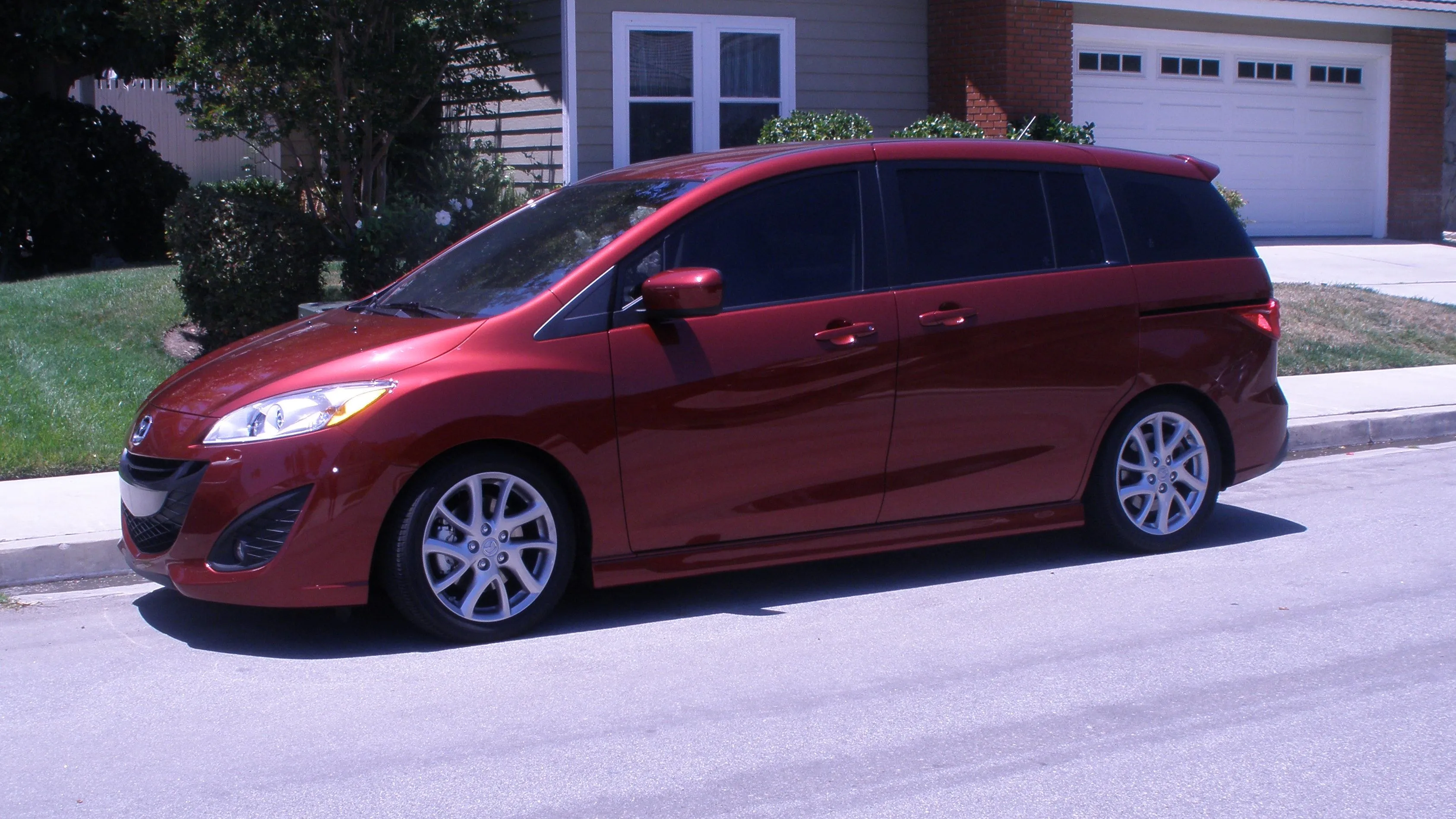

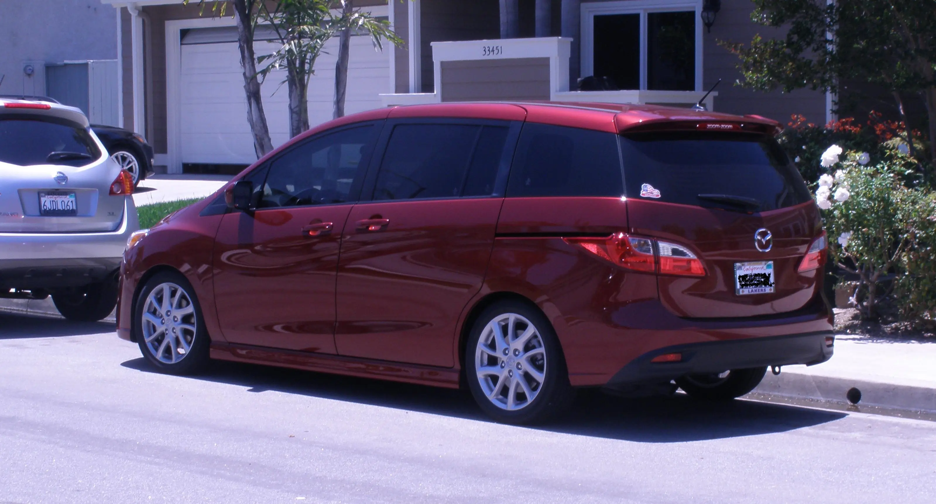

Lowered 2012 with H & R springs
I installed H & R springs for a 2010 and now have a slight popping and sort of binding noise coming from the front end on slow turns and at a stop when turning the steering wheel. Anyone know what might be causing this?
Here's a couple pics.

Lemski your car looks fantastic.
1) How much did it lower (inches?)
2) Did you keep the shock stock?
3) Did you figure out the popping/binding noise?
4) Can you give me some measurements from center of wheel to fender lip both front and back, and measurement of ground to bottom of front bumper?
Thanks
The H & R springs say the drop is 1.3 inches in the rear and 1.4 inches in the front. That's what I got when I measured when they were first installed. It might settle a little bit more. I kept the stock shocks/struts. They work fine. Yes the popping/binding noise is gone. It was a result of the installer having the top of the strut mount pop off and the ball bearings going everywhere. I helped him put it back together but we never re-lubed everything before putting them back together and the mount was binding instead of moving freely.
