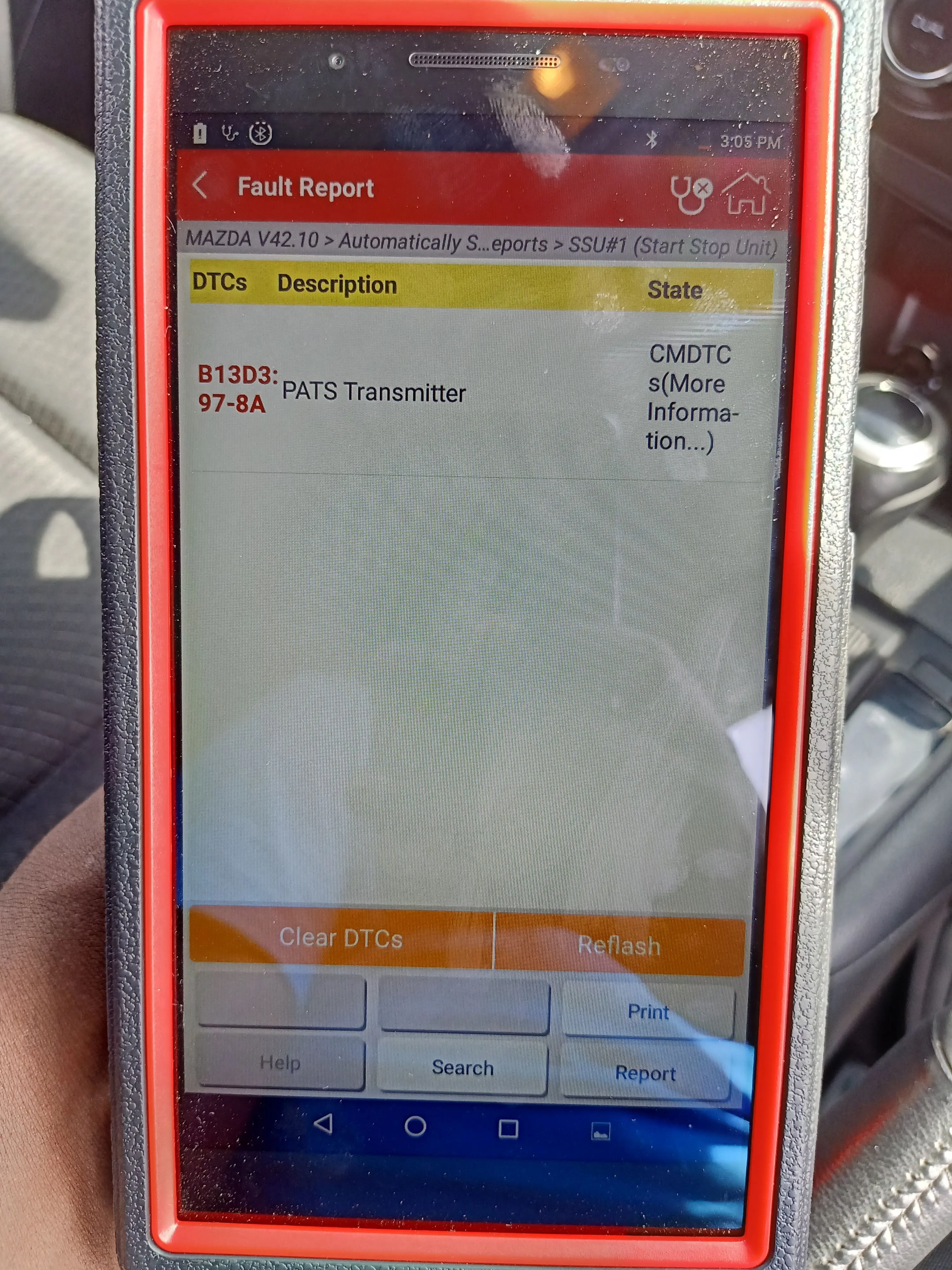

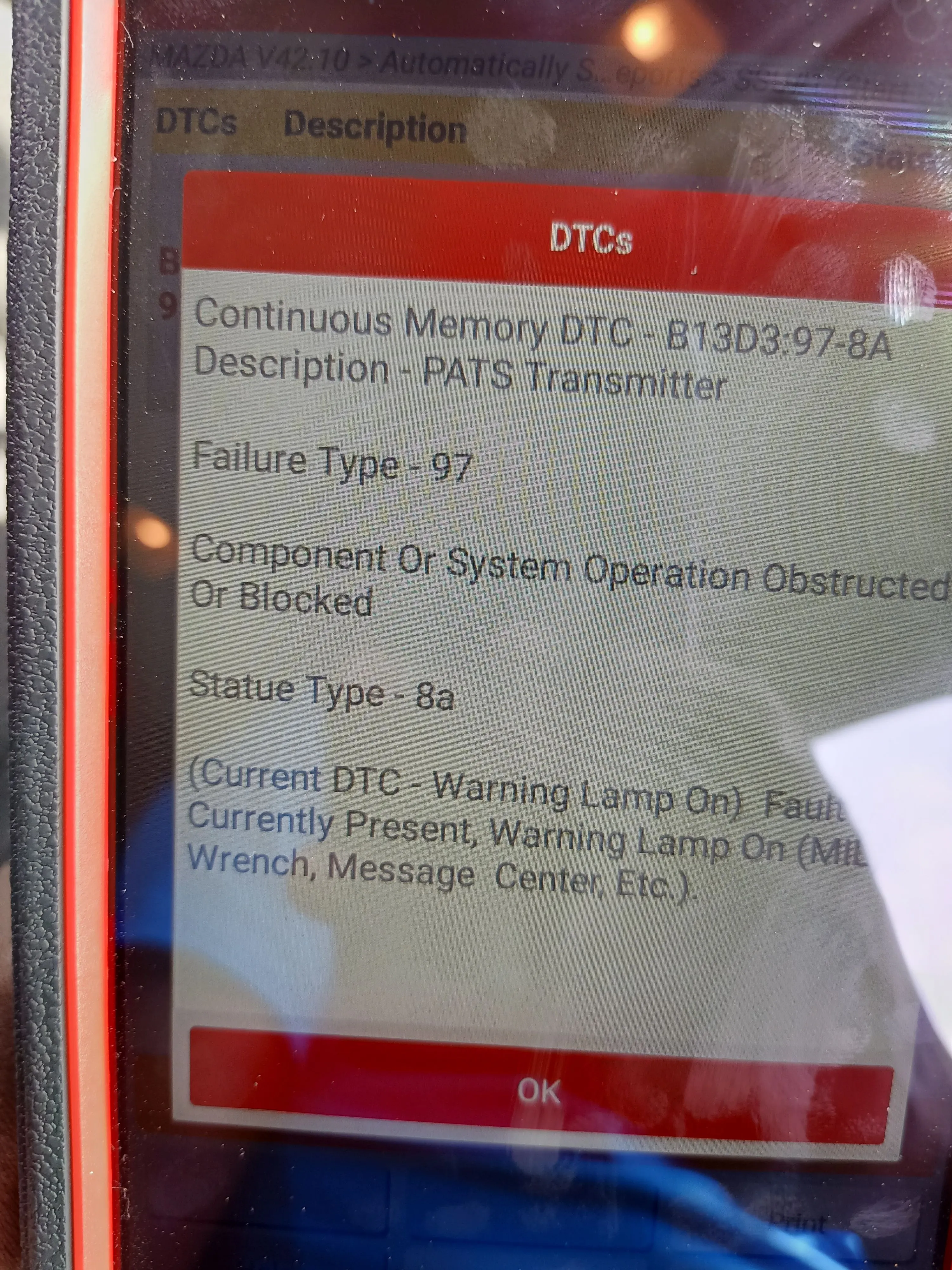

Hi Everyone,
Kindly note that I went to a garage and a technician messed up with my start stop unit. Am not sure what wires he tampared with, but I will attach the error code from the diagnostics. My mazda cx5 (2012, AFS and i-stop equiped KEAW..) smart key isn't working at all. As a result, the smart key can't lock or unlock the doors. The advanced keyless functions are also inoperable. Luckily, I can start the car by pressing the start button with my key fob. I have attached the diagnostics error code. Any advice will be appreciated. I am considering purchasing a new start stop unit.

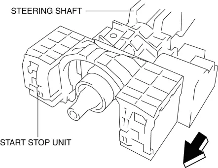

Thank you all. I solved the problem by replacing the entire start stop unit. The technician short circuited the unit which brew the microcontrollers on the start stop unit

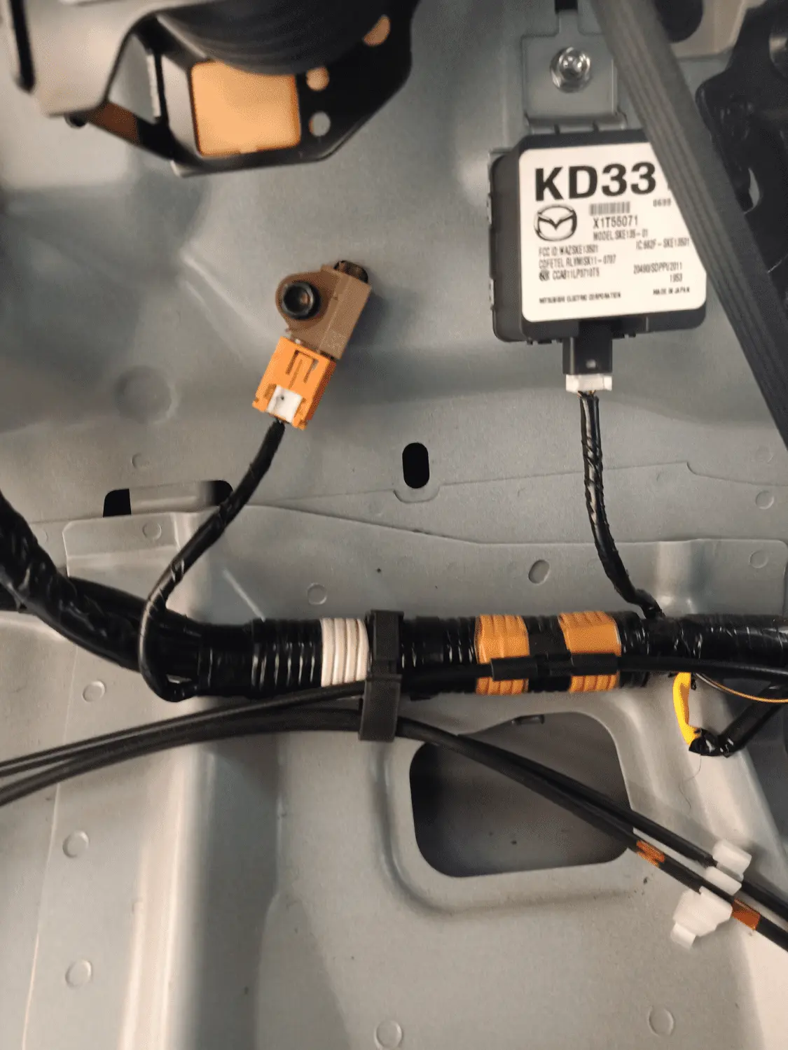

Even after replacing the SSU, I could only start the car by pressing the start button using the key fob. The problem was only resolved after I replaced the keyless receiver.

The shop started taking me in rounds, which I wasn't ready of as I need the car back to its normal condition. Subsequently, I decided decided to source for receiver and fitted it myself.
Tonynyam, what is the replacement procedure in that start and stop unit ? Do you have to take the whole steering wheel and airba etc? Did you have it to reprogram? I’m having some issue , the 2 keyfobs doesn’t recognize the unlock and lock for the car, dealer wants $1500 to fix it, dont have that kind of money at this time. any advice is greatly appreciated
