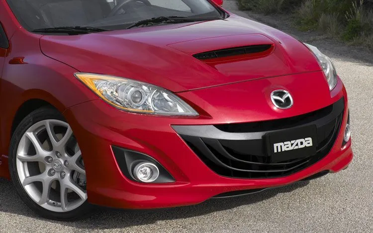

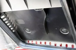

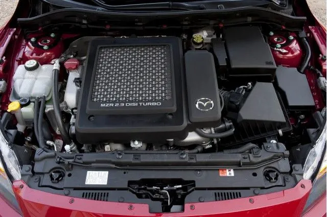

Take some pix, please, of the underside of the hood, so we can see the ducting and where that air goes. Here are the only pictures I could find on the net that might answer this question.
One is a close up of the underside of the hood scoop, but it does not show the areas around it to see if air can get over to the area in front of the battery box where the stock air box is located. It does show some strange looking oval slots that seem to send air out of the IC area to the rest of the engine bay. I'm not sure I'd want to lose that airflow to the IC, but it is interesting looking.
Another shows the front of the car with the the top grill slot very much lower than on gen 1 cars and in the direct pathway of the hot radiator rather than the engine bay.
The third shows the engine bay with the hood up. There are some small slots at the very front top edge of the engine bay, both on the left and the right that might let some air from outside into the engine bay, but I don't know what is above them on the hood.
All very interesting. All perhaps just academic in comparison to early design. But certainly different.

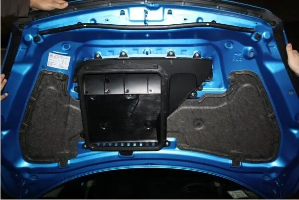

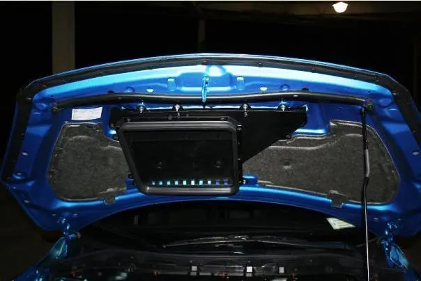

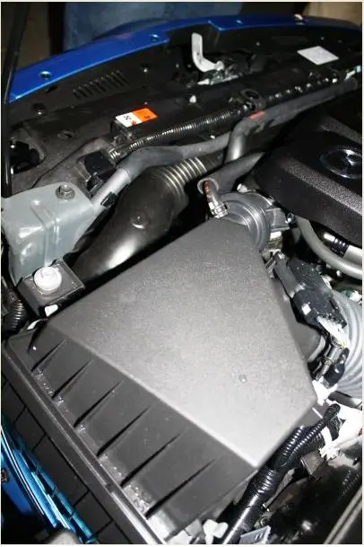

hey guys sorry i didnt upload these earlier. Attached are pics of the 2nd gen under hood ducting and intake.
Not sure if its visible but around the perimeter of the hood shroud where it meets the TMIC there are holes to allow air to "bleed" into the engine bay. Obviously any benefits for more direct airflow can be compromised by this design. Im assuming they are there for cooling/heat rejection. Also I attached a pic of the airbox. Note the black hose w/ accordion style ribs. It seems that it pulls air from the front of the car just above the smile. It is by no means a ram air system as the tube has to many bends and turns to allow good flow.
