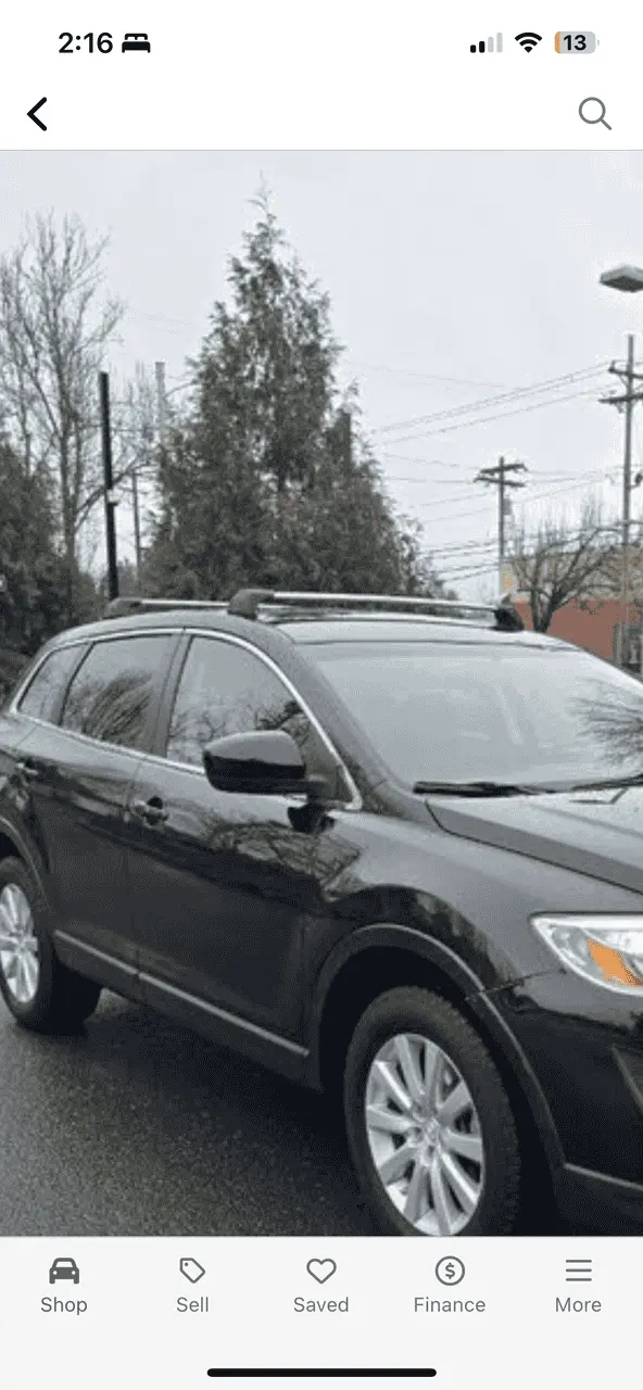

I’m trying to figure out if my 2009 Mazda CX9 needs rails or if I can just purchase crossbars to go directly on the vehicle without rails . I’ve seen various styles. I attached a photo of one with only crossbars and no rail for reference.
*to clarify it currently doesn’t have anything*

The issue with the ones on the photo is how low they are to the roof. There is a good amount of curvature on the roof. And the mounting points are pretty far forward and to the rear. So your load on the bars may hit the roof. You just need to make sure that what you plan to put on these bars will fit (be high enough to clear the roof and long enough to reach both bars.)
Compare the location, distance and height of the bars with the rails and without the rails, and see what fits your need. It is possible that the rail be required to get the bars closer to each other to mount standard accessories. (Bike rack, cargo baskets, etc)
And an example of how much closer the cross bars are with the mazda rails: on the photo in that link
