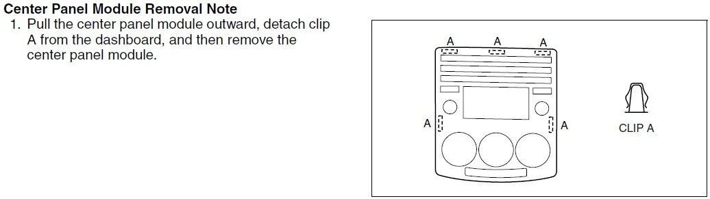

You can just pull it out:
Well, you have to remove the two screws at the bottom (and before that some other panels), but once you've done that, like the OP has, you can just pull it out.
