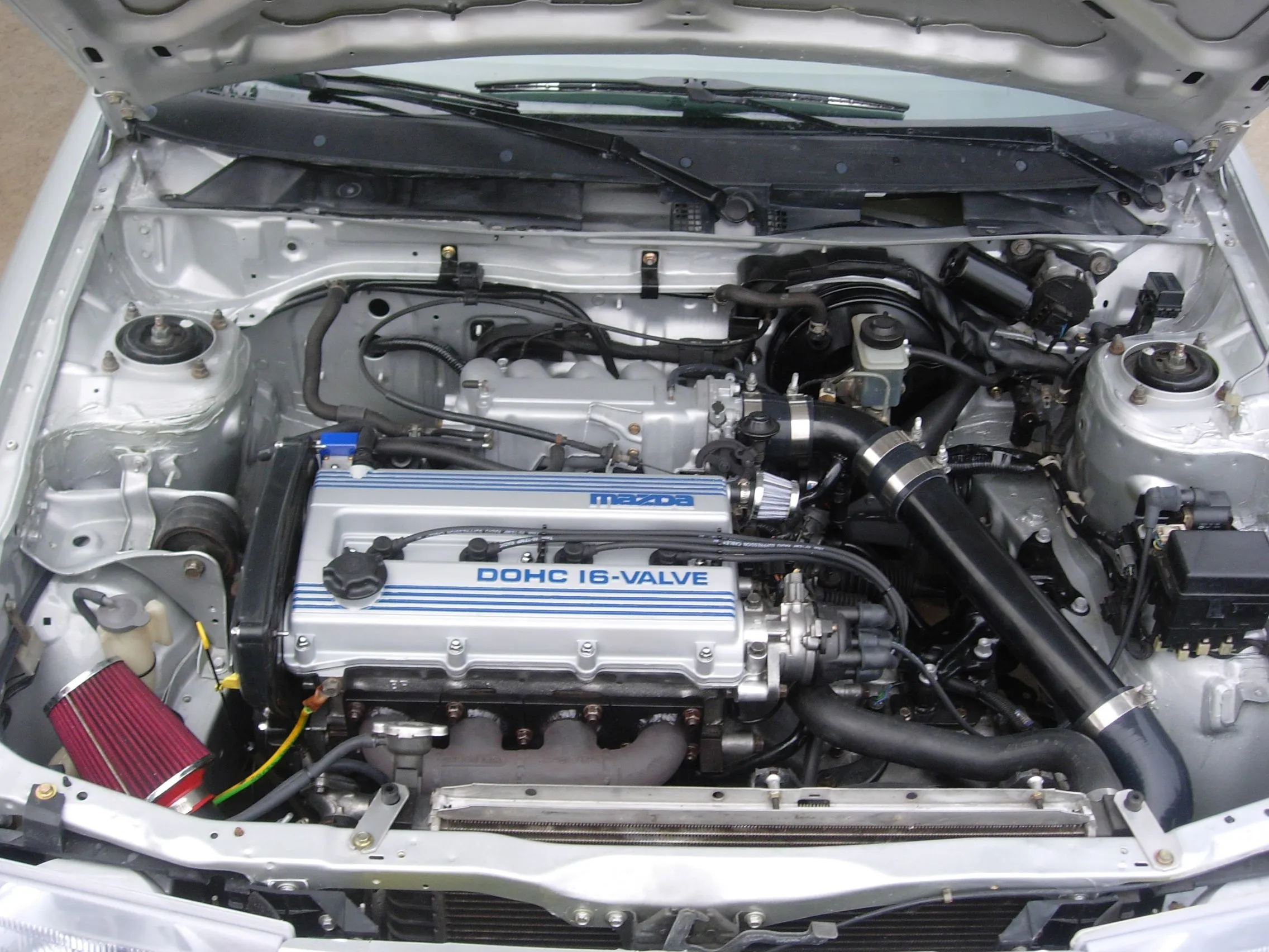

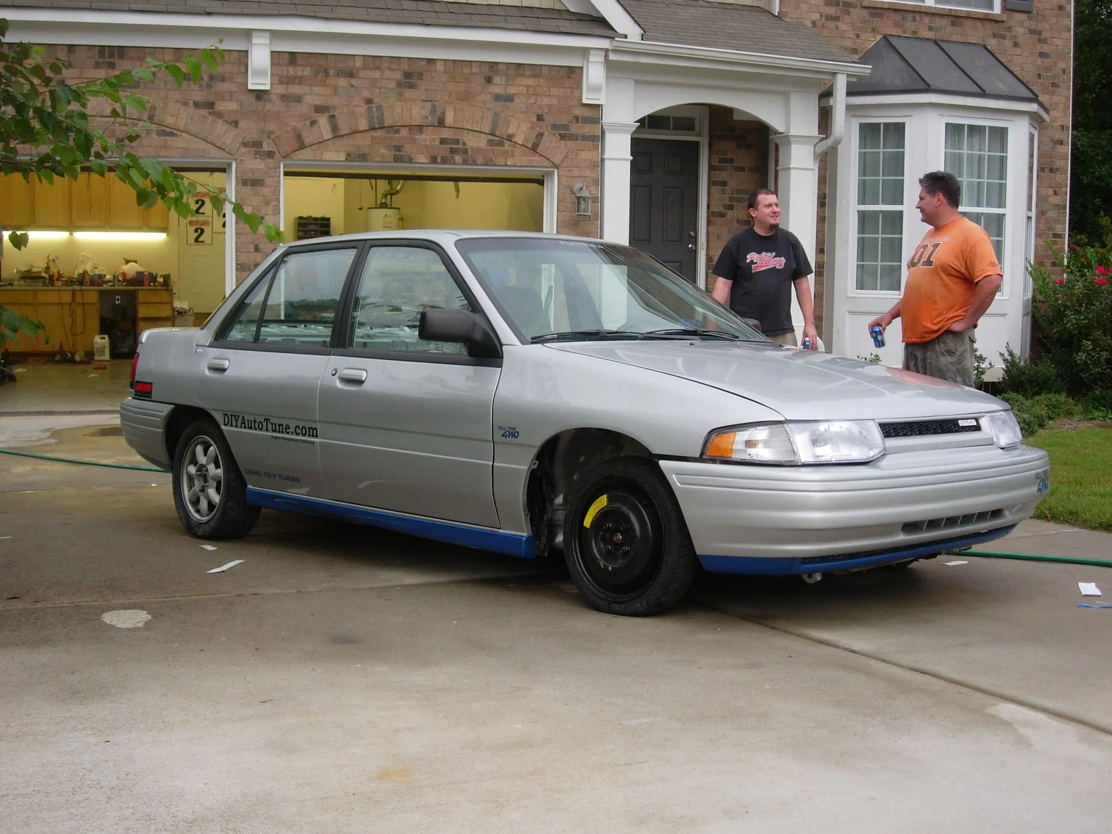

The $2009 Challenge is only 4 days away and for once, I'm actually ahead of schedule before the event (knock on wood that it stays that way). The car has been wet sanded, corner-weighted, and in general, combed over. I've also cleaned up the valve cover and intercooler piping, rerouted some wiring under the hood, and moved the battery to the back. Boost control is now enabled, so I should see 15-16 PSI on the drags :).
I have cross weights dialed in to 99.7%, front to back weights at ~60/40%, and left to right to ~52/48%....not terrible. I still need to finish the alignment and am a little worried about the bump steer that I'm seeing just moving the car up and down, but we'll see what happens with that. All in all, things look great.

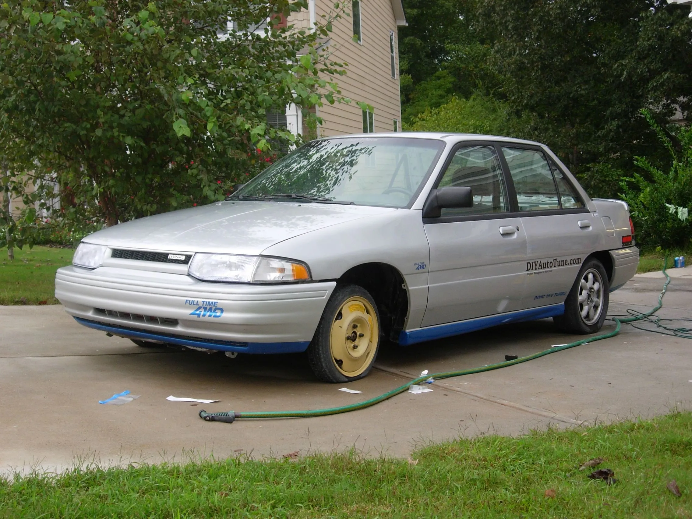

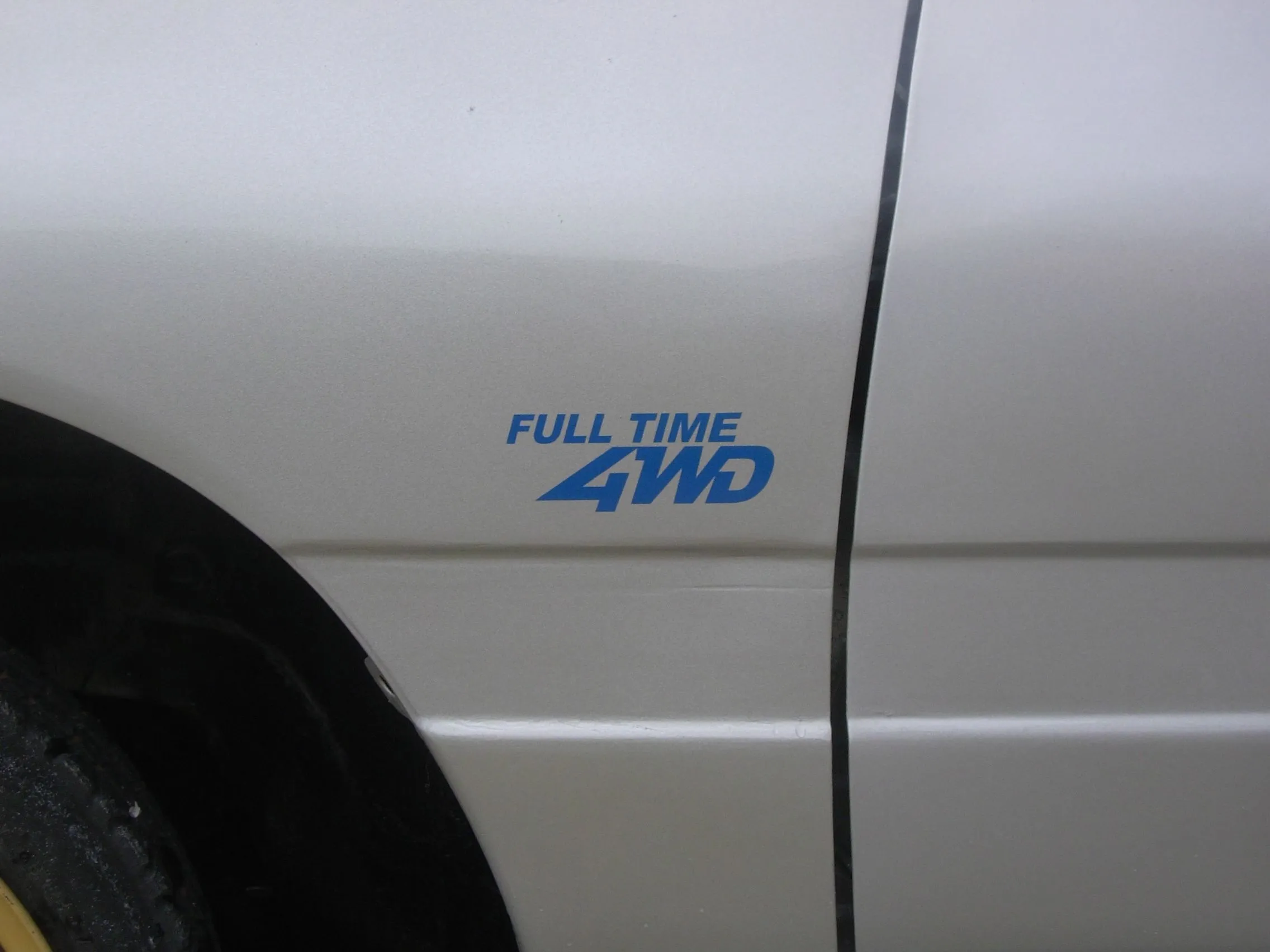

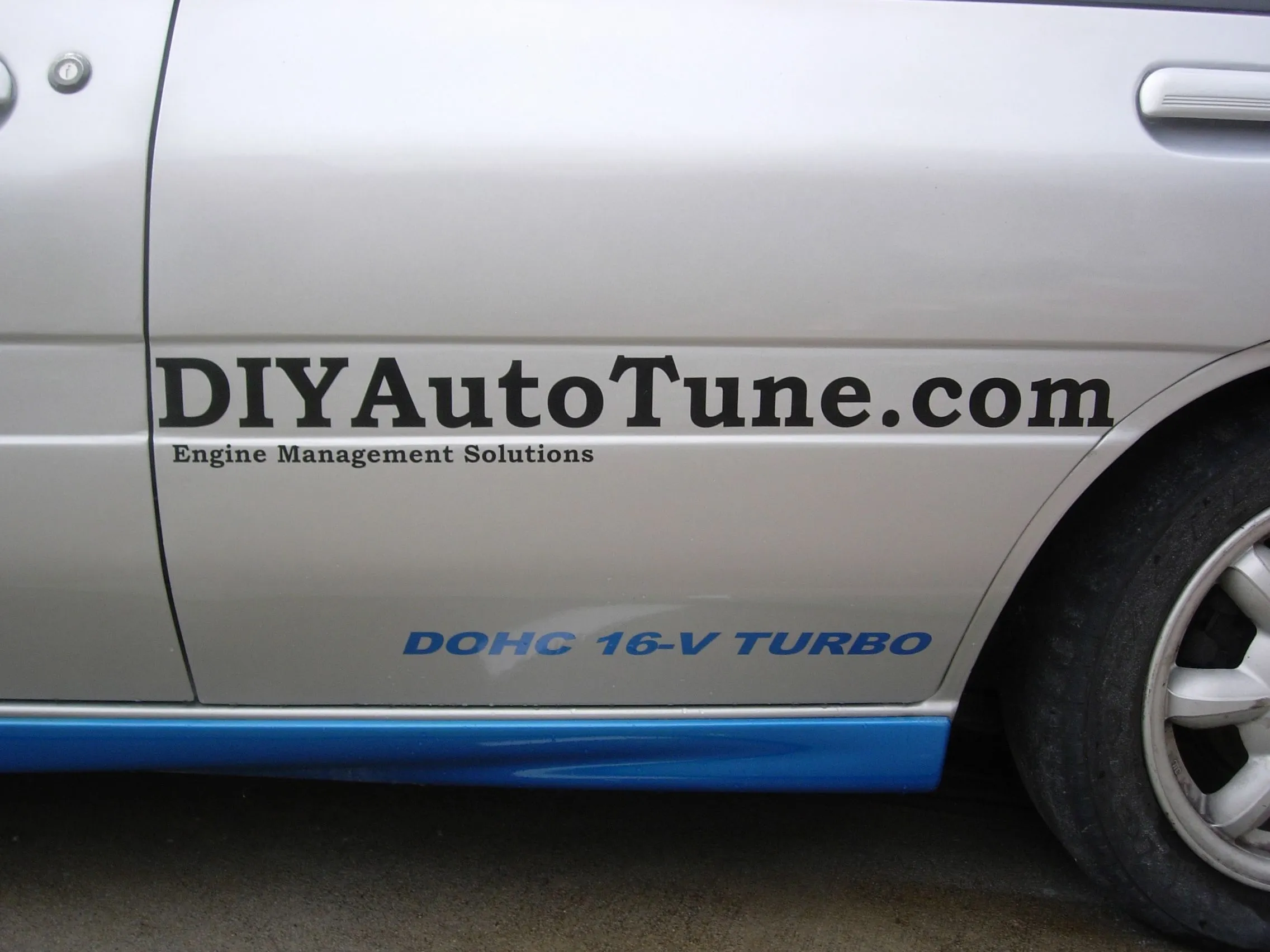

I've added some vinyl to the side's of the car as a throw-back to the old GTX. The cuts were directly modeled after the actual "4wd..." and "DOHC..." found on the GTX.

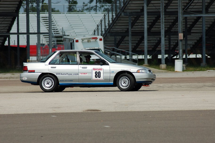

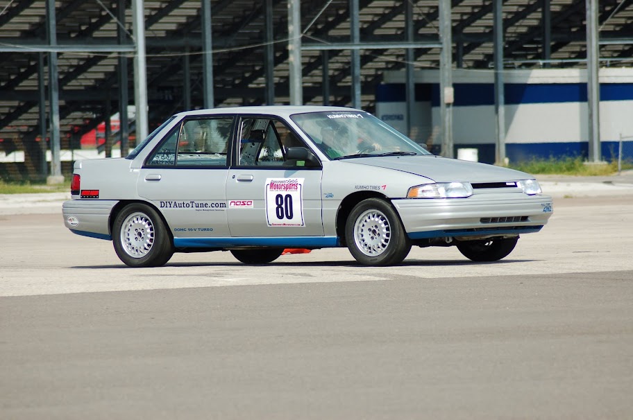

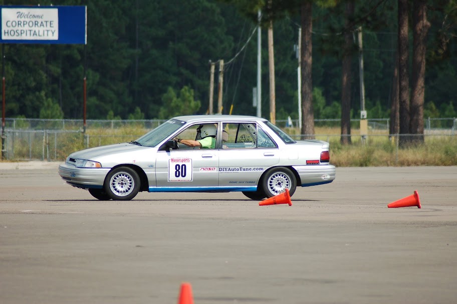

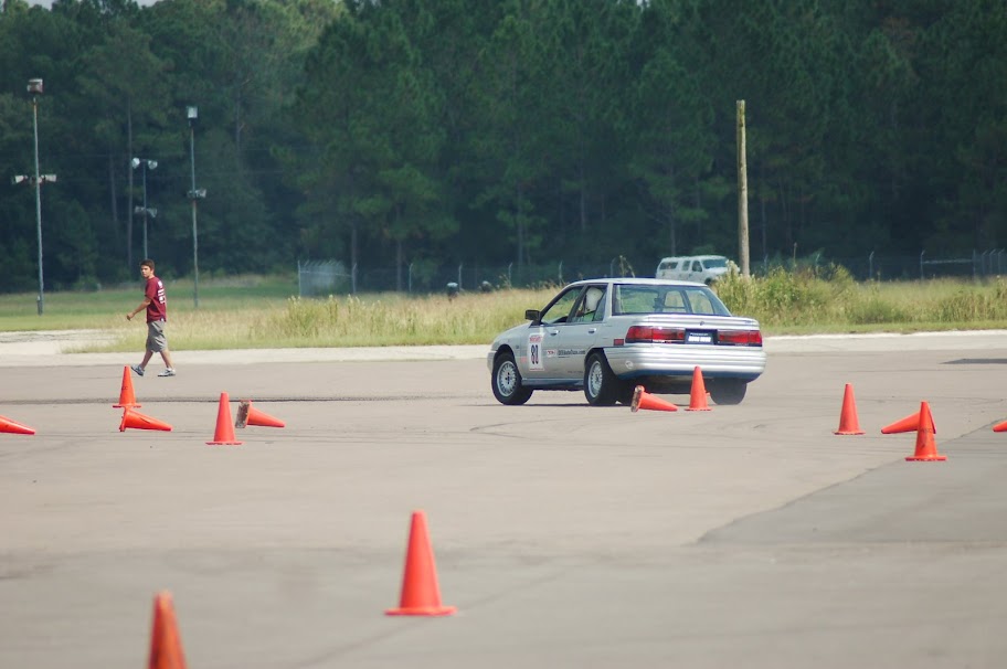

Another Challenge is in the books and I think I did well, all things considered. The car was slow as hell through the auto-x and most of the drag. Power delivery issues plagued the weekend, but fortunately, no issues from the drive line which responded well.
Poking around through the day of the drags, I found a few things out of kilter starting with a vacuum leak at the ECU. That fixed, things didn't improve. I tightened up the waste gate actuator as boost was building very slowly. Things still didn't improve. Finally, I put a timing light on the engine and found that I'd lost 10* of timing. I measured 8* of base advance when the MS thought it was at 18. A quick adjustment of the dizzy and boom, 2.5 seconds off of the quarter mile (which wasn't impressive anyway).
In all, I finished 16/53. I'd have been deep into the top 10, maybe even the top 5 in the auto-x had I discovered the timing issue before hand, but I digress.
The event was an absoloute blast as always. I have one more left in the Tracer before I retire it from the Challenge, yet, I have a number of ideas that may bring it closer to the cover. Lets hope that it all comes together :).
Below are a few images during the auto-x. The car is at least well composed.
