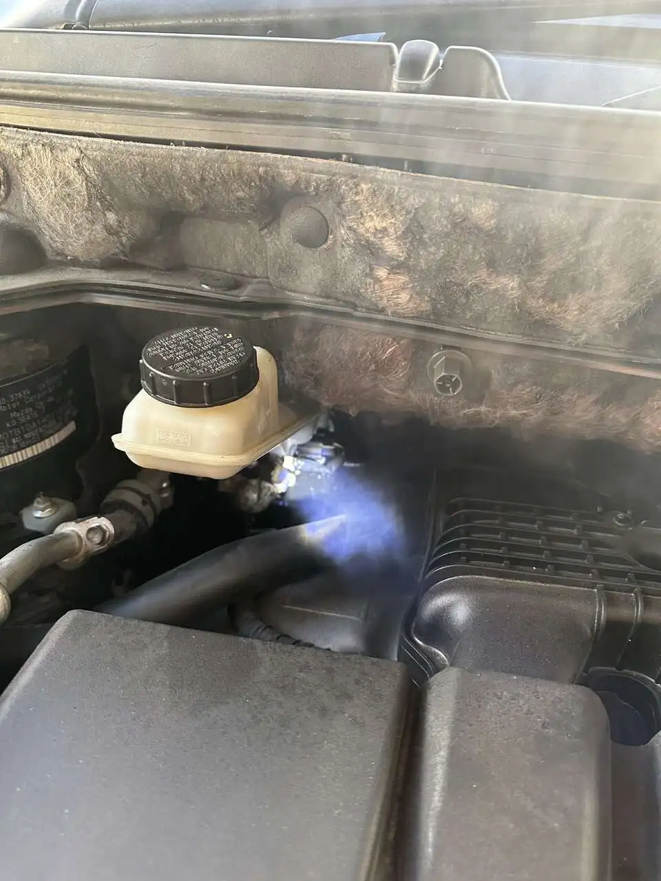

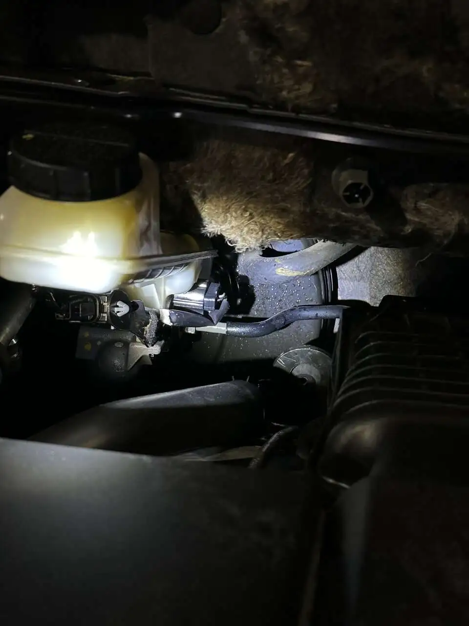

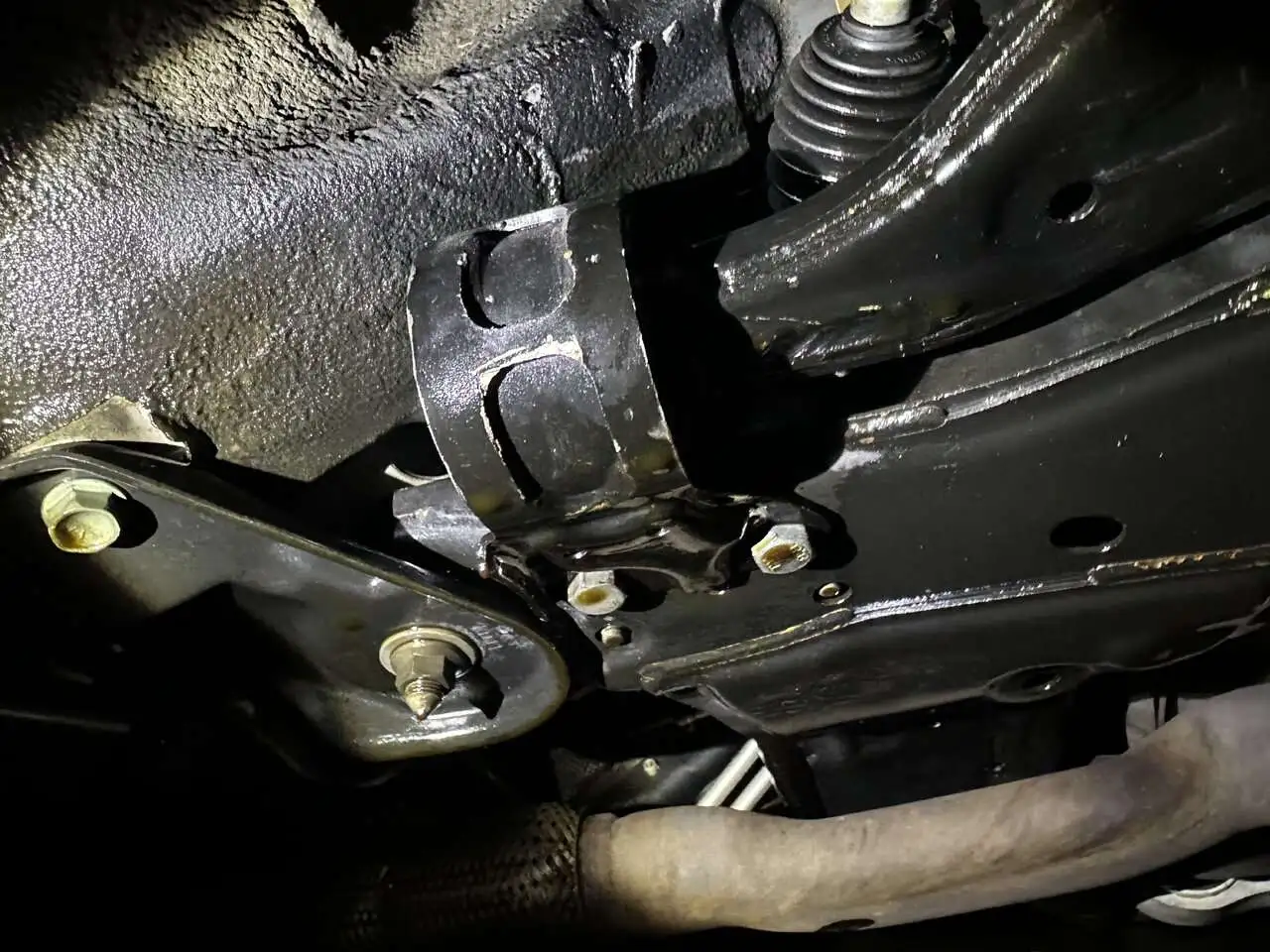

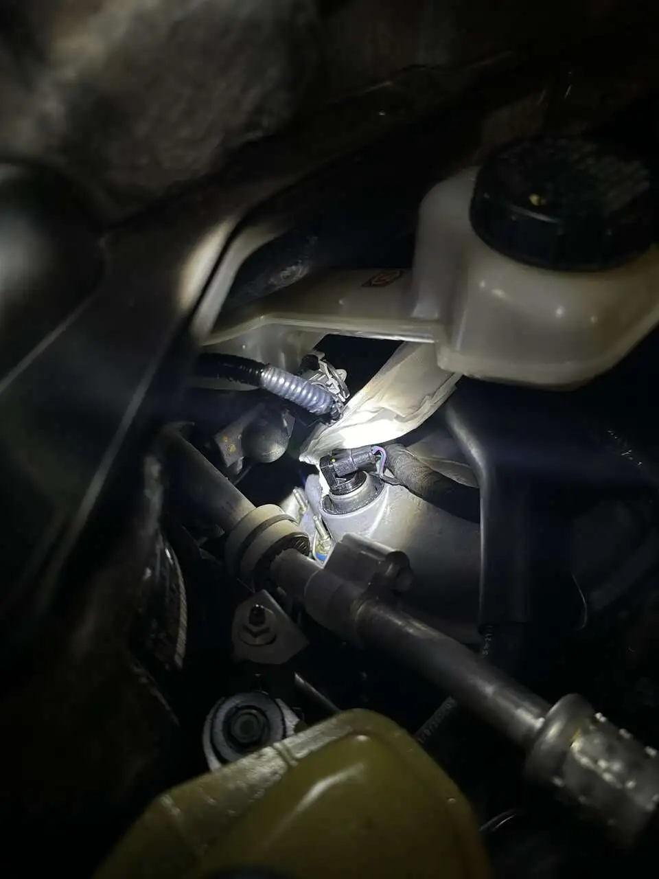

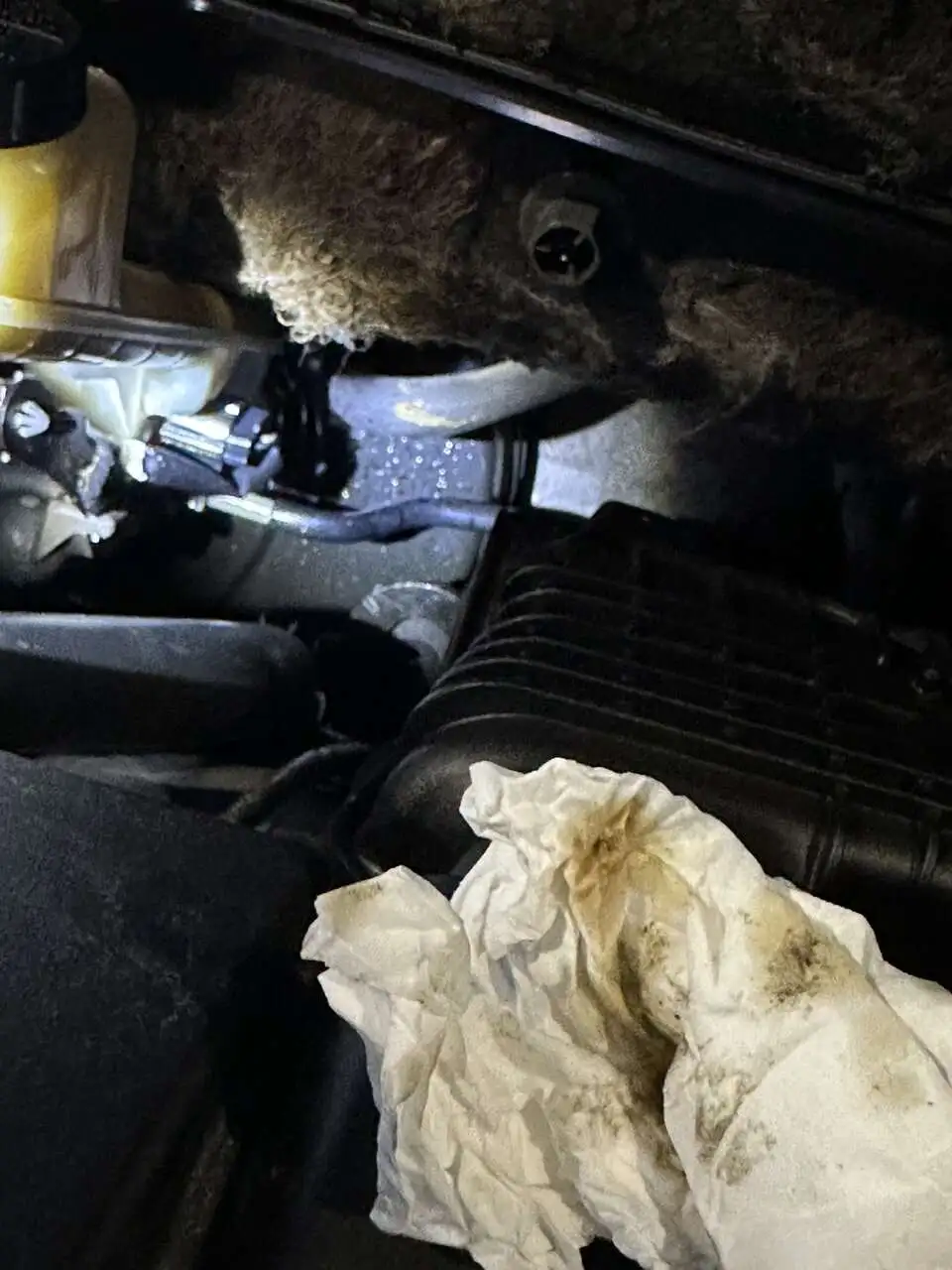

Hi, I got a problem with my Mazda CX-9 2008..
There are oil leaks near power steering and the oil dripped down to the bottom of the car (See Picture)..
and sometimes it coming out a lot of smoke on the engine because this oil..
Anyone have a same issue like me? Or know where the exactly the leaks from?
Really need your help guys..
Thankyou.

It's very difficult to tell from those pictures what's going on because they are very dark. To find the leak your best bet would be to clean that area with brake clean so you have a clear view as to where it's coming from.
Given that it's coming from 'up top' by the looks of it the likely culprit is the valve cover gasket. But without really cleaning it up to get a good diagnosis that's just guessing.

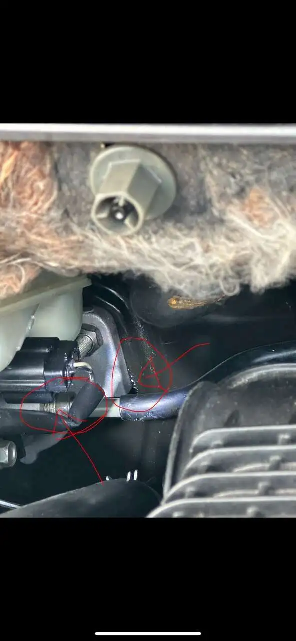

Anyone know what is that part called? (See Image)
I found little oil leaks from that i pointed with arrow on the picture.
Is that normal?
Please advise, thank you.
