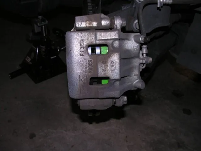

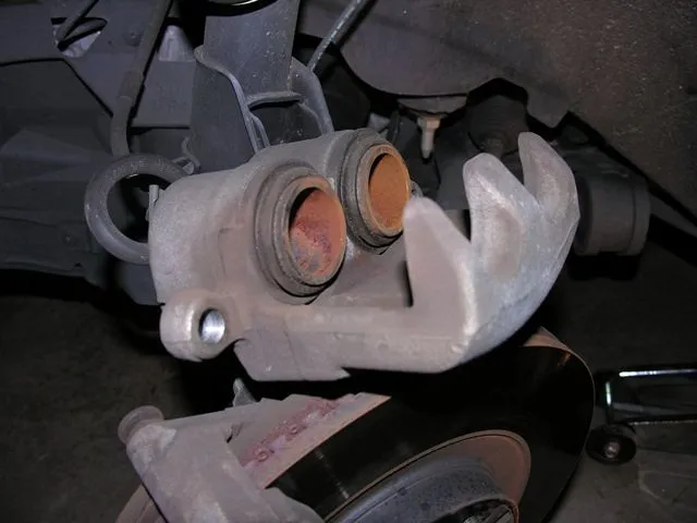

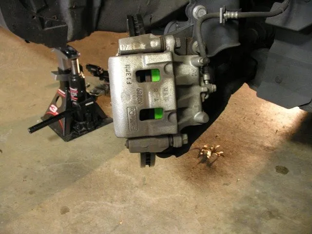

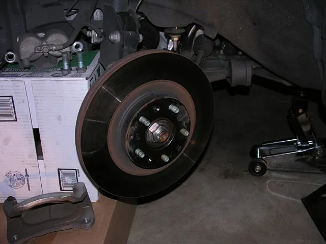

Completed the front rotor change over, here are some pics

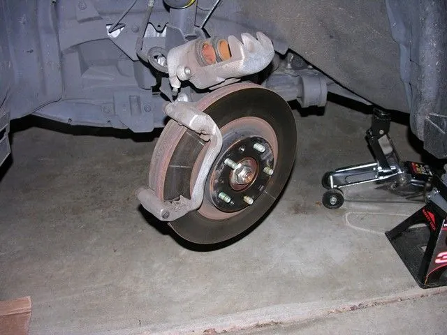

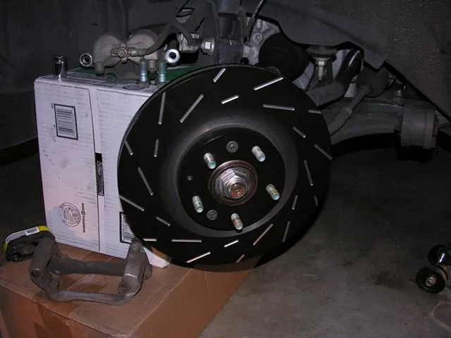

A couple more

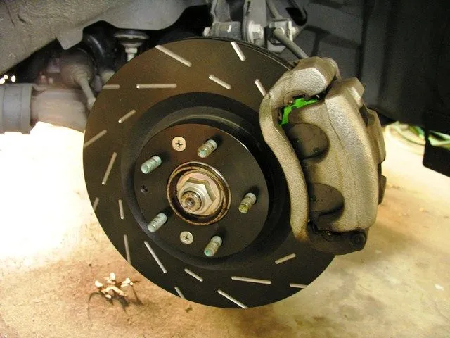

and a few more
