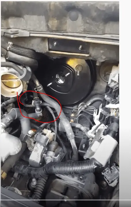

Hi All,
Working on removing and replacing a bad brake booster. Could someone help identify the 90 degree connector (part no.) for the coolant line, circle in red, in the attached photo? I broke it by accident while trying to remove a couple brake fluid lines right under the brake booster.
I need to get this replaced. Also I can't seem to remove the broken connector as well, any hints would be great.
Thanks.
-destroyer88
Note: Picture was a capture from google search and mine broke.

Is that something that could be replaced with a generic hydraulic hose elbow? You'll need to know the inside diameter of each hose and if the elbow's ends that go inside the hoses are a standard hose barb.

Hi, I had the same problem and all I did was slide the hose over the pipe and put a clamp on it. Its been 2 years and no problem so far.
