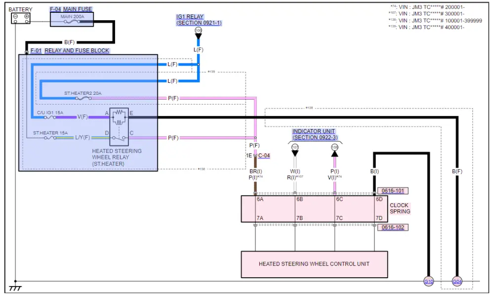

s0n1c, have you scanned it for any B or U codes? Some AFS (Adaptive front lighting system) faults trigger codes.
Also, unsure if this helps for steering wheel heater.
Am I reading this right that there are three fuses in play for the heated steering wheel?
