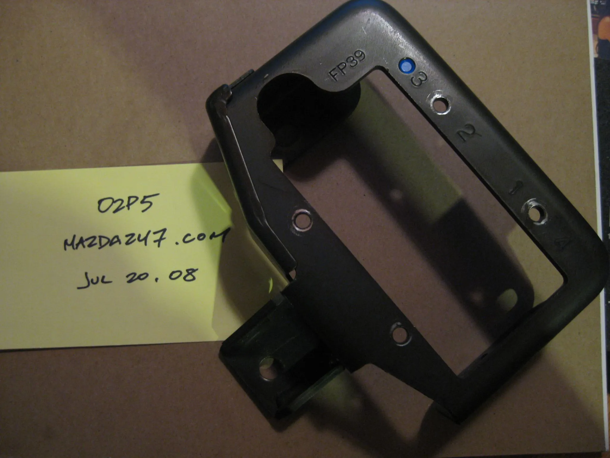

I did this install and the car feels a lot smoother and responsive. Really good modification IMO.
However I didn't use the Coil Bracket part# FP47-18-105 so if anyone needs it let me know.
I'm planning to let it go for free but I'll need you to pay for shipping should be around $5 anywhere in North America. I'm paypal verified as well.

pix... where did you bolt it to then if u didnt use the bracket?

Yes, wii B pic hoze upinheeya! Did you do it to keep them away from heat above the exhaust manifold/hdr or so you didn't have to strip the coil leads from the loom to hook them up?

I was able to attach it near the intake manifold area and didn't need to use the bracket. The wires were able to reach that location and it's much cooler in that area. I wasn't able to put it where it supposed to go because my turbo manifold was in the way.
Yes, had to make a minor cut on the loom for the install. Used some electrical tape to wrap it back up after the install.
I'll try to post pics soon.
