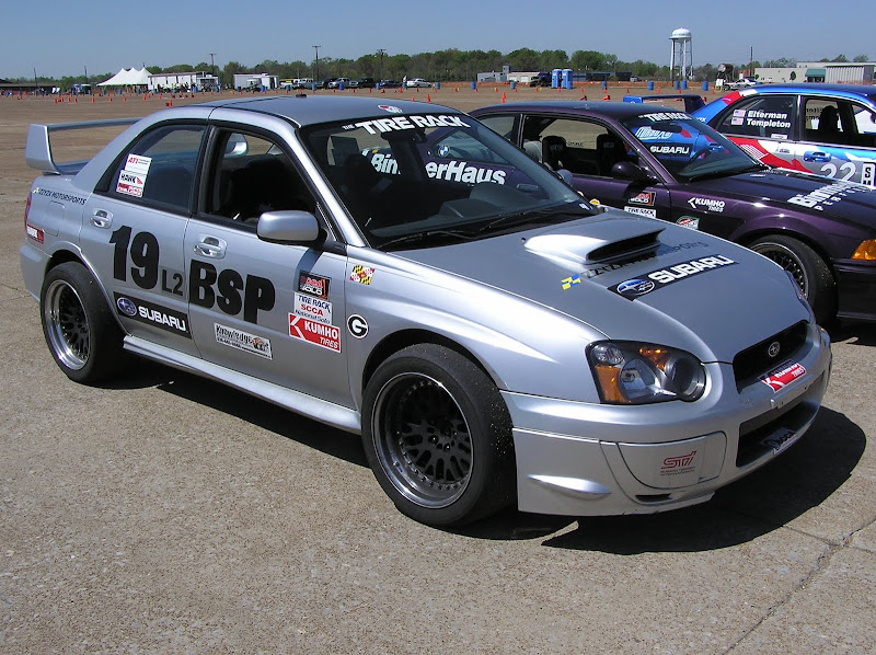

at least it doesn't look like this:
By the way, I know this guy and this car. It's called "Stompy."
I know stompy as well. We have sold him some parts for his Subaru.
