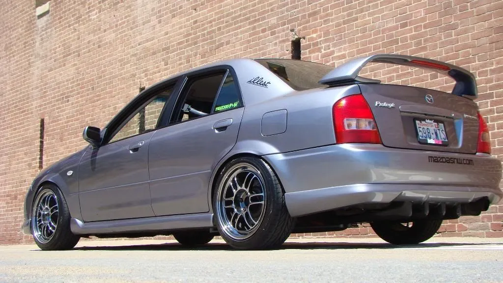

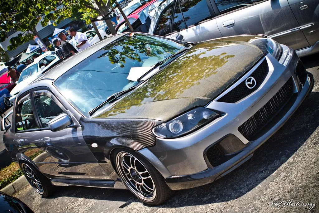

You may be able to find more photos through google but here it is. His name is Swirlfx. These are 17x8.5 +30 w/ 215/45/17
