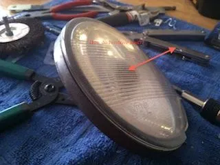

has anyone attepmted to remove the lens from the foglight housing?
If so How...?
Can ot be done?

I want just the lens part removed from housing...Has any1 seperated the glass lens from metal housing/

I think he wants to remove the lens from the reflector, and if thats the case your probably gonna have to bake it in an oven
screw broke
One of the screw in the back was broken and i tried to extract but was unsucessful at doing so....I just need the glass lens from this part to attach to another fog light backing..that has to good screw to hold the lens. Other wise i can nevr replace the bulb in the the one that has broken screw in it..
So how would I bake light to remove the lens?
200 degrees for 10-15 minutes...or google baking headlights. The fogs are different though in that they are glass.
