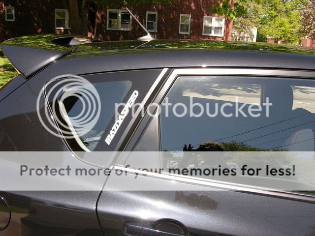

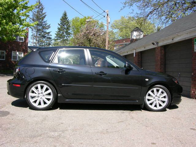

I just switched to the meguiers gold class and it seems to be holding up a lot better and it applies and comes off easier. I also used a random orbit buffer for the first time with the gold class so that could have something to do with it. Don't get me wrong zymol is a great wax, but it just doesn't last. If you use it make sure you take it off or do the final polish with a damp cloth. Otherwise its impossible to get it to look even because it makes the paint look darker in some spots. My car is black mica by the way so its hard to keep really shiny. Here is a pic of my car after a polish and wax with the buffer and gold class wax.
and another
I was also able to get out light swirl marks.
I would suggest getting a random orbit polisher. I got one from sears for $25.00 and it makes waxing a lot easier and produces much better result than a hand wax.

You can't go wrong with that as you can see from the results on my car and that is a week after I waxed it.
