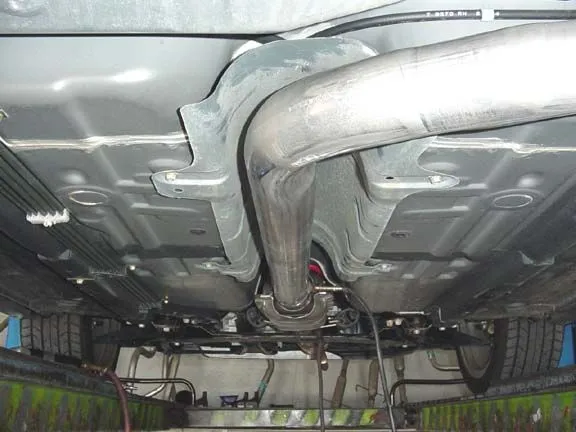

so joe,
now with your free flow cat, do you use the stock o2 sensor in the same place as before ?
Kind of.. With my 3" exhaust, the cat is now after the crossmember/brace instead of under the motor, so I had to extend the O2 sensor wires to put it after the cat.. If you are familiar with what your exhaust looks like, you can make out the relocated cat in this pic.
Joe
