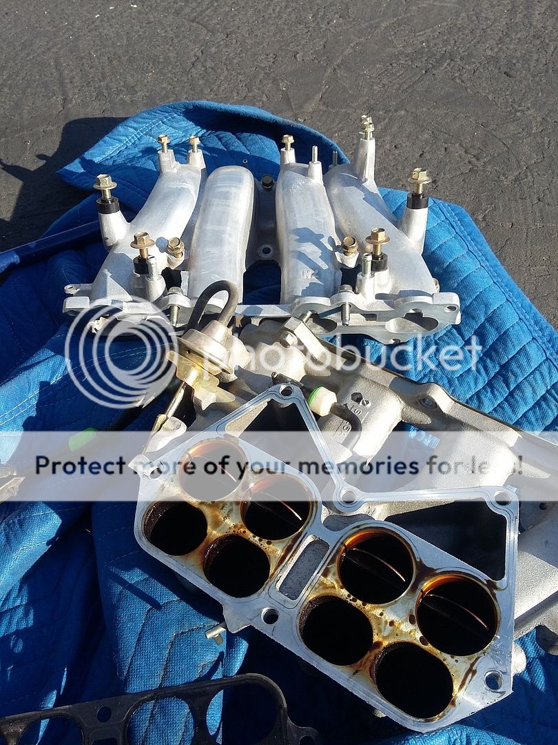

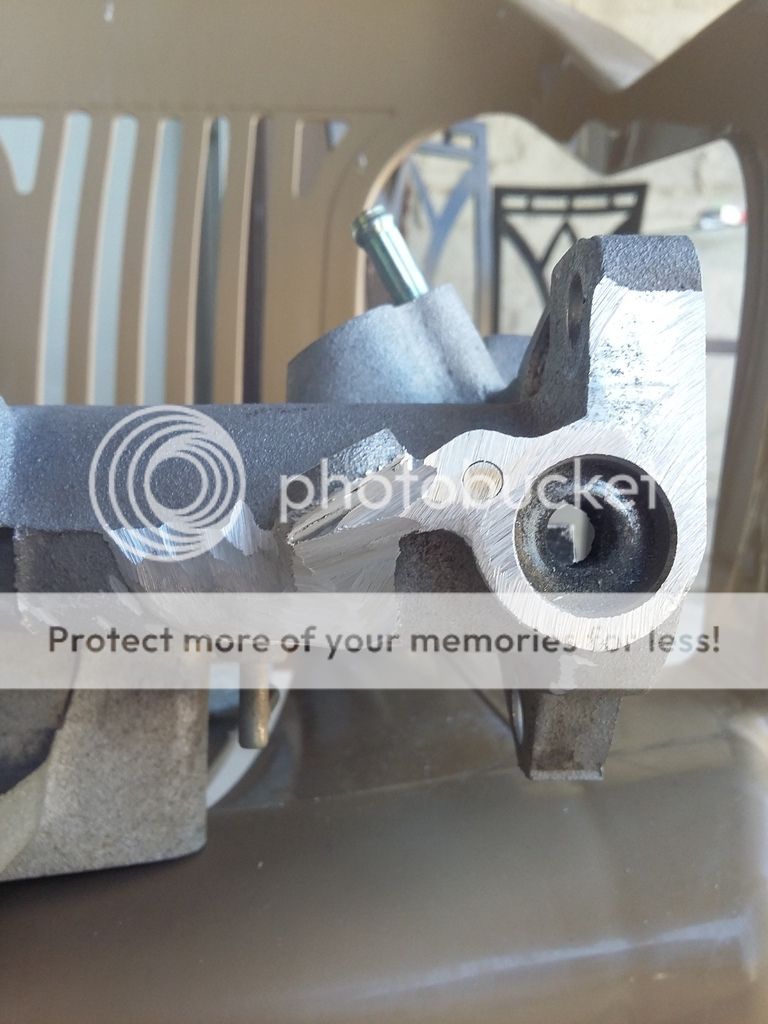

CDM grill, JDM cupholders, MP3 splitter, JDM console extension, GT Spec everything - Trailing Links/LTB/FR STB/RR STB/Ladder Brace/Vbrace/Reinforcement panel, JDM footwell lighting kit, HID projector retrofit headlights, MSP door sills, MSP floormats, MSP/MP3 pedal covers, HID oem fog mod, cut off VTCS rod even with first IM runner instead of doing screw and having dangling actuator, MSP ECU even if no turbo and if manual trans, MSP VC with engine cover................I'm sure I missed more.
