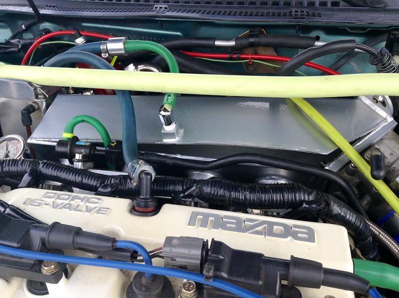

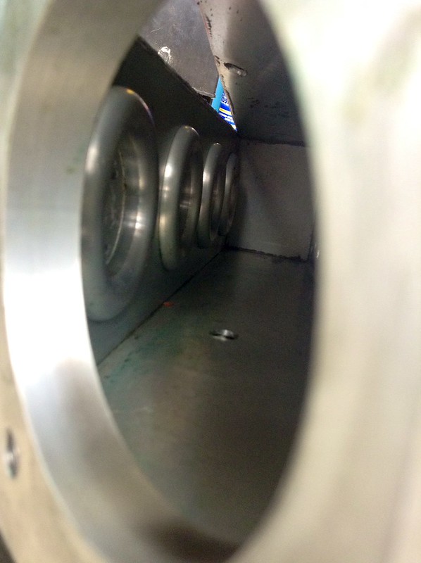

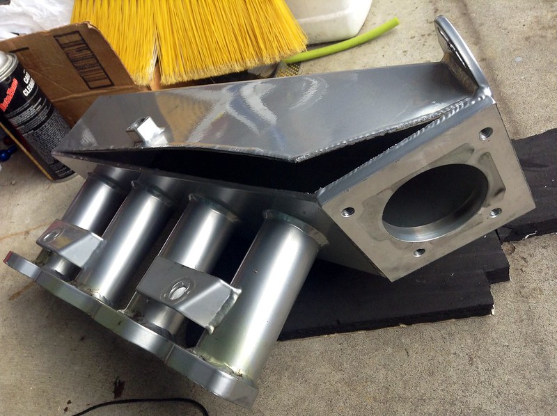

i was racing at a time trial event this past weekend, and this happened:
photo.JPG by Jason D., on Flickr
good news is that rich/505 responded quickly and will fix it with extra bracing so hopefully it doesn't happen again.

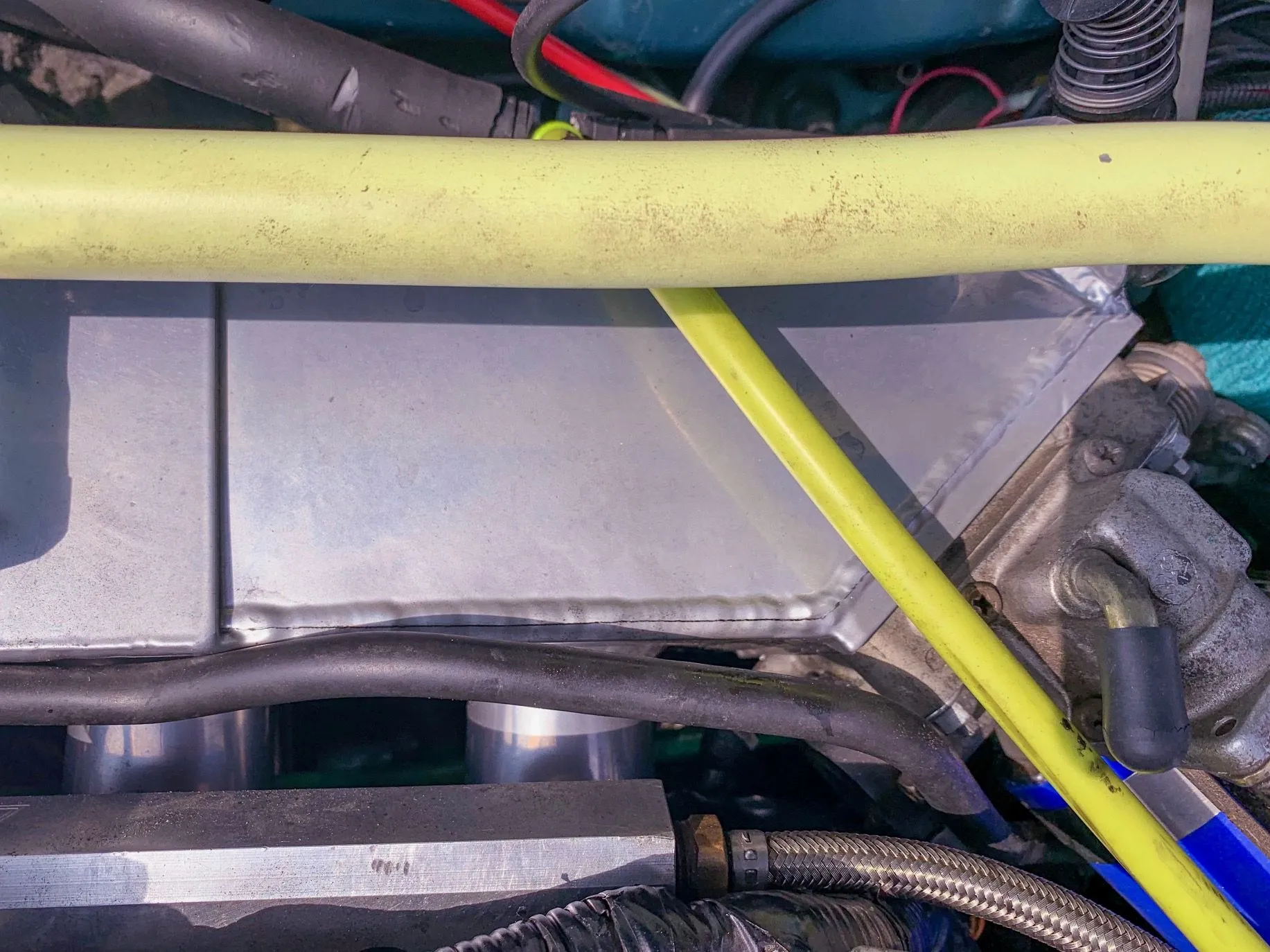

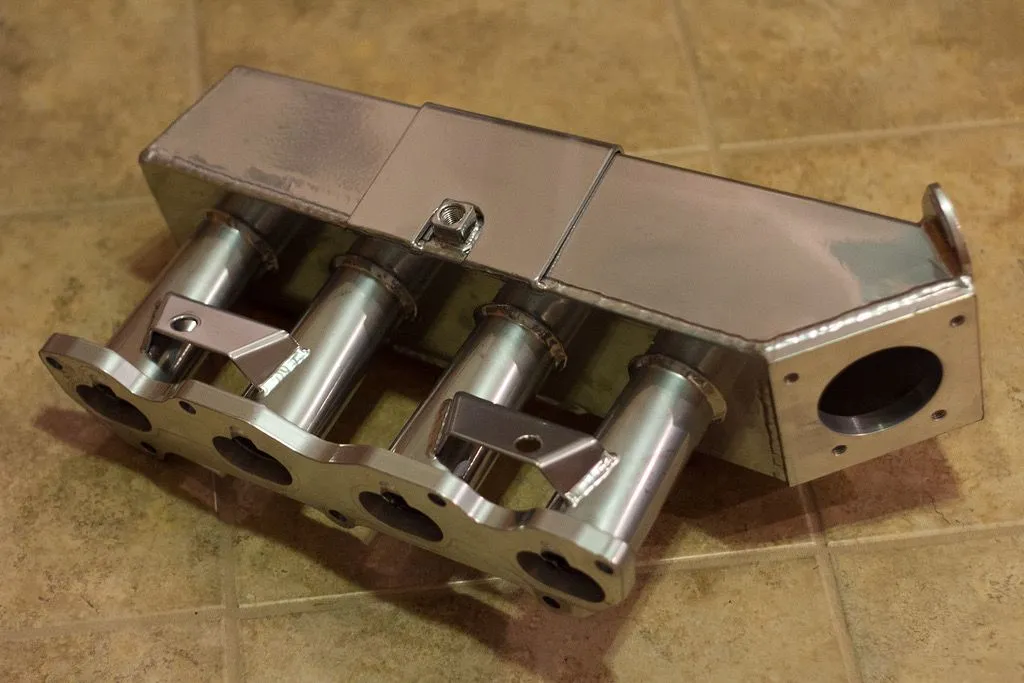

i got the manifold back from rich (505) in december of 2013.
attachment.php

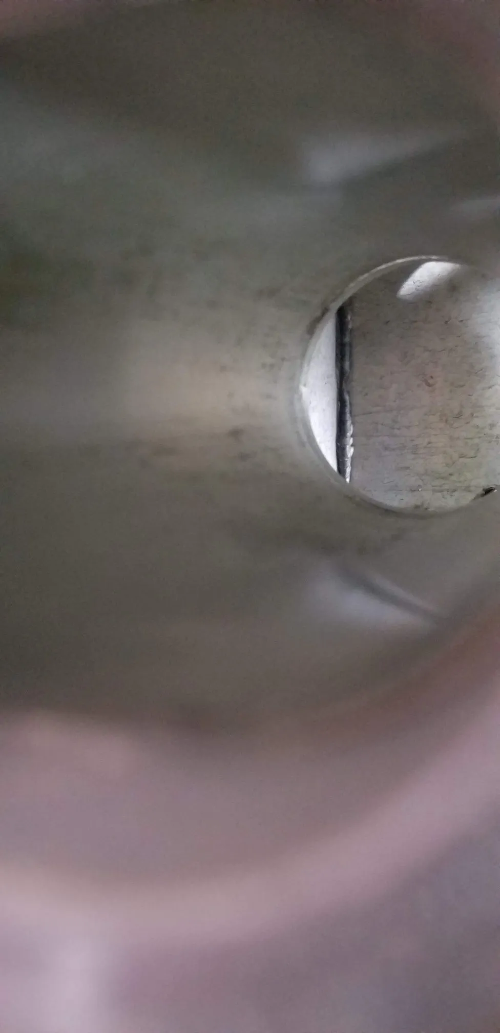

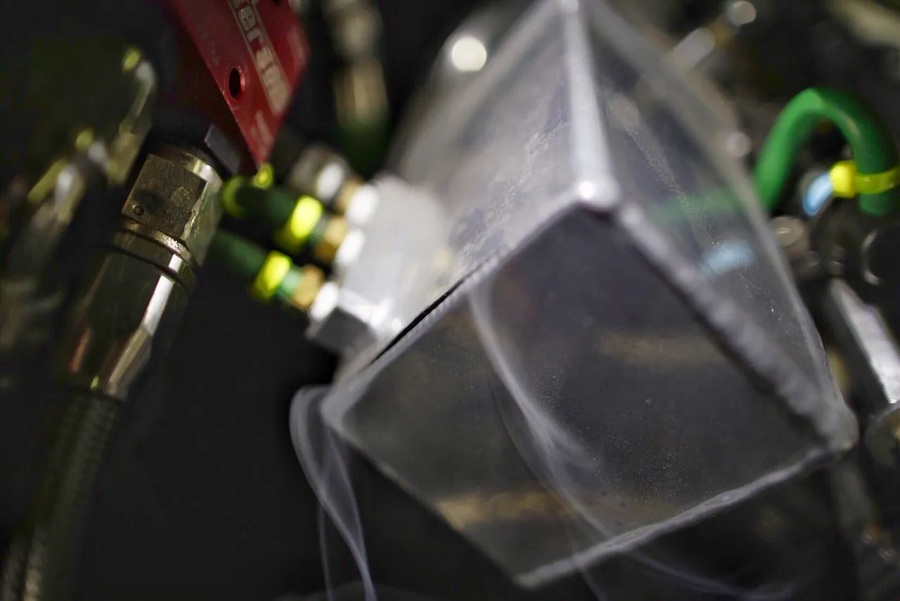

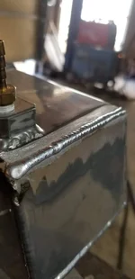

a year or two ago, i noticed i wasn't peaking 26.5 psi anymore. did a boost leak test and the car was barely holding half a psi, but i didn't see anything obvious. used a smoke leak detector and found this.
attachment.php
not sure how long it had been cracked since i rarely drive the car. messaged 505 and never received a response. luckily, i have a friend that can weld aluminum. he also welded that section from inside since we both noticed the original welds didn't have good penetration. didn't weld the rest of it from inside since the bracing was supposed to hold it all together.
attachment.php
attachment.php
installed this manifold in august 2019. drove the car all of last weekend and it cracked again in the same spot as the first time.
attachment.php
this time i'm going to have the manifold rebuilt with thicker walls, or have a gusset shell to go over everything. all i can say at this point is good luck and be careful to anyone else running this manifold.
