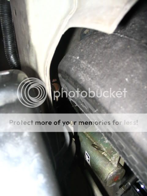

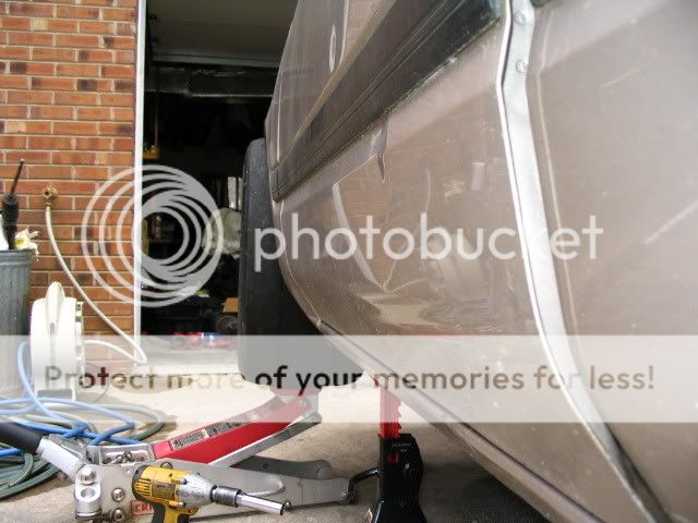

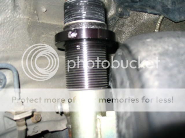

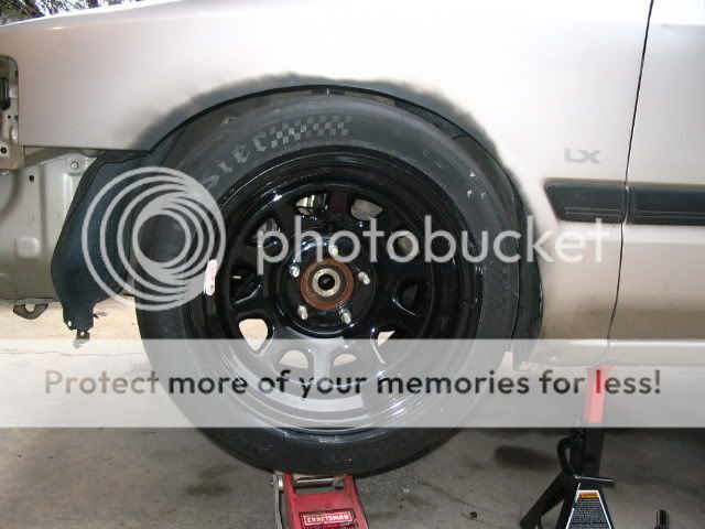

Lots o pics update...wheel/tire fitment
The first two pictures are at full droop on the strut. The rest were taken with the spring removed so I could put the strut at full compression (on the bumpstop). I had already cut about an inch out of the fender for clearance.
These are with the 15X10 rim spaced out to mimic a 6" backspacing. There is some slight rubbing of the tire against the body at full lock/full compression. Basically the outer edge of the tire hitting the body just in front of the door. I believe the CSP Miatas hit in the same place. It shouldn't be an issue since the car should never be at full compression on that particular strut with the wheel at full lock.
wow, that's freakin ridonkulous. I love it! What wheels are those?

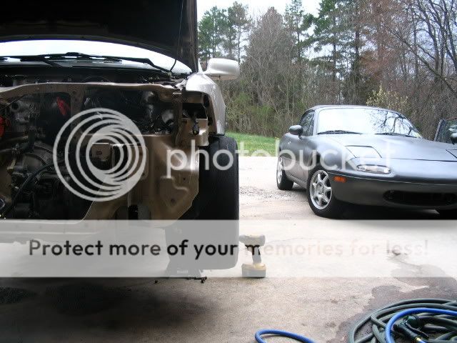

Oh damn... that is HOT! Who's Miata is that in the background btw?
it looks great in that gray color.
That's my girlfriend's. It's a '94 R package. It's spray painted gunmetal (previous owner). Looks pretty good from a distance. She is thinking about getting it repainted in gloss black. She'll be driving the Protege in FSPL this year.
The wheel on the Protege is a Diamond Racing wheel. It's just my test wheel. If you notice, it's a five lug. Luckily the Protege5 hubs fit perfectly on the 1st Gen, but they are way heavier than the stock spindles. I'll be ordering the correct 4X100 wheels soon.

it looks like your tires are going to hit your strut body, once they have weight on them, it'll bulge the tire to the point it touches...
EDIT: I'm probably wrong, so disregard.
The picture makes it look a little closer than it actually is. There is at least a 1/16th of an inch between the strut and the closest part of the tire. That part being near the bead so it should flex any. If I do run into any rubbing issues it will be very minor and I'll just grind the threaded part of the strut down a little to clear.
