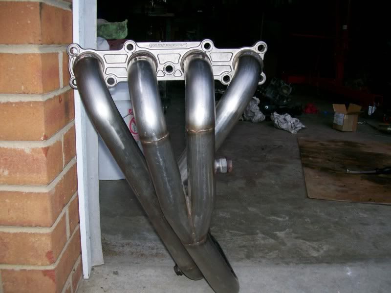

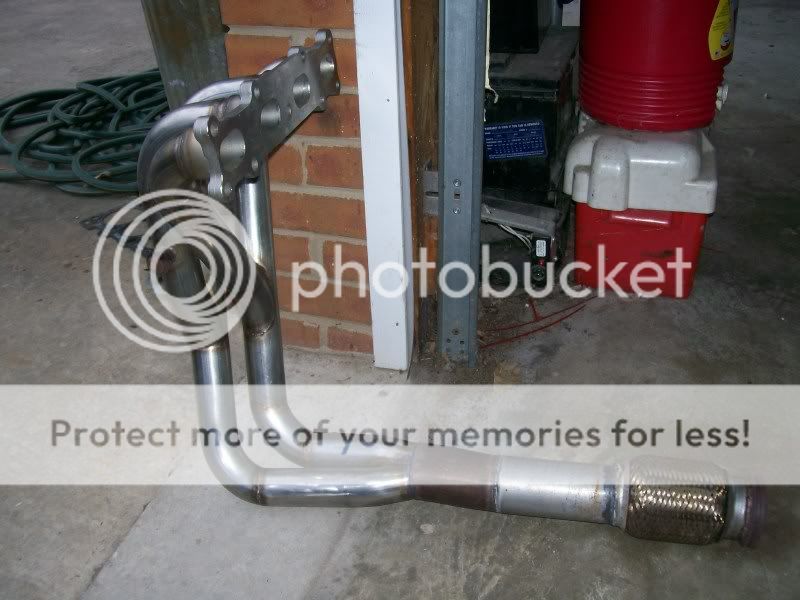

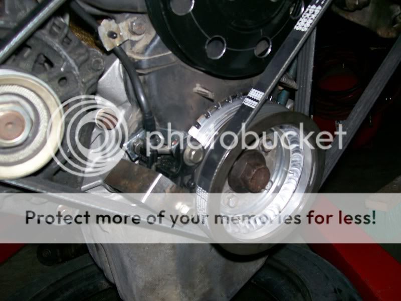

Better pictures. I had to move the crank sensor because I'm an idiot.
The header turned out great!
I call dibs on the idea of the WP pulley drilling ;).
