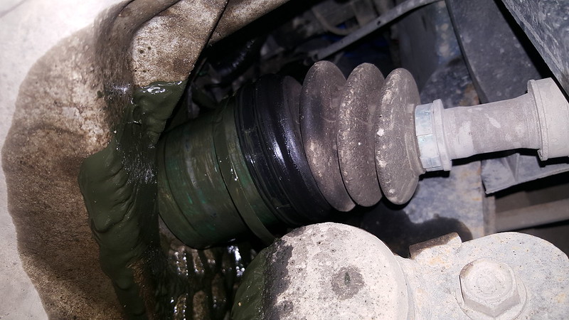

I went under the car and found this today after my 210 mile trek home..
So given that the driver axle (pictured) boot exploded, and my other one has a small hole in it, im going to just replace both. Only $60 each so why not, they are old anywho.
Going to get a new oil pan also and have the oil return bung welded to it, to make installation of the turbo easier by not having to wait on a pan. The build is postponed however until after Fathers Day, as I am getting sent down to Maxwell AFB for training at the end of May so.
So given that the driver axle (pictured) boot exploded, and my other one has a small hole in it, im going to just replace both.....
Holy Shyte Dude !;;!!?
You must have lost all your blinker fluid !!!
You need to top it up !...
Don't foget to get new gaskets...
Hmm, that isn't the brand im looking for. I need the "Imported from Japan" JDM Hi-Discharge blinker fluid. Something about the viscosity of the fluids that the JDM market uses versus ours..
