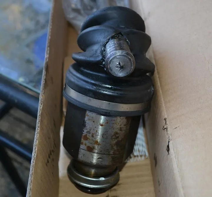

@Stealth - do you have pics of your napa axles?
here is one of the ones I've snapped
Edit: I couldn't find the other pictures but I've snapped them on the inside and over by the wheel.
