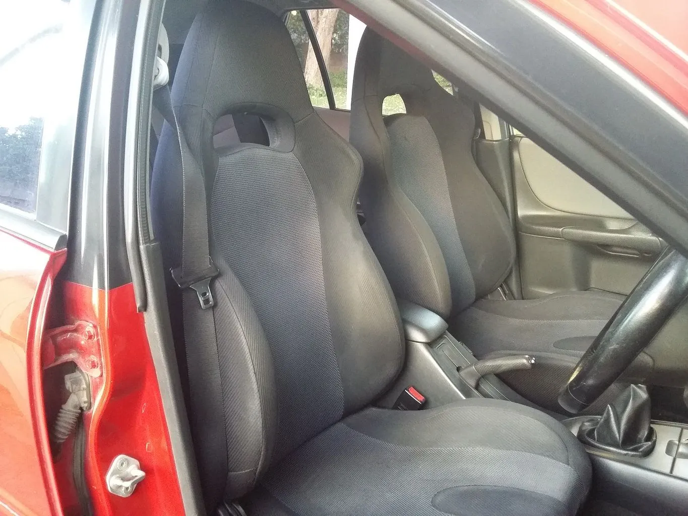

I've got 2001 WRX seats in my red car, they don't quite 'bolt up' but they do fit with a bit of swearing and modifications. The front mounting tabs need bending and the holes need drilling out. The seat belt buckle needs to be swapped over too
They're great seats and waaay more supportive than the stock seats, but they do lean in towards the center of the car, especially when viewed from the front. That being said I'm 6'2" and haven't had any back trouble with them.
In terms of WRX vs Impreza seats, I'm pretty sure Subaru seats are like lego and nearly any seat will fit in any Subaru. If the 2 part seats are a lot wider than the 1 part seats, then you might run in to a clearance issue with the B pillar and door trim.
Let me know if you want some more detailed photos or measurements for WRX seats in a P5 :)

Does your Protege5 have a sunroof? I'm such a snob and had to have one, but it means I don't have a lot of headroom to spare. Does it look like the top surface of the seat where you'd sit any higher than the stock seat (aka do you sit any higher)? I guess we have fairly different models of the same seat so it may not be comparable...
No sunroof for me :) will grab some measurements tomorrow. From memory the wrx seats are slightly lower than the stock seats but I'll compare them both (perks of having a P5 daily as well lol)
There's a decent amount of adjustment in the subaru seats too.
Quick measurements:
2001 WRX seats:
Width of base (widest point at rear of seat) = 550mm
Width of shoulder bolsters = 525mm
Height of the highest point of the base = 230mm (passenger seat with no height adjustment)
Stock Pro5 seats:
Width of base (widest point at middle of seat) = 540mm
Width of shoulder bolsters = 510mm
Height of the highest point of the base = 240mm (passengers seat with no height adjustment)
Height measured from the floor hump running between the front seat mounts straight up, widths are measured at the widest points of the seat and back
