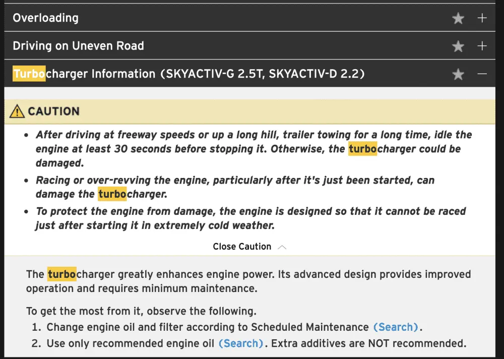

Just saw this paragraph about 2.5T turbo in owner’s manual posted by BushWickz for a different topic in another thread, it does say:
“To protect the engine from damage, the engine is designed so that it cannot be raced just after starting it in extremely cold weather.”
***snipped***
So it’s Mazda who designed this way ⋯![]()
I’d wager most turbocharged engines are designed this way so that the ECM limits boost until the oil has reached operating temperature; spinning up a cold turbo with cold oil is never a good idea. This is definitely not the issue I have experienced though. I have experienced power-loss after the engine has been running for 30min+. I still think it is related to ECM programming to limit boost based on ambient/intake air temperature and there is definitely an abrupt transition at a certain air temperature. I feel this ”protection” restricts boost too much though, especially when you’re not expecting it and need the power that you’re used to having.
Maybe today. This was not the case just a few years ago. If you owned a turbo, you were either told by the dealer to let it idle after a spirited run or not gun it cold, or you already knew how to take care of it. It was always in the manual too. My 1994 Saab manual said this exact same thing. In my day... we read manuals.I’d wager most turbocharged engines are designed this way so that the ECM limits boost until the oil has reached operating temperature; spinning up a cold turbo with cold oil is never a good idea.
I don’t know how far back you mean but my ‘05 WRX STi had this programming too, both at start up and when at operating temp. The difference is that the air temp compensation didn’t perceptibly affect the performance after the car was up to temp.Maybe today. This was not the case just a few years ago.
I agree, I don’t think people understand the importance of letting the turbo cool before just shutting off the car (and i.e. oil flow). I like to read the manual too - makes for good bathroom material.If you owned a turbo, you were either told by the dealer to let it idle after a spirited run or not gun it cold, or you already knew how to take care of it. It was always in the manual too.
There are two separate issues being discussed here. The ECM restricting boost at startup, which is fairly common for turbo vehicles, and restricting boost due to air temp, regardless of whether the car is warmed up or not. The latter is the issue that I think most people are having an issue with. I wonder if this overboost protection in cold temps is an engineering issue with Mazda’s DPT or just bad calibration/oversight. Unless there is an insurmountable engineering issue with DPT in cold air temps, I don’t think the car should be pulling so much boost (and maybe timing…haven’t confirmed) in 1st & 2nd. The power loss is drastic.My 1994 Saab manual said this exact same thing. In my day... we read manuals.
