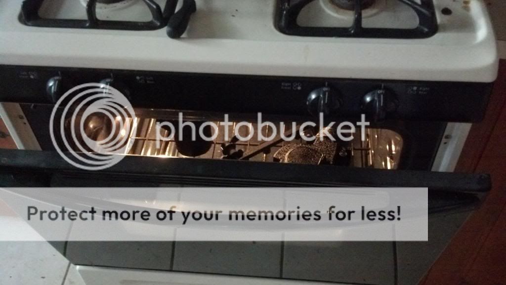

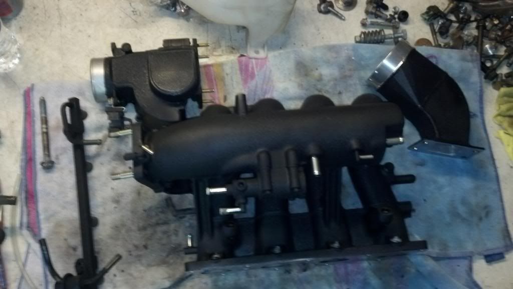

Evan came over Sunday to help me take off the intake manifold so that he can paint it for me! (HUGE thanks to him for both helping me get it off and painting it. :) )
Did a little baking last week. The recipe is 2 teaspoons of wrinkle black spray paint, 1 tablespoon of Miata parts and 3 cups of awesomeness.

Evan painted my intake manifold, fuel rail, and intake wrinkle black and it looks fantastic! We installed the intake manifold and intake last week, but yesterday I put the fuel rail back on (then took it back off, then put it back on with the fuel lines installed backwards, then took it back off again... haha).

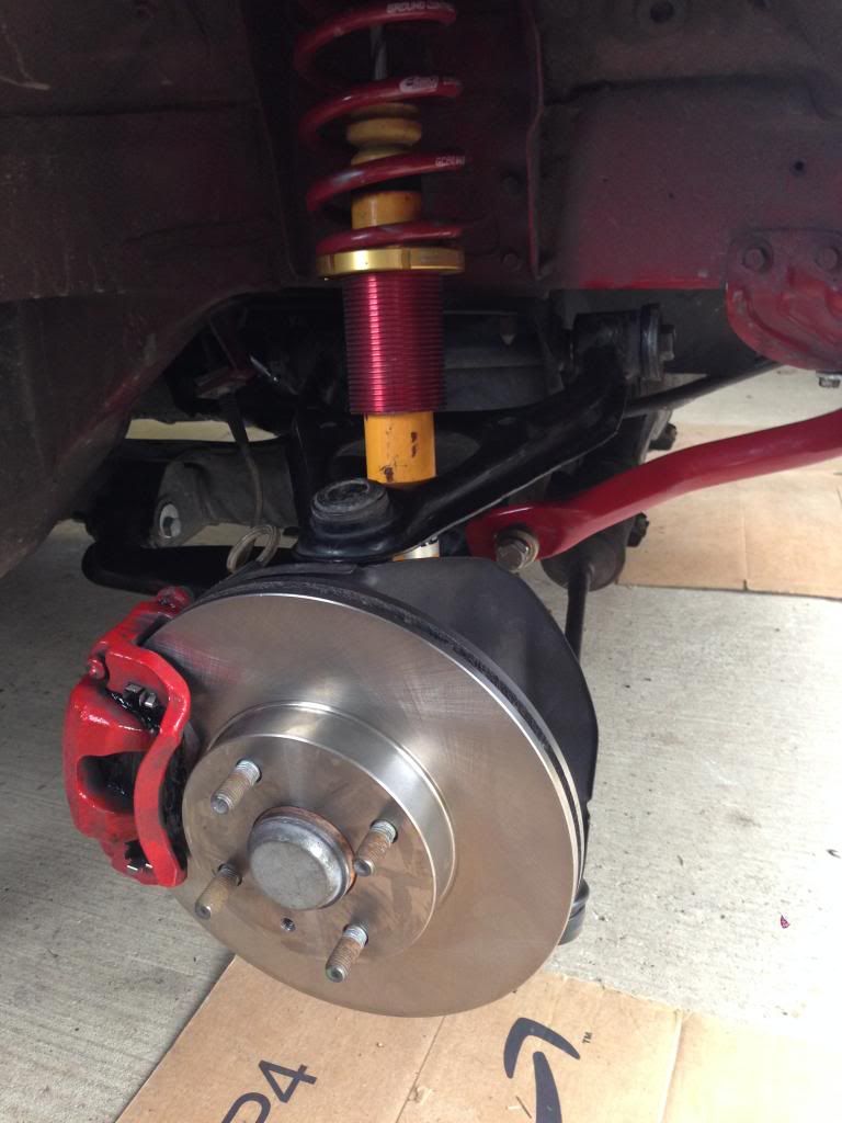

Since my Xidas are now 2 months late and no delivery date in sight, I borrowed my previous coilover setup from Pablo and got that installed along with new front rotors:
And... new 949 adjustable end links in the rear of the car.
