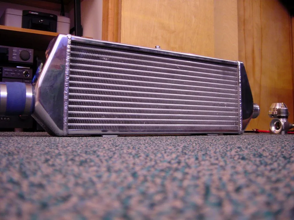

Will this intercooler fit our cars?
2Hot4TV
MSP 2003.5
I just saw this on www.apexr1.com/maprpse.html
apexr1_1794_754343
apexr1_1794_796184

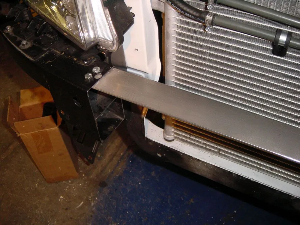

I got one that big in the front of my car, however, I no longer have the center part of the steel bumper behind the bumper skin!
The bumper was about 6 inches tall. It was cut into three pieces. Basically, I still have a bumper below the headlights... A piece of stainless steel is being used to support the top of the IC and the bottom of the IC is hooked to the rad support...
So it can be done with a little work, how are the gains?
