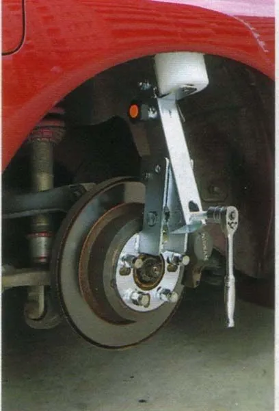

Call Discount Tire Direct, They will probably tell you that the car will have to have it's fenders rolled. Get a hold of me if you need some help with the Rolling, I'll tell you how to do it or get you a "HOW-TO" thread...

Fender roller is the attachment...

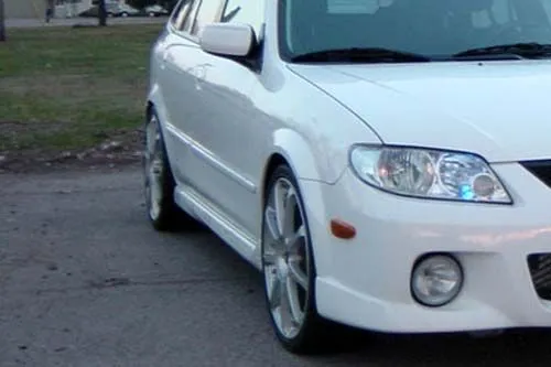

215/35/18 is the second attachment. My tires actually stick out the side of the car a bit. So your idea of wider might not work to well.

The fender rollong is not that bad, just have to be slow with it and use a heat gun to make sure the paint stays soft.
