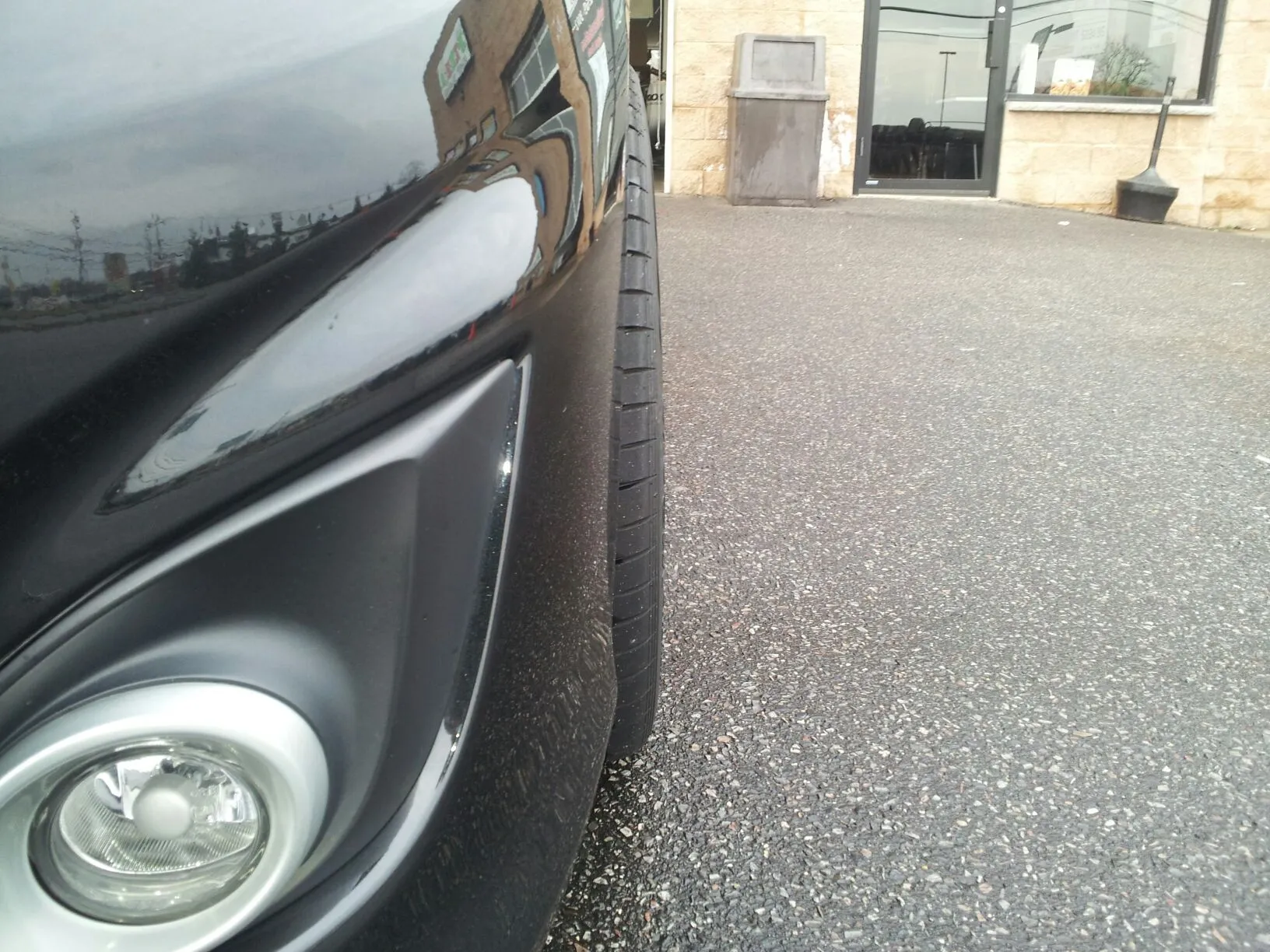

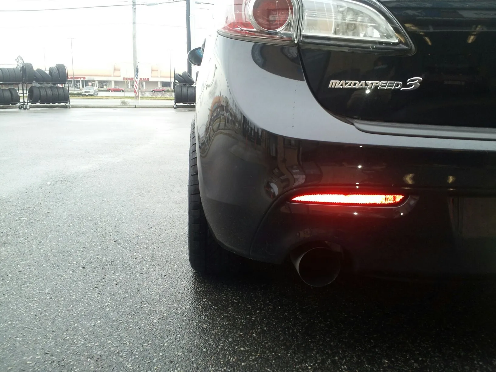

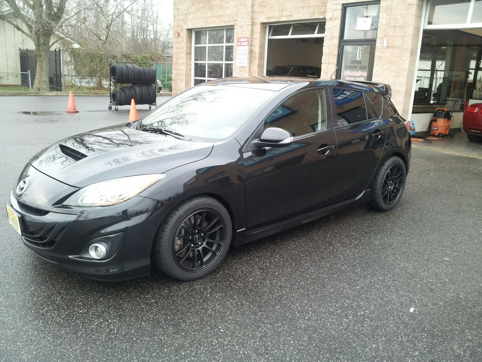

I just ordered some 17x9 with +38. 255/40r17. some other mazdas are running this. I am lowered so may have to roll. or just put 245/40r17 in rear. Will let you know wednesday when they are in.
I'd like to see pictures of this when you get them on. Thinking about running similar.
pics
no rubbing. no rolling. softer ride. much more traction
