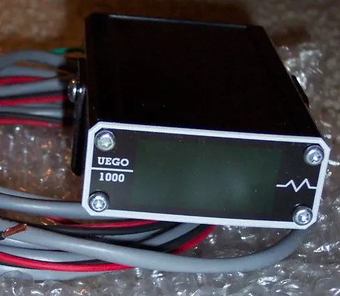

Well, no way in hell to fit 2 guages and the wide band in the pocket, DAMN!
SO I gutted the ash tray and flush mounted the wideband in there. the other 2 guages are going into the pocket :D.
