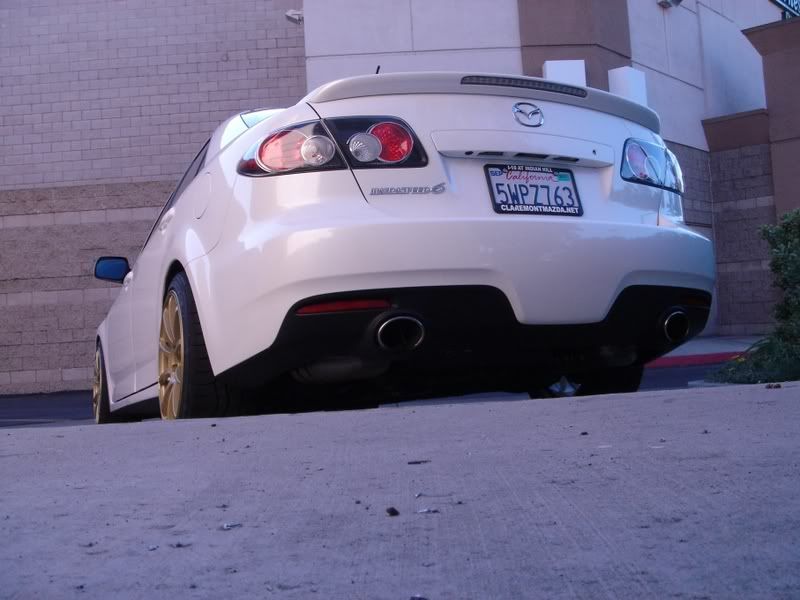

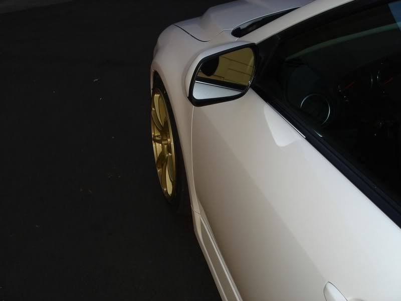

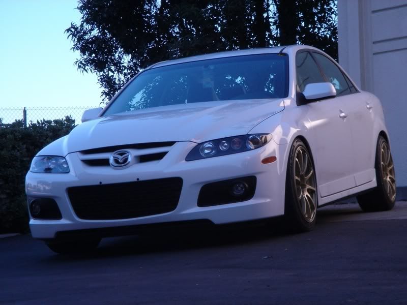

This guy did 9" wheels...
Specs:
HKS Hipermax LS+ Coilovers
ADVAN RS Gold Wheels 18x9 +45 Offset
Falken RT-615's 235/40/18
Front Fenders Rolled, Rear Fender Lip Shaved - No Rubbing

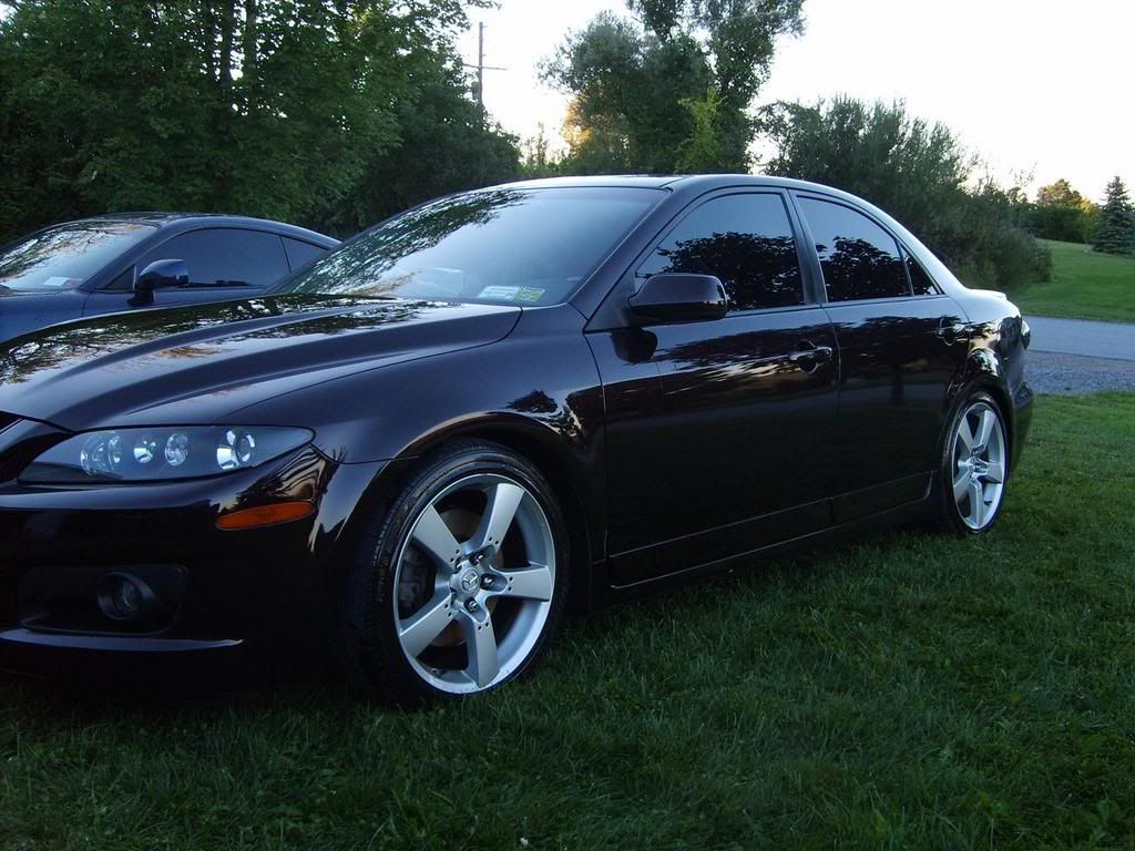

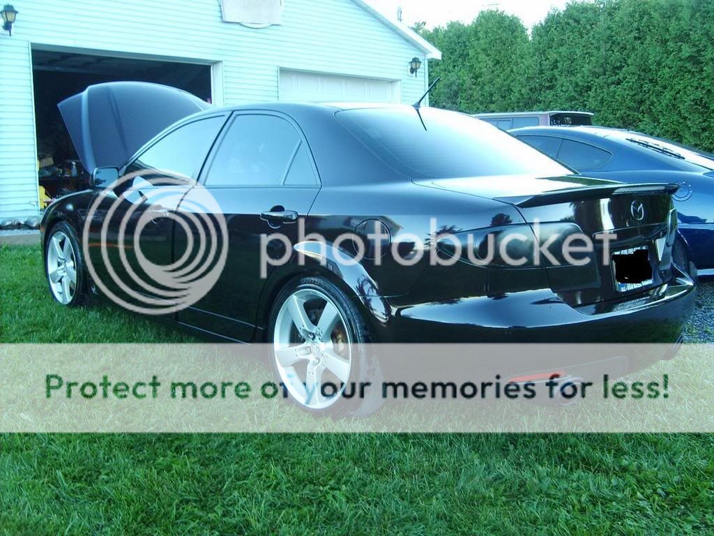

This is not true, RX8 wheels are 18x8 with offset +50 and 235x40x18 fit just fine...My MS3 has these with no issues. BTW, I kept these wheels out of my RIP RX8 so I know these wheels very well.
Carlos

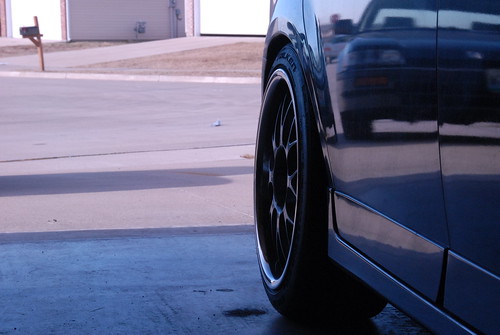

Currently running 18x8.5, +35 I've had 225's, 235's, and 245's all on the same wheels...with the sus as low as it is, I am back to 235's. Rolled front and back.
