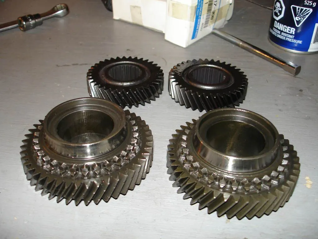

Pic 1: Stock 3rd Primary on left, GTX 3rd primary on right.

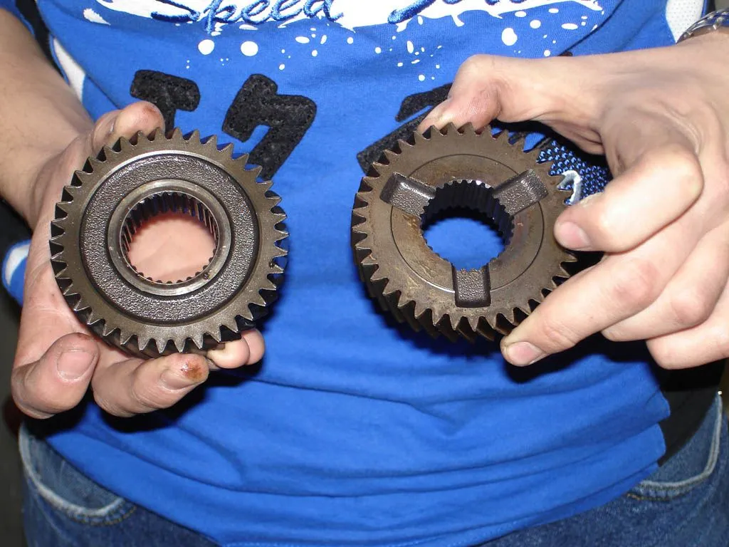

Pic 2: Stock 5th secondary on left, GTX 5th secondary on right.

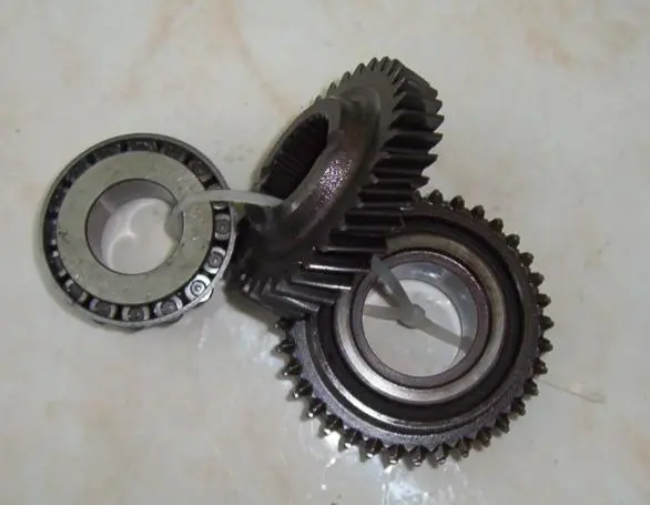

Pic 3: Stock 5th Primary on left, GTX 5th Primary on right

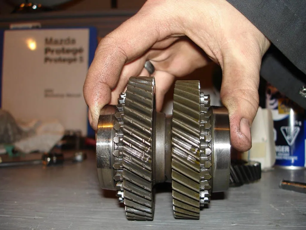

Pic 4: Stock 5th left, GTX 5th gearset right.

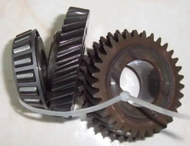

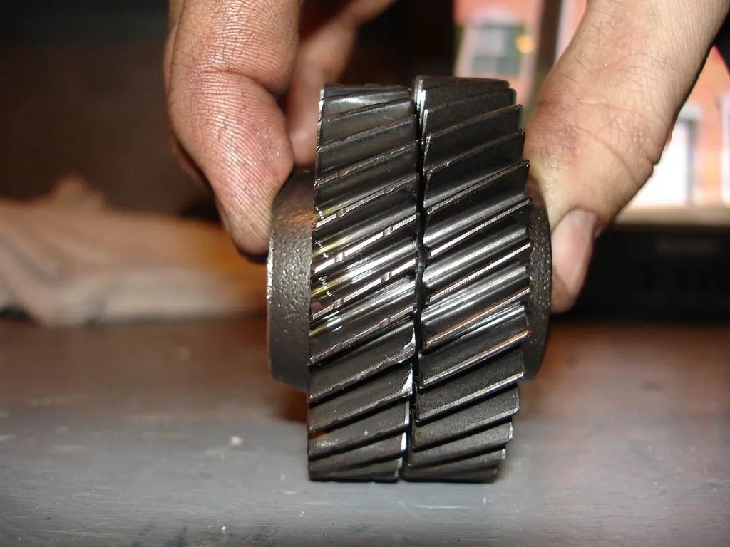

This is 4th gear if I remember correctly
