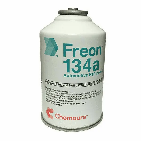

Ooh. Yeah. Um, I'm going to have to go ahead and sort of disagree with you there. Freon is simply a brand name of R134a. And it most certainly is not banned. What you're thinking of is the older R12. That is indeed banned.
Ya, it is often thought that from even shops!! They call it all "freon" ?

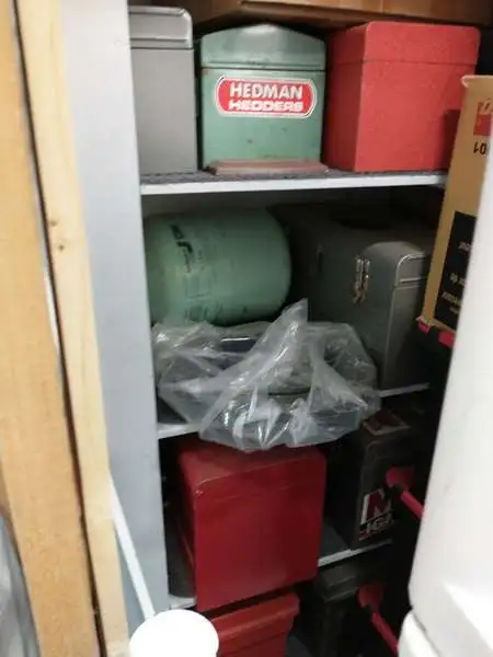

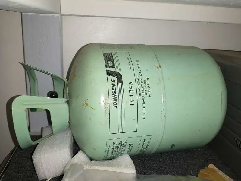

My personal 30lb Johnsen................... R134 :LOL:
