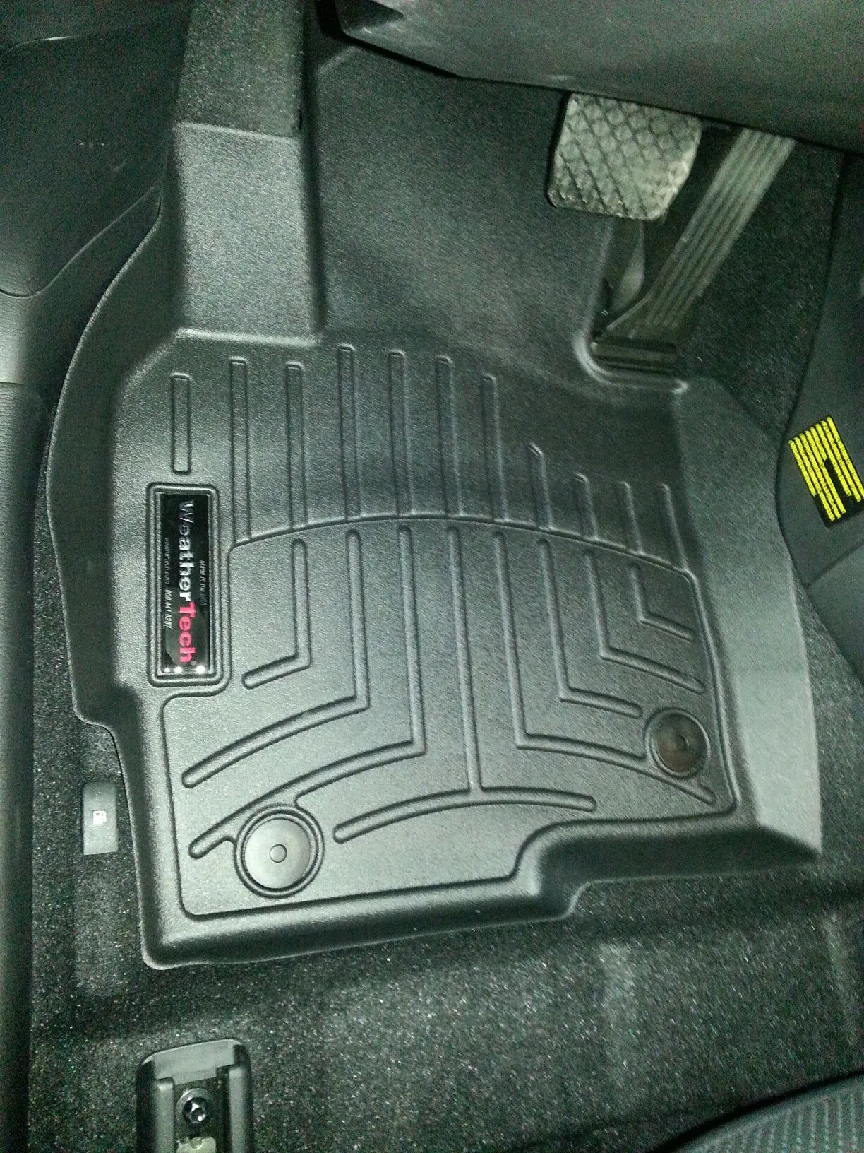

My Weathertec matts took care of this problem.
See attachment.
