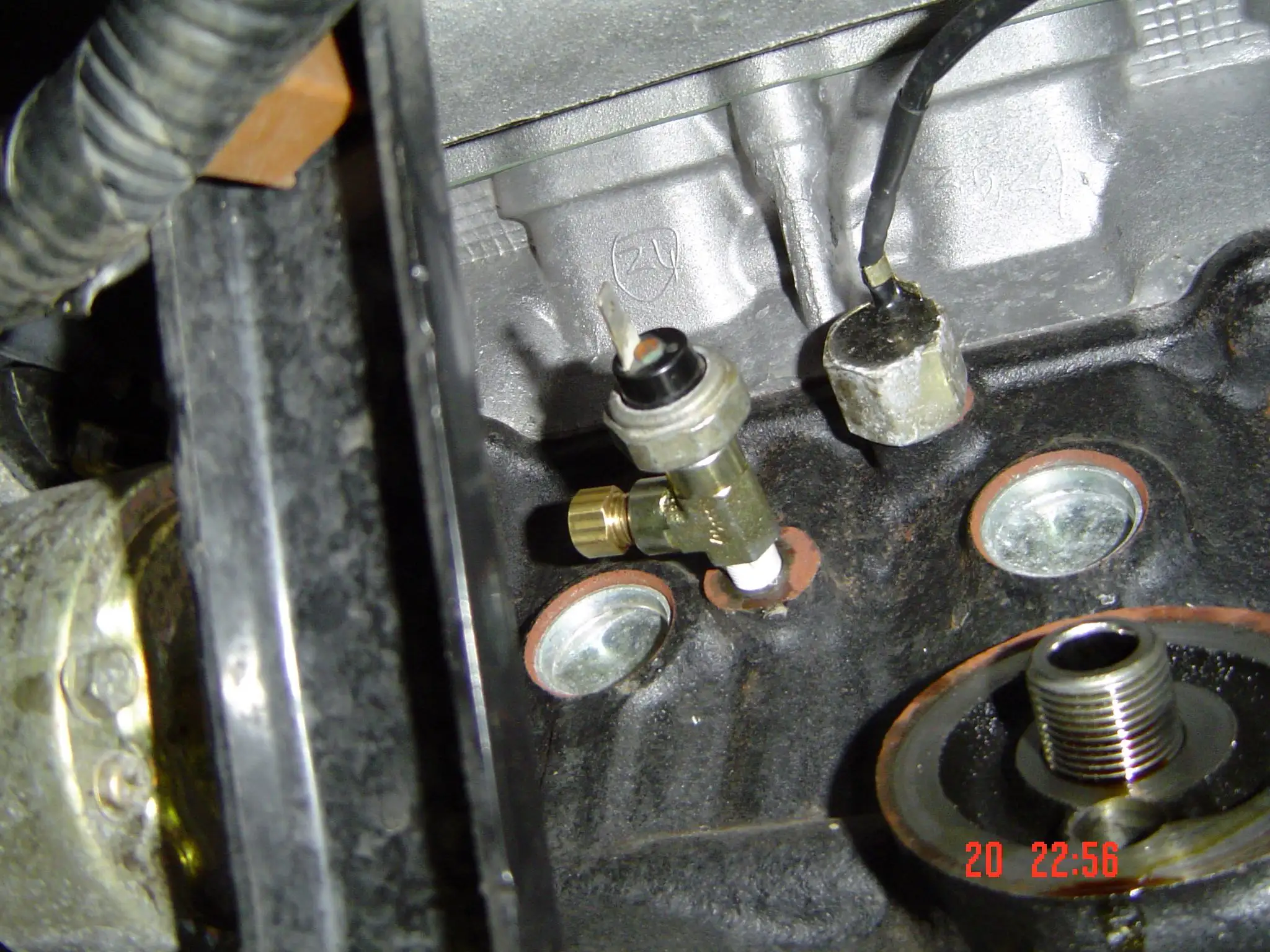

Installing the Highboost kit & the instruction manual isn't all that clear. It just says bolt up the oil feed line & oil return line. No pictures no nothing. Can someone help me out? Thanx in advance
The feed line gets hooked up from the back of the block above the filter where the stock sender is, and goes to the top of the turbo. The return goes from the underside of the turbo to the oil pan. Here's a pic of where the feed comes from, it's the Tee on the left.

Midnightracr,
It is clear on page 2 of the install instructions just as Bigg tim says.
Pm me if you have any questions.
