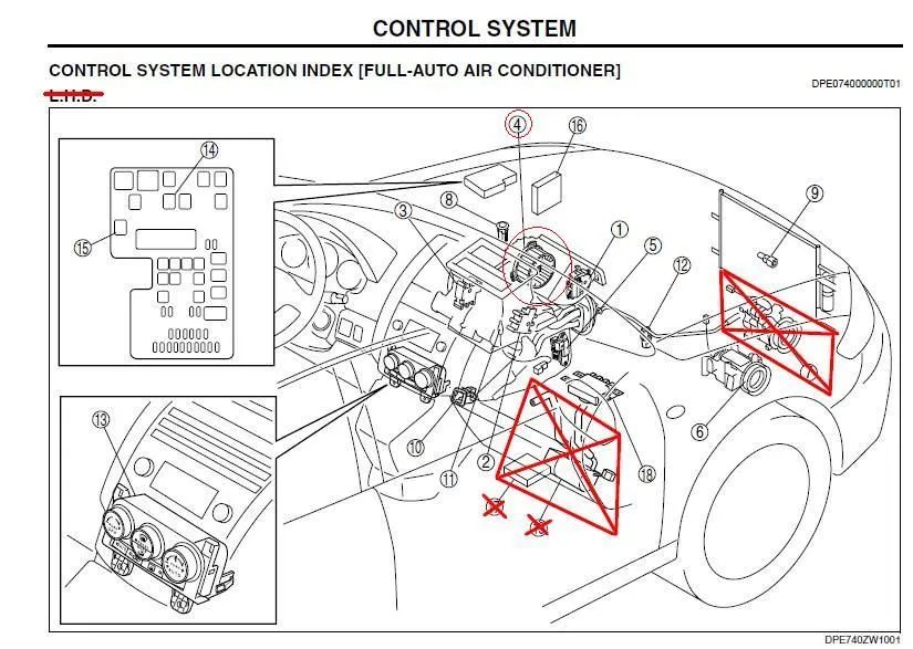

Long story short - I apparently had a mouse living in my cabin filter compartment who chewed a hole through the cabin filter. Some debris from the mouse's nest blew into the blower motor jamming it.
All I knew was that my blower motor had stopped and that my Mazda5 was under warranty. Damage from mice are not covered by the warranty, I'm on the hook for 3.5 hours of labor plus $32.50 for a new cabin filter: $347.50 total.
Anyway, where is the front blower motor so that if something goes wrong in the future I can get to it / fix it myself? There's no way I'm taking it back at those rates.
Then there's the matter of book rates - I dropped off the Mazda5 at 8:15 am. At 10:15 I was called and told what the problem was. I'm assuming that they had cleaned everything out by that point to make sure it was functioning correctly - but I'm being charged for 3.5 hours of labor. Grrrrr....
OK, found it (it's part #4 on the attached diagram).
The next question is how do I get to it, if I have to get to it in the future? Do I have to remove the radio / center dash then go straight back?
And I'm still upset about the number of hours - there is no way that this is a 3.5 hour job.
Edit: I talked with the service representative, he said that the bulk of the 3.5 hours was for taking the duct work out to get debris out and that the pollen filter (cabin filter) was a 15 minute job.

Sounds like you had a similar experience as myself. Here's what I went through to clean my blower wheel - http://www.mazdas247.com/forum/show...AC-blower-wheel-(squirrel-cage)&daysprune=365
As for replacing the motor, it's at the top of the dash above the gas pedal and I believe the majority of the dash has to come out to get it, but I haven't looked up there to see if it can be reached from below. I've pulled a dash to replace a heater core in a Chevy before, and if you're mechanically inclined, it's not as difficult as it sounds. Most everything is plug-and-play and made for easy assembly-line installation, so I couldn't imagine this vehicle being that bad...?

I have a similar experience as of two weeks ago. My wife's front blower stopped working and I tore in to the dash to see why. I found that the blower motor was full of what appeared to be kleenex or a similar paper material. My father said he thought a mouse as well, but I don't believe it. My wife keeps her glove compartment shoved so full of crap, that I think something got sucked into the motor while she had the AC set to recirculate the air in the car. I could be wrong, but I dont' believe that I had a mouse living in my car and the only sign of it is a shredded filter/kleenex. I haven't taken the car into the dealer yet, but I'm hoping my friend that works there as the service manager can help us out a little bit. I seriously doubt that the warranty covers any of the expense.
Any chance you had a similar thing happen and it wasn't a mouse?? Not that a mouse wouldn't be happy in my wife's car, the kids do keep it full of crumbs from all sorts of treats...hmmmm. Maybe it was a mouse, but I just don't buy it!

You have to remove the brake pedal and the gas pedal to get at the blower motor in Mazda 5, assume 3 is the same. It does look like the radio section comes out to do it but apparently not.
