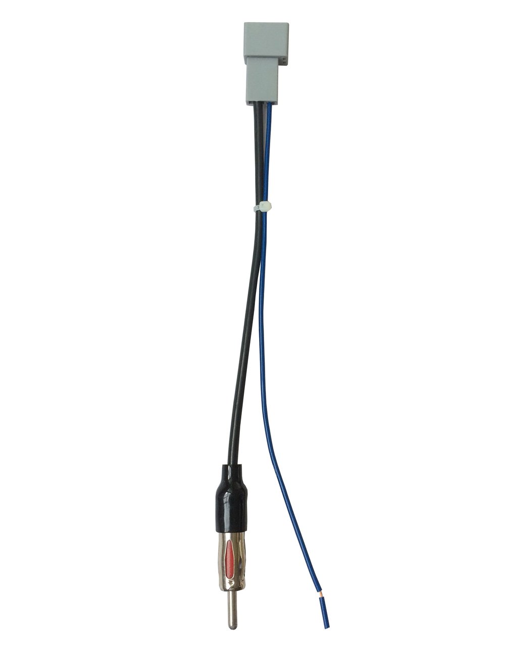

Where does the blue wire in the aftermarket antenna adapter connect to..?
So I just installed a aftermarket CarPlay stereo.
2 things currently dont work
the steering controls which i dont care about thanks to the HEY SIRI capability
and the AM/FM channels
i think the reason for the AM/FM issue is that i wired the blue wire on the after market antenna hookup incorrectly
this is the one i bought https://www.amazon.com (commissions earned)
does anyone know where the blue wire is supposed to be hooked up to (i wired it manually wire to wire using a wiring diagram)
From someone one Mazda 6:
The mysterious blue wire should go to a 12-volt source that is only active in the accessory or run key positions.
It supplies power to the RF amp module for the antenna wires, I just wired it to the red ignition wire behind the radio.
Not sure same one the 5.
thanks , that makes sense
