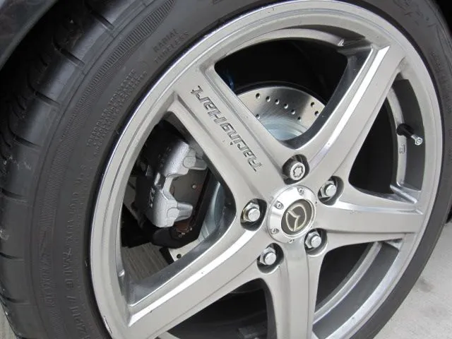

I like these wheels, just waiting till spring. I used a roll over speed car, and got all the stuff to work on the P5..:)(p5blue)
