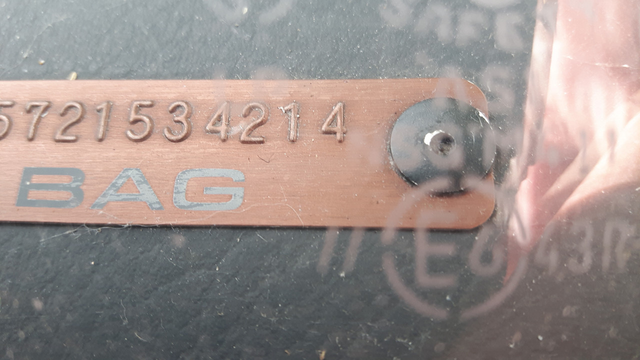

I did a bit of research and discovered what's happening. Halfway through 2002 production, Mazda made some mechanical and exterior changes to the Protege5. One of them was changing to a different throttle body and an EGR to fit it.
It is likely that the part number Fsy1-20-300 fits the earlier 2000 version. That VIN runs up to the last five digits ending in 593887. From 593888 and on its the 2002.5 version.
I'm really surprised there wasn't a TSB about this change. Now i just have to get parts sellers to acknowledge the difference.
