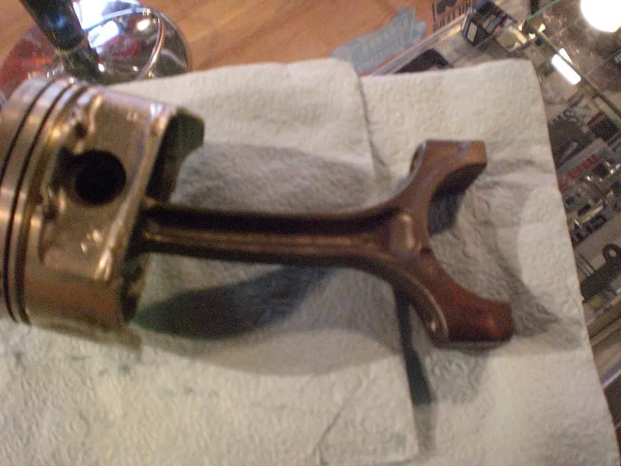

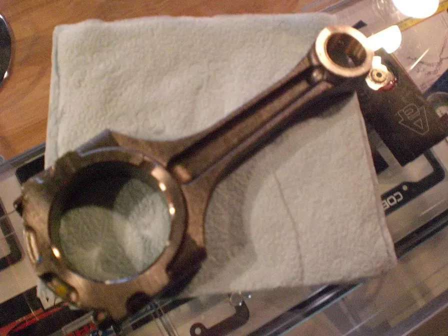

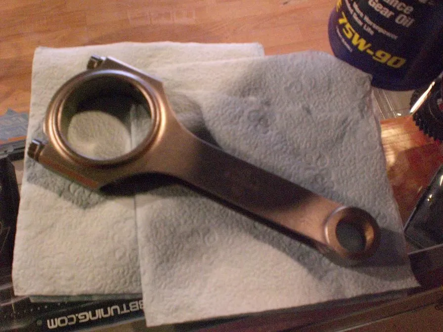

the rods are cast, the pistons are cast, the crankshaft is forged. same as every piston mazda engine before it, sorry guys. see the attached pictures below. if people want pictures of the pistons as well i have those.
left - factory cast iron mazdaspeed DISI rod
middle - eagle forged rod for 2.3
right - factory cast iron mazda protege rod :) bent :)

the rods are not forged steel, i am sorry. the article is incorrect. we have disassembled three of these engines. all of them have had cast rods, with casting marks in them. they are definetely an iron rod as well. the bore for the crankshaft and wrist pin are machined, but the rods are cast. forged rods are made through a pressurization process that does leave the type of surface shape or texture that a cast rod does.
article is correct, they are forged. Not all forged rods look like what you show in your post, common misconception. Forged rods can look like cast rods as well, that doesn't automatically make them cast...
The article is most definitely correct...its from Mazda's corporate website. I think they know better than anyone exactly how their engine is manufactured. Plus the engine is a four popper making 280 ft lbs of torque! If you want a four cylinder to have any sort of long term life expectancy with that kind of power you need to make one hell of a strong engine which is why mazda's 2.3 disi mzr and even the new caliber srt-4 have forged parts that make up the engine.
